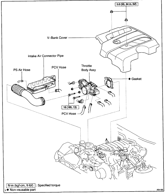

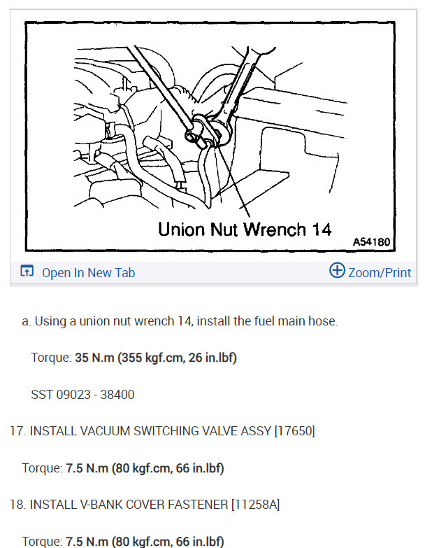

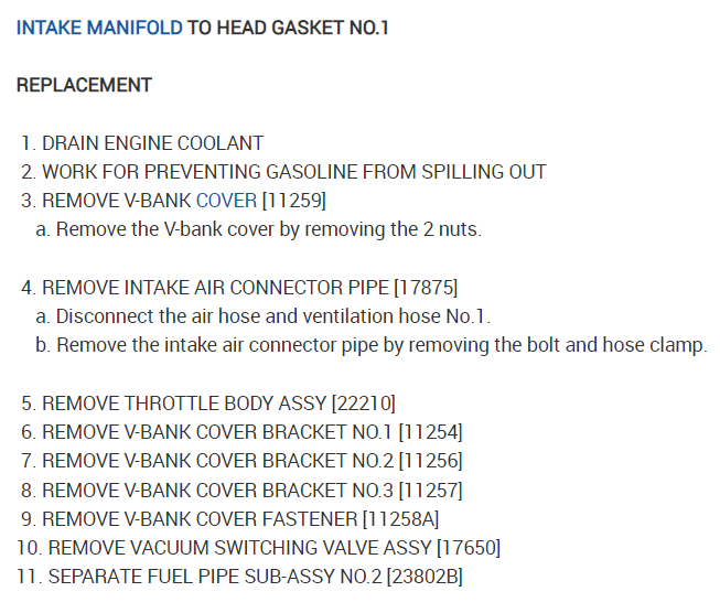

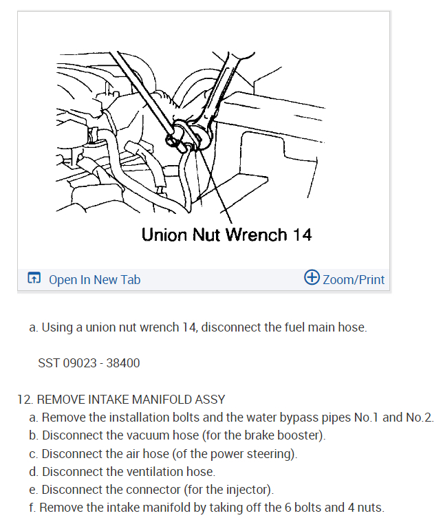

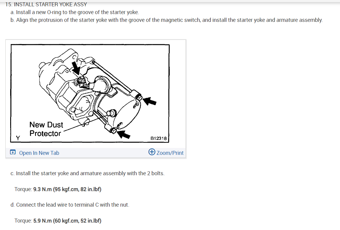

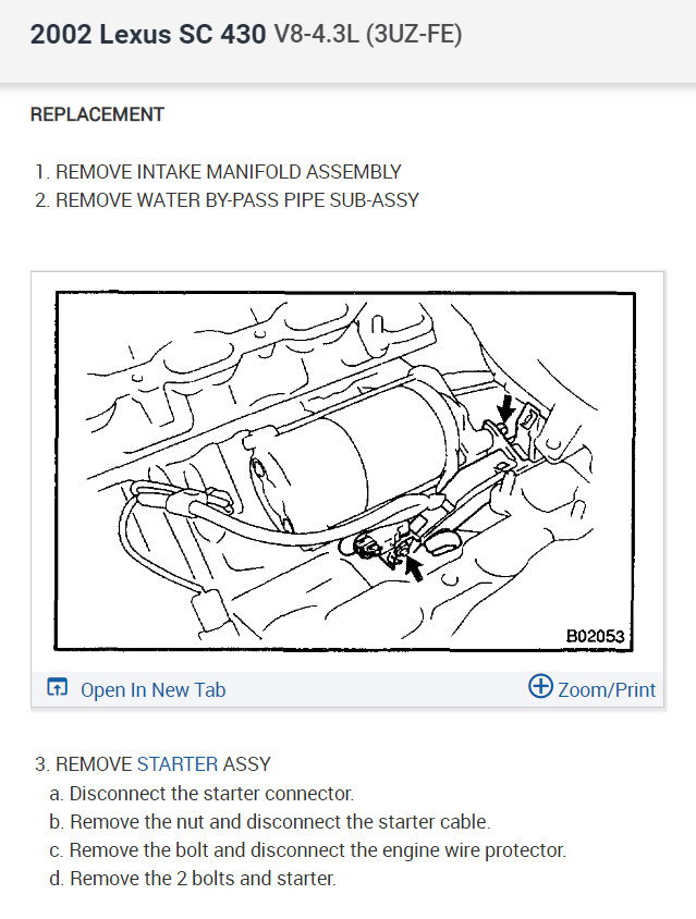

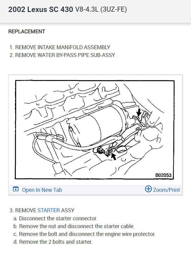

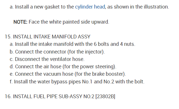

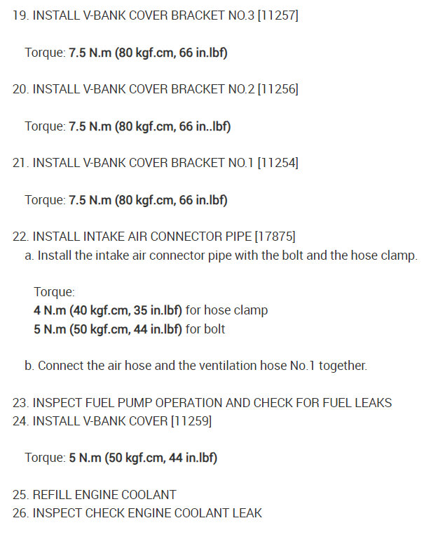

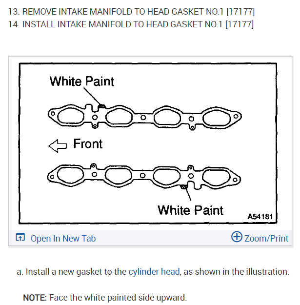

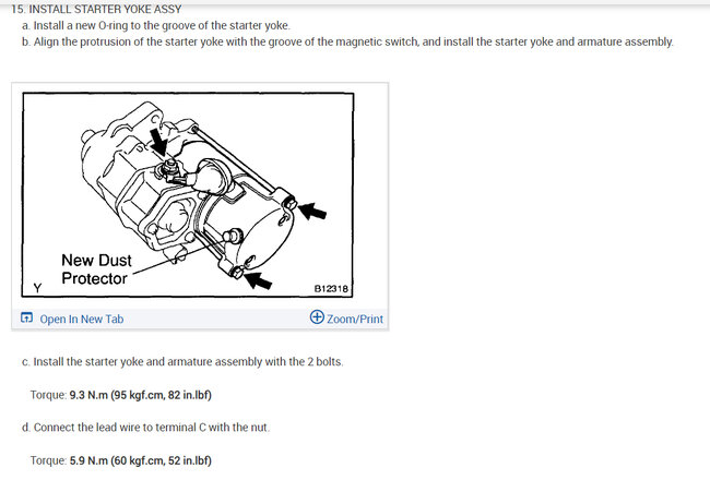

This sounds like you got a defective starter, can I ask which brand you bought? Here is the correct way to install the starter motor. You need to remove the intake manifold. Also make sure the battery connection is clean and tight.
This guide can help:
This guide can help as well:
https://www.2carpros.com/articles/starter-not-working-repair

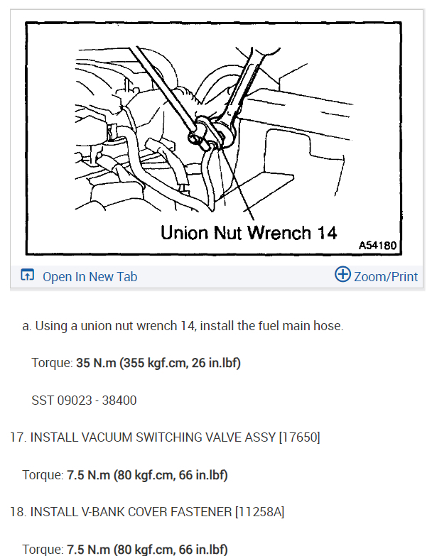

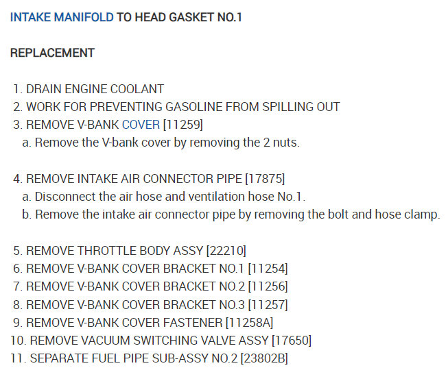

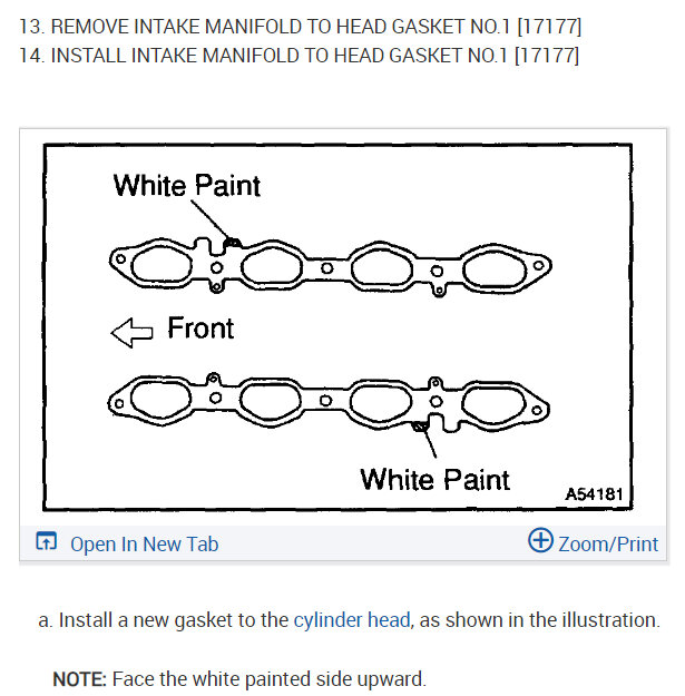

Here is how to remove and install the intake manifold. Check out the images (below). Let us know what you find.

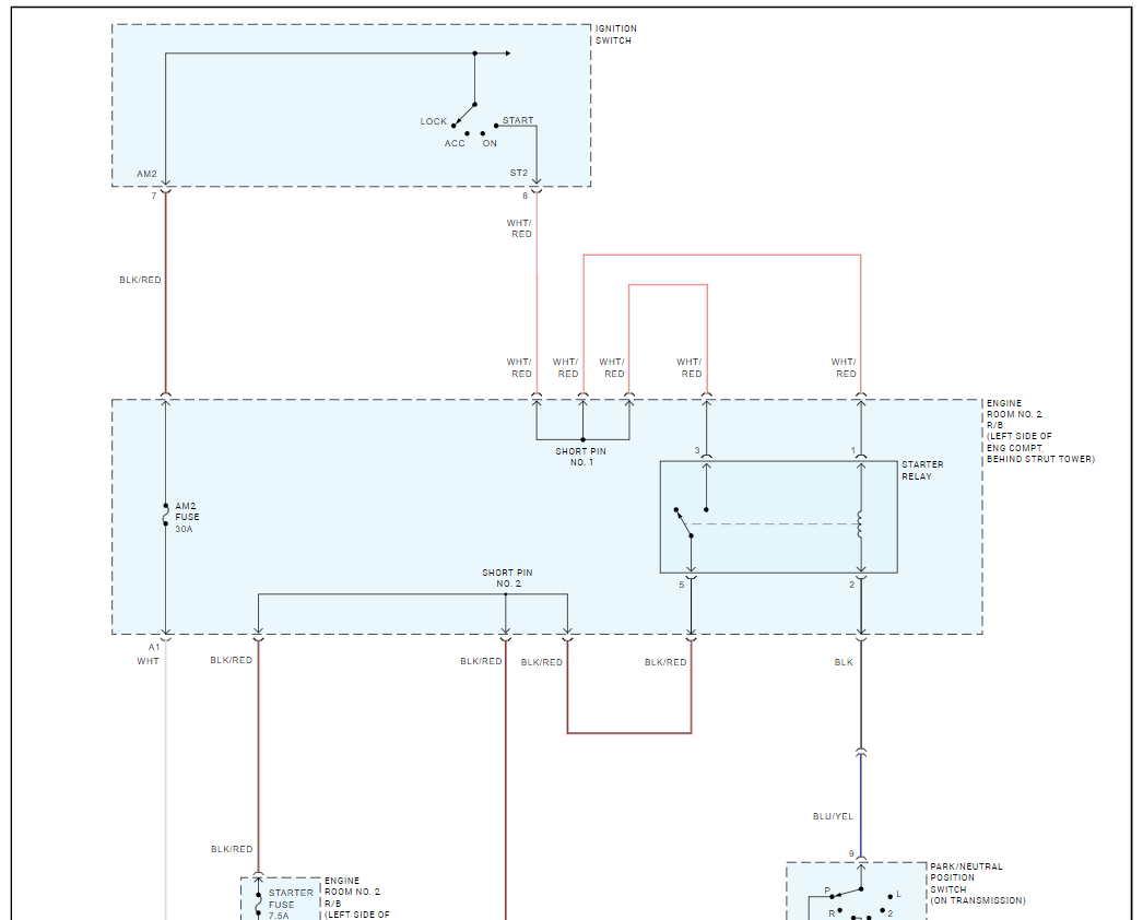

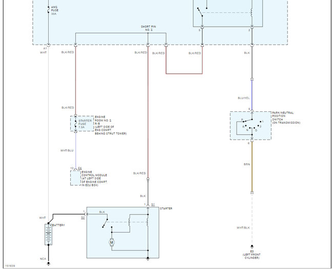

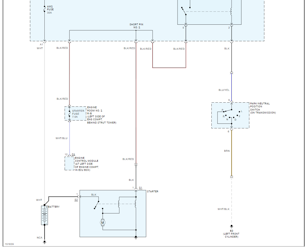

Please upload a short video in your response to the problem so we can see what's going on. Here is the starter system wiring diagrams so you can see how the system works. Please check out the fuses in the diagrams. Check out the images (below). Please let us know what happens.
