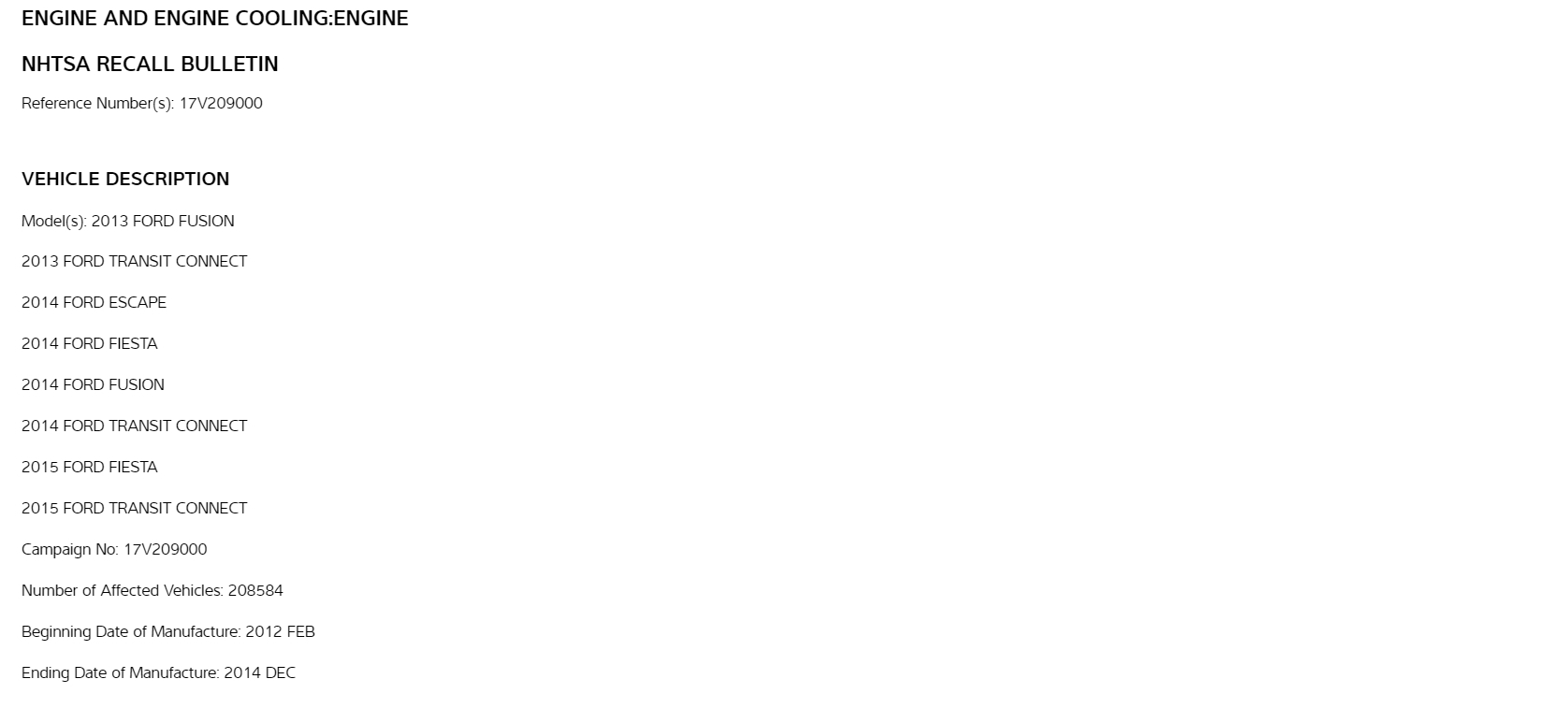

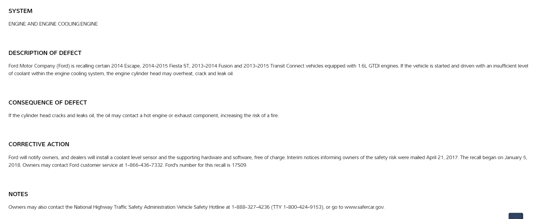

Hello, do you have any idea where the smoke was coming from? Did the van overheat at any point? The smoke in the engine compartment is a concern. It may have something to do with why it shut down. Without more information, it's hard to tell what caused it. There are many possibilities. There is a recall on this engine for overheating concern due to a cracked cylinder head and it leaks engine oil onto the exhaust. This would definitely cause a lot of smoke under the hood. As well as a risk of fire.
Here is the recall information below about the cracked cylinder head and oil leak.
