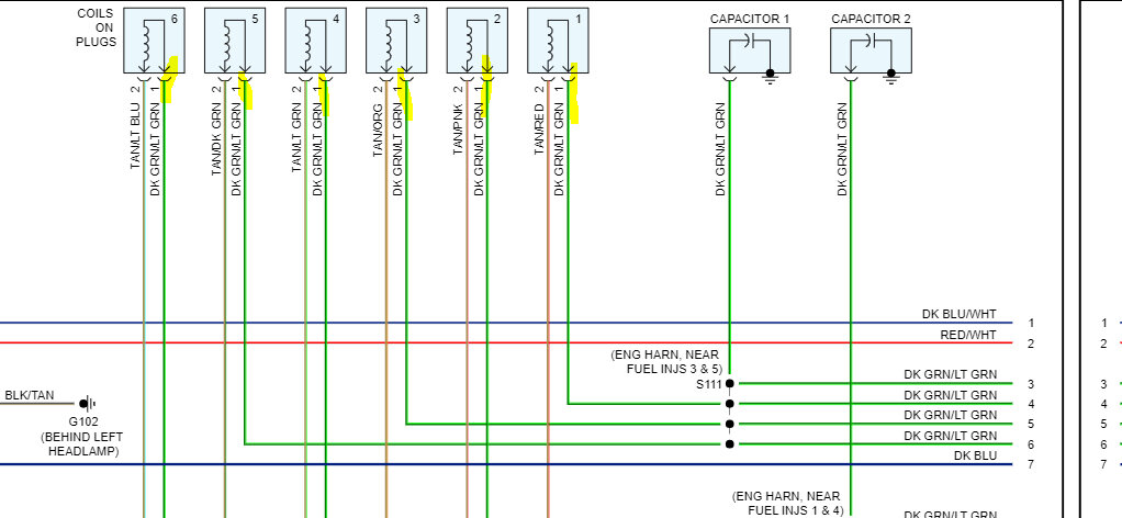

Also, I need you to check for power to the ignition coils. If you look at the connectors, you'll notice that each coil will have a dark green wire with a light green tracer. (see pic below) That is the power supply to each coil. With the key on, that should have power. I need you to check to make sure there is power present.
See pic below.
