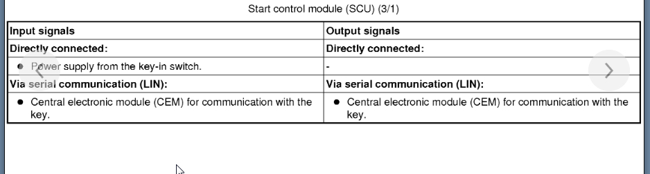

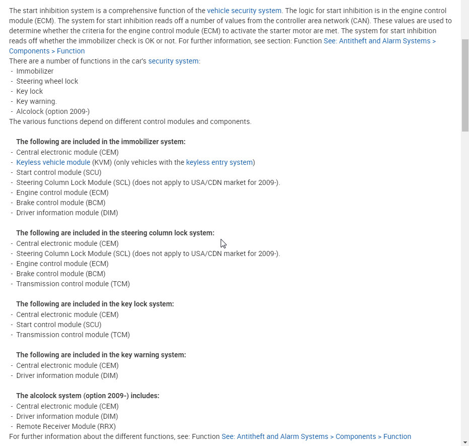

Is the security light on?
Your engine control module has a disable feature that will get enabled when conditions are met.
Attached are the parameters. Let me know if the light is on. If not, we will need to check for voltage at the starter when the engine is not starting.
https://www.2carpros.com/articles/how-to-reset-a-security-system
Let me know and we can go from there. Thanks
