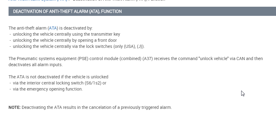

I am thinking we have a security issue so I attached the way to deactivate the system. Let's run through this and go from there.
However, if it is not an alarm issue then we are a no start which is most likely fuel or spark as we can assume compression wasn't effected with what you did.

Thank you for the reply. I'm on my way home right now to see if the ATA works first. But just to make sure "I need to deactivate it by unlocking the car with the hard key on the driver side door then try and start it from there?" That's it? Checking spark is easy and fuel gauge for pressure on the rail.
Jul 15, 2020 at 9:55 PM
Correct. It appears the first one is to unlock it using the transmitter key so that should do the trick.
