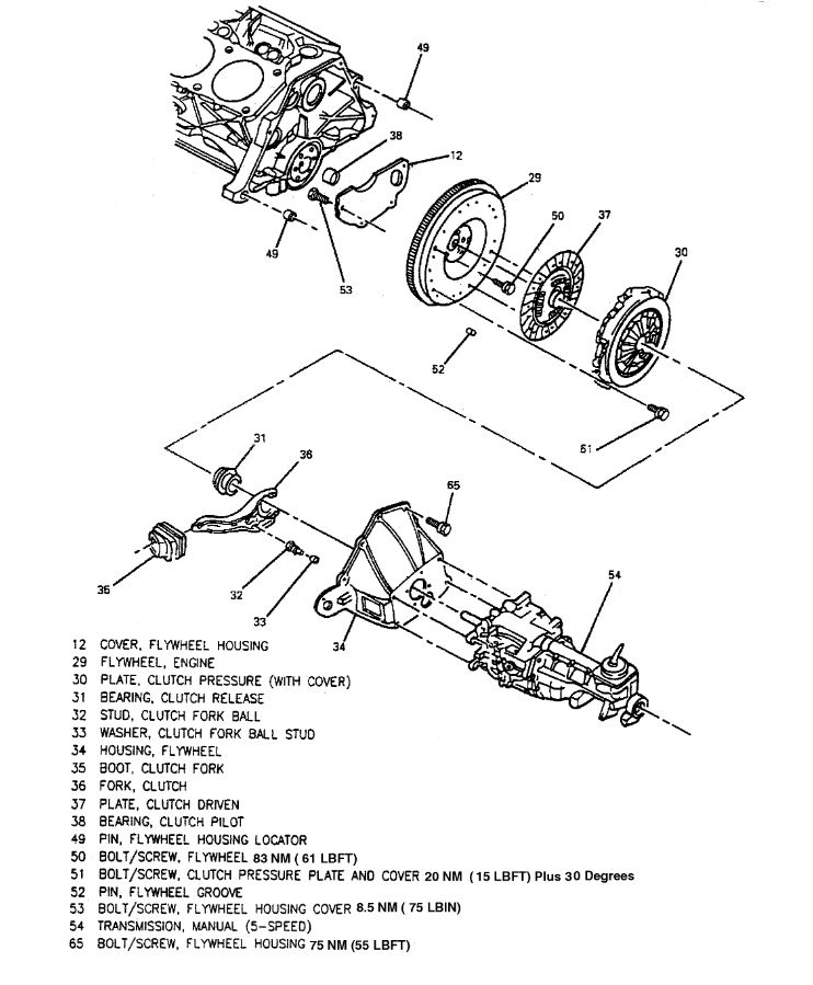

Okay, that sounds like the clutch is slipping or not releasing fully. The first thing I would do is check that the throw out lever is moving when the pedal is stepped on and released. That is the arm that sticks out of the bellhousing. If it is moving okay then I would move right to clutch replacement as it won't matter much if the issue is the clutch or internal to the transmission as either way the transmission needs to come out. That one isn't all that hard to do but you need to get the car up in the air to get room enough to work under it. This explains the basic process. For yours you need to unbolt the torque brace and go inside the car to deal with the shifter as it is attached to the transmission. For that you remove the trim panel around the console and get to the shifter bolts. Then remove them from underneath.
https://www.2carpros.com/articles/how-to-replace-a-clutch
