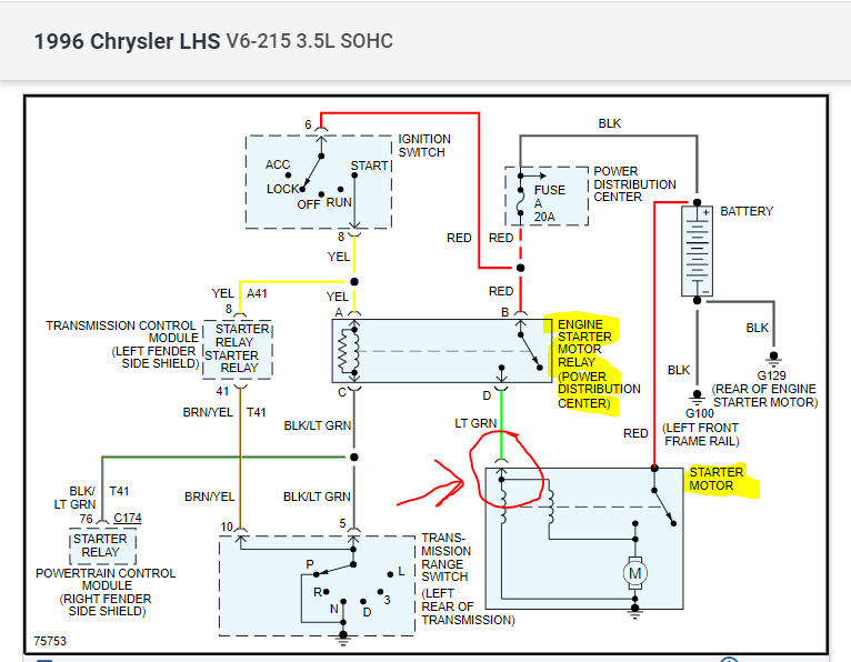

I attached the wiring schematic below for the starter circuit. On the starter itself, there will be a smaller gauge light green wire. That is the trigger wire. It has no power until the key is in the start position. Have a helper turn the key to the start position while you check if that wire gets voltage. If it doesn't, see try starting it in neutral. If it does get power, suspect the starter has failed.

Let me know if I understood what is happening correctly.
See pic below.
