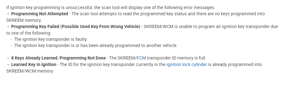

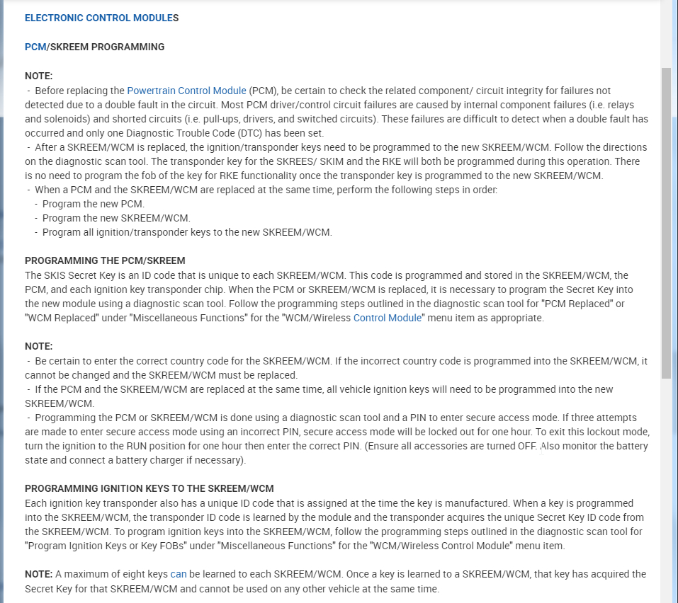

If that is the case, did you perform the PCM replacement procedure with the scan tool? In other words you need to program the tool and transfer what is called the secret key info so that the PCM recognizes the key and starts the vehicle.
Was this a new PCM or used? Let me know this info and we can go from there. Thanks
