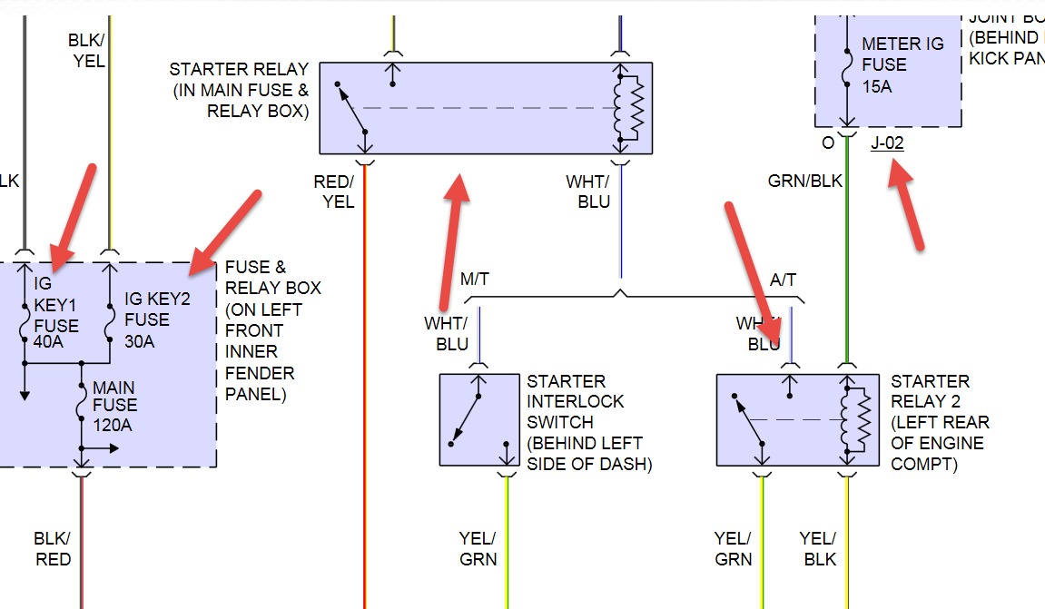

Hi, wI tried to start my car this morning and the engine wouldn't turnover. I know my battery is going bad and its been cranking slow, but put a charger on it for few hours and tried to crank. All the lights came on, but not even a click or anything when trying to start. I hooked up cables and tried again. Same thing, could it be a fuse or relay, or any other ideas. It is also a manual. Is there a clutch sensor or something like that.
Nov 14, 2017 at 11:39 AM (Merged)
HMAC300
  • 48,601 POSTS
cutch has to be depressed to start. check battery for condition including load test. check items in pic
