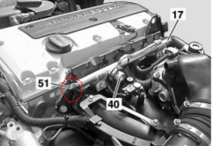

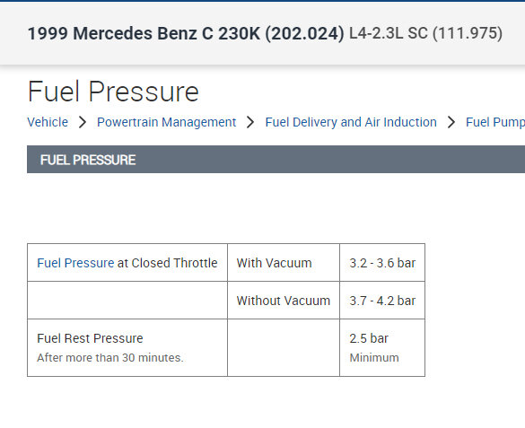

If you look at pic 1 below, I circled where the fuel pressure gauge will attach. Pic 2 shows the manufacturer's fuel pressure specifications.
Let me know if you are comfortable performing this procedure or if you have other questions.
