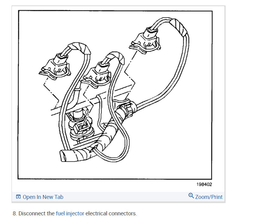

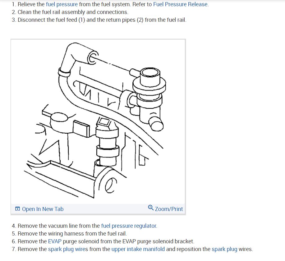

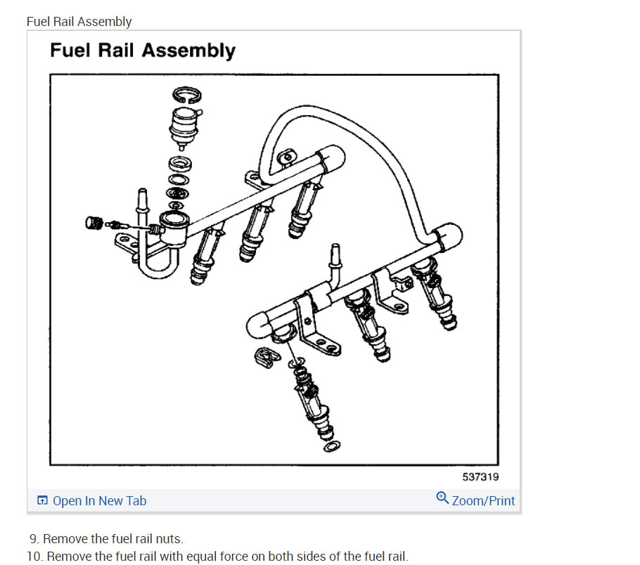

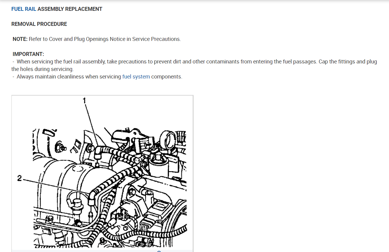

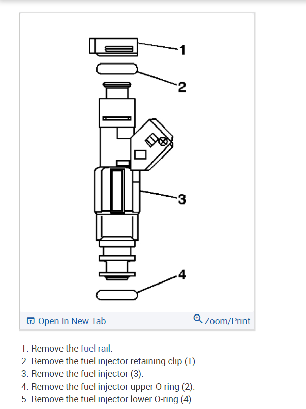

This could be from injectors not seating after the ECM commands them to stop flowing fuel. The fuel rail has to be removed in order to replace the injectors.
https://www.2carpros.com/articles/how-to-replace-a-fuel-injector

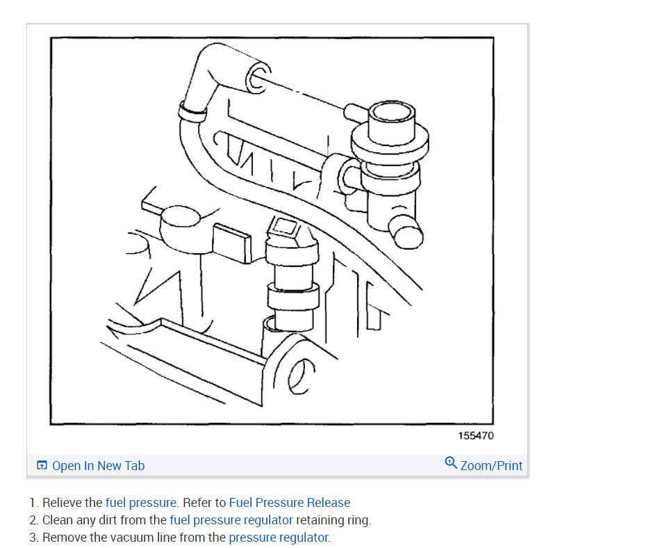

It also could be from a bad fuel pressure regulator as there is a vacuum line on it that could draw raw fuel into the intake system. I attached a picture for you of the location. To be sure the regulator is the issue, remove the vacuum line and see if there is fuel in the line with the key in the on position. If there is fuel in the line, then it is bad.
