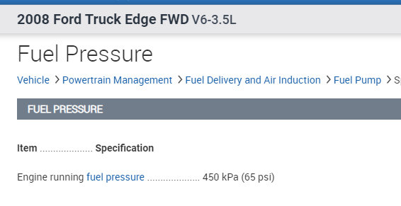

My first thought is you have a weak fuel pump. If you haven't checked pressure, that is where I would start.
Here is a link that explains in general how it's done:
Additionally, I attached the manufacturer's fuel pressure specifications below. Try this and let me know what is found. Also, if you have other questions, let me know that as well.
See pic below.

That was a secondary concern as I thought more about it. I know that my girl (it's her car) will run the tank to almost empty and only put the minimal amount of fuel in to get her to and from work. I have advised her against this many times telling her that she will burn up the fuel pump if she continues to do that. But to answer your question, no I have not checked the pressure. The car has been towed from the transmission shop to another general mechanic's shop for the time being. I am currently working with minimal tools and live in a very rural area.
Aug 31, 2022 at 8:16 AM
After hearing that, I have a feeling that it is the likely cause. If you have a chance, let me know what is found. I'm interested in knowing.
