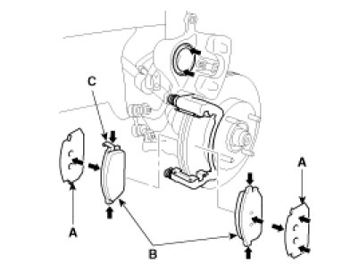

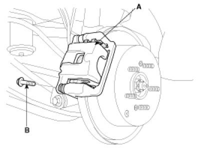

1. Raise the rear of the vehicle and make sure it is securely supported. Remove the rear wheel.
2. Remove the guide rod bolt(B), After raising the caliper assembly(A), support it with a wire.

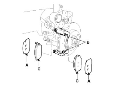

3. Remove pad shim(A), pad retainer(B) and pad assembly(C) in the caliper bracket.
Installation

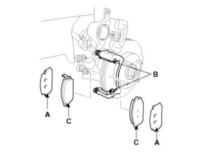

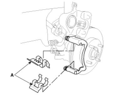

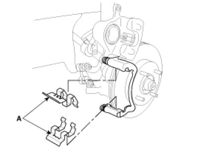

1. Install the pad retainers(A) on the caliper bracket.
2. Check for foreign material between the pad shim (A) and the back of the pads (B).
3. Contaminated brake discs or pads reduce stopping ability. Keep grease off the discs and pads.
4. Install the brake pads (B) and pad shims (A) correctly. Install the pad with the wear indicator (C) on the inside.
If you are reusing the pads, always reinstall the brake pads in their original position to prevent a momentary loss of braking efficiency.

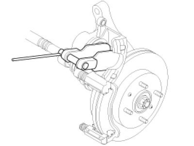

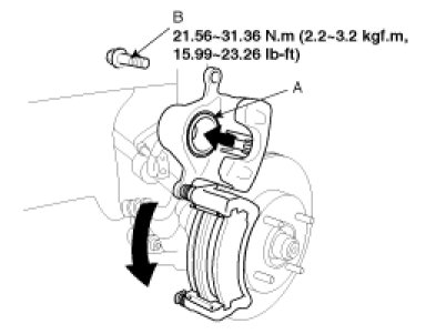

5. Push in the piston (A) so that the caliper will fit over the pads. Make sure that the piston boot is in position to prevent damaging it when pivoting the caliper down.
6. Pivot caliper down into position. Being careful not to damage the pin boot, install the guide rod bolt (B) and torque it to proper specification
NOTE:
Insert the piston in the cylinder using the special tool(09581-11000).

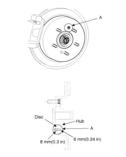

Seizing Of Rear Brake Disc
1. Remove the brake disc from hub using an M8 screw(A) if the brake disc has been seized with the hub due to corrosion or overheating.
NOTE:
Be careful not to use a hammer. The disc can be damaged if you remove the disc from the hub by hammering.
