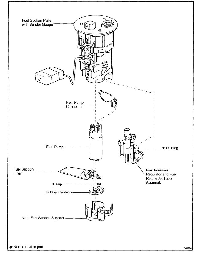

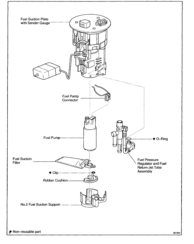

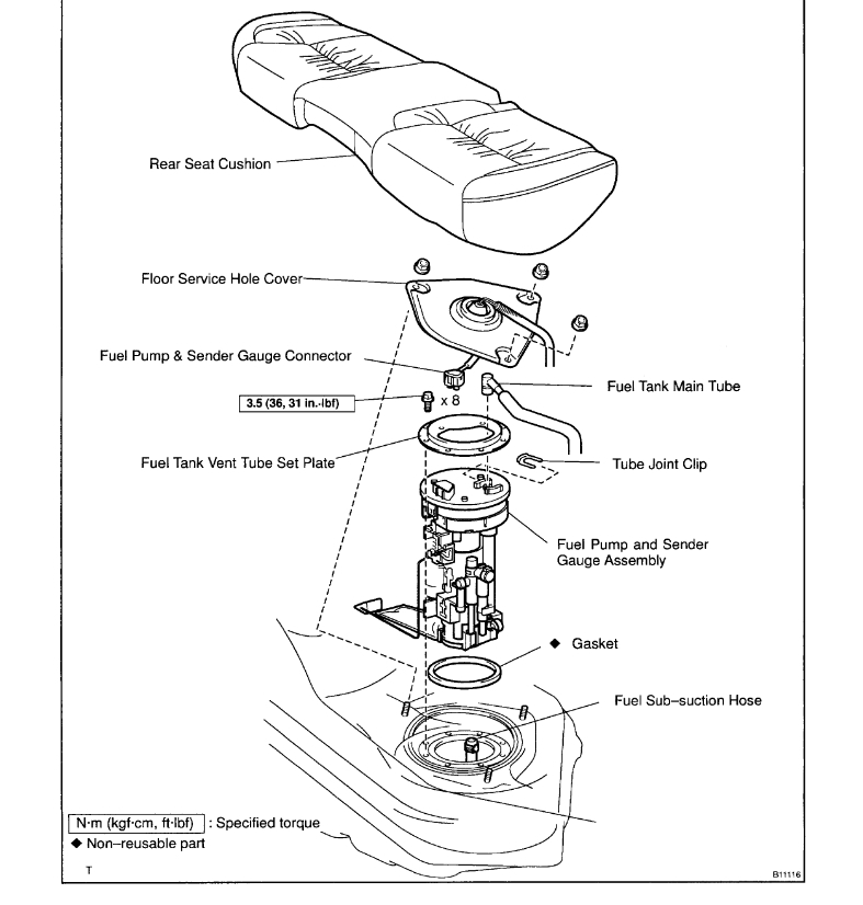

Yep, this happens when the fuel pump is going out, but to be sure we can check the fuel pressure by following this guide. You can rent a fuel pressure gauge from the auto parts store for cheap.
Fuel Pressure (At Idle) 304-343 kPa (3.1-3.5 kgf/sq.cm, 44-50 psi)
Check out the images (below). Let us know what happens and please upload pictures or videos of the problem.
