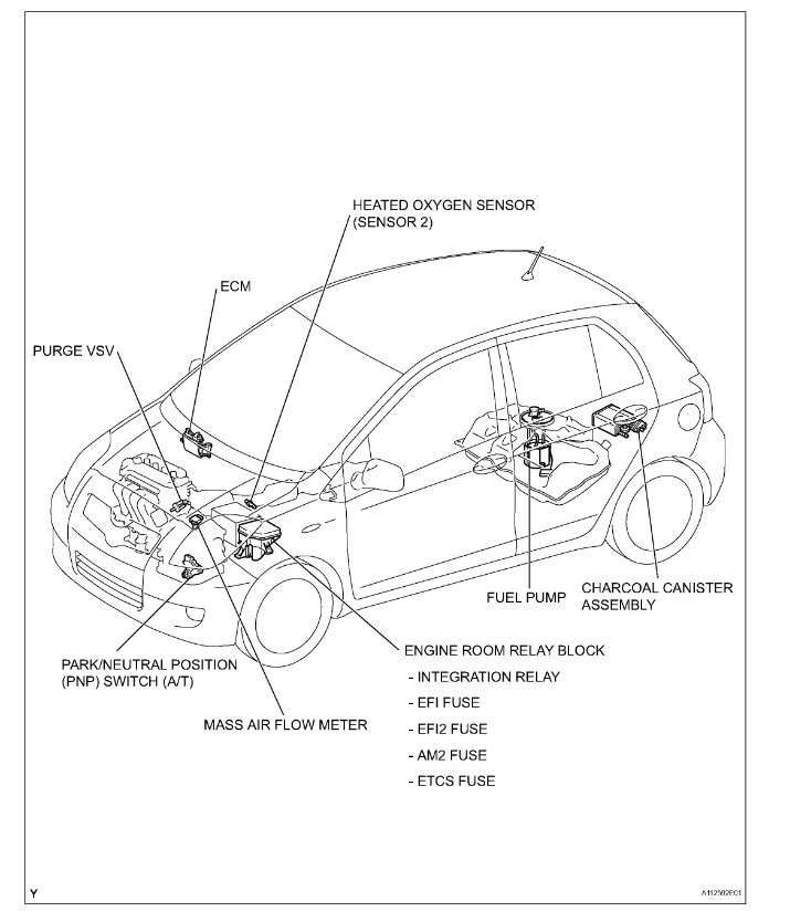

Do you have a check engine light on? If so, we need to scan for codes, this guide can help:
If no codes come up it sounds like you have a fuel pump or integration relay that is going out. When the engine won't start can you hear the fuel pump running in the tank for about 5 seconds?
Here is a guide that can help us fix it:
https://www.2carpros.com/articles/car-not-running-advanced

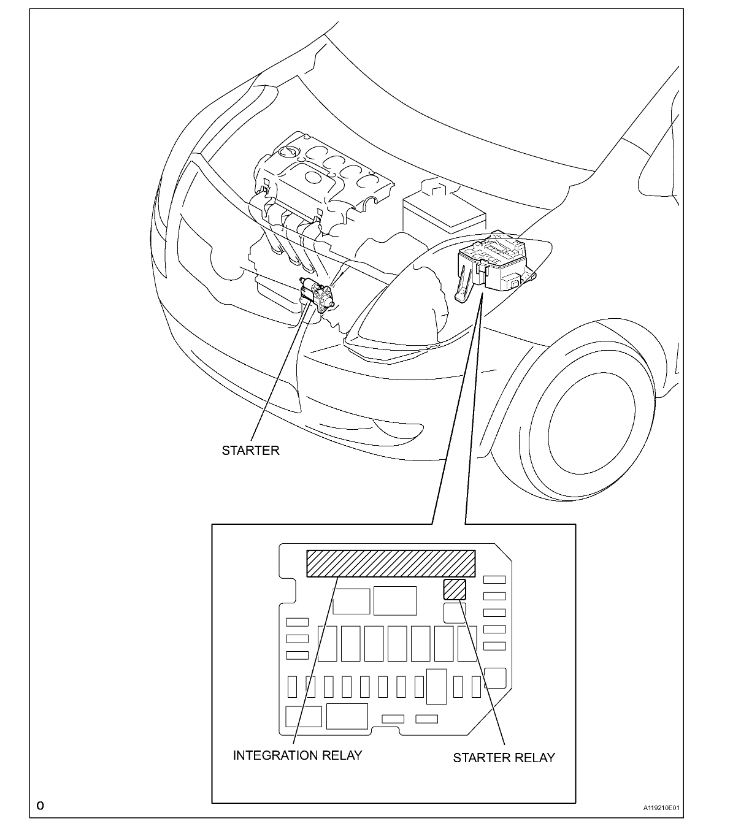

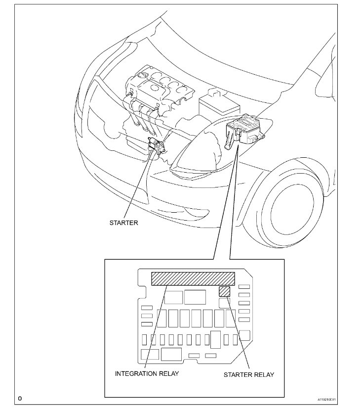

Also tap on the integration relay to see if the engine starts, here is the location in the diagrams below. Check out the diagrams (below). Let us know what happens and please upload pictures or videos of the problem.
