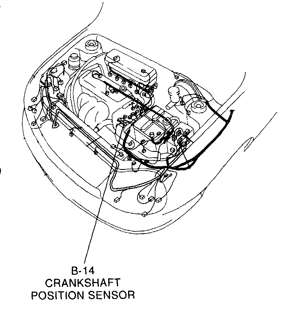

Also, a bad crankshaft position sensor can cause a misfire.
https://www.2carpros.com/articles/how-a-crank-shaft-angle-sensor-works
Picture 1 shows the location of the sensor.
