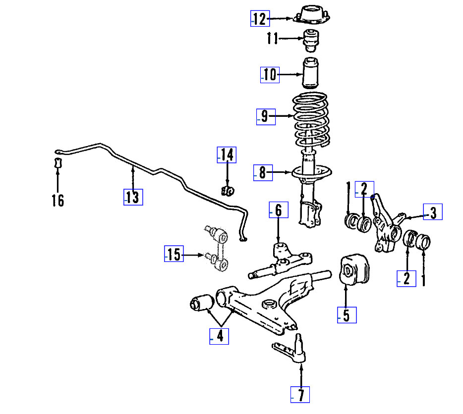

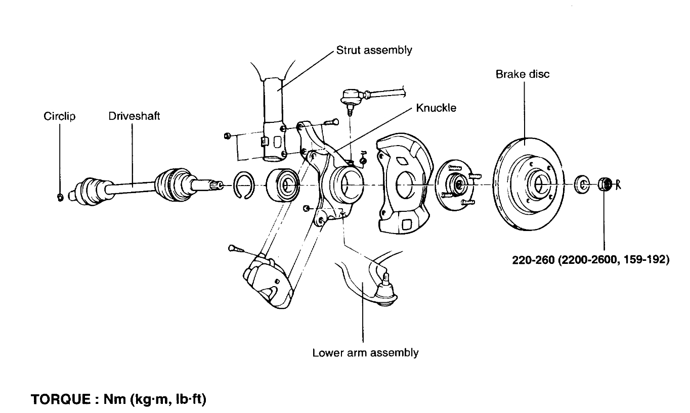

To make it sounds like you have a CV axle that is having issues which is common when you have been driven off road. Here is an exploded image of the suspension. Please go over this guide.
https://www.2carpros.com/articles/symptoms-of-a-bad-cv-axle-joint
Check for looseness in the suspension components and remove the CV axle to check for binding in the CV joints. Check out the images (below). Please let us know what happens.
