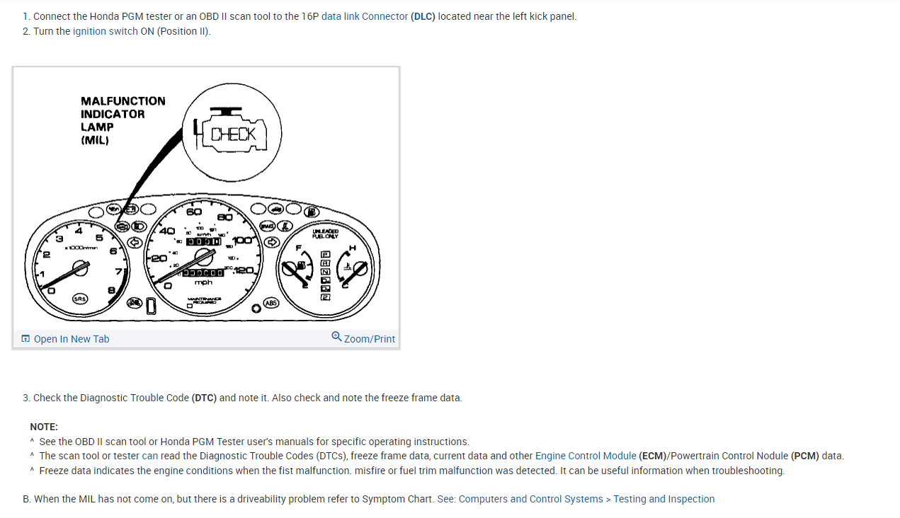

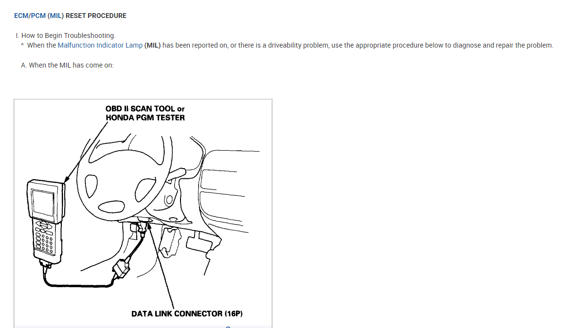

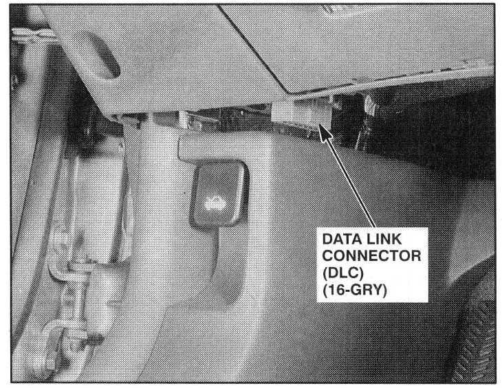

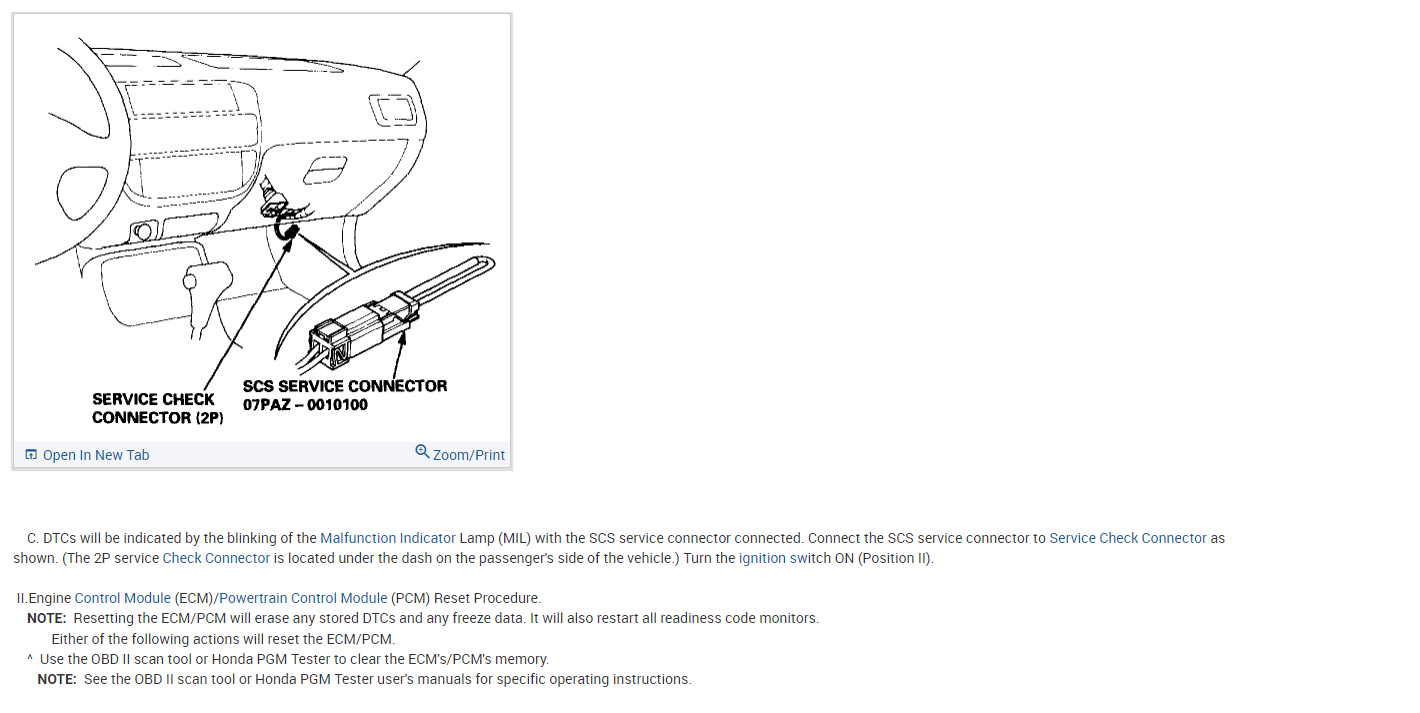

Did you check for the data link connector? I attached a pic below showing the location.
Check to see if it there and if there are wires attached to the rear of it.

This sounds like you have multiple issues, every issue has to have a new topic started. Your connector is there you just have to look for it.i suggest reinstalling original idle motor(when at idle and park and still have issues with idle ) you have to scan vehicle (try another parts store) also when installing a idle speed motor you have to clean the intake side of the idle motor.

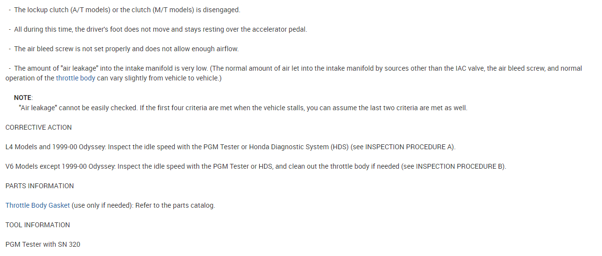

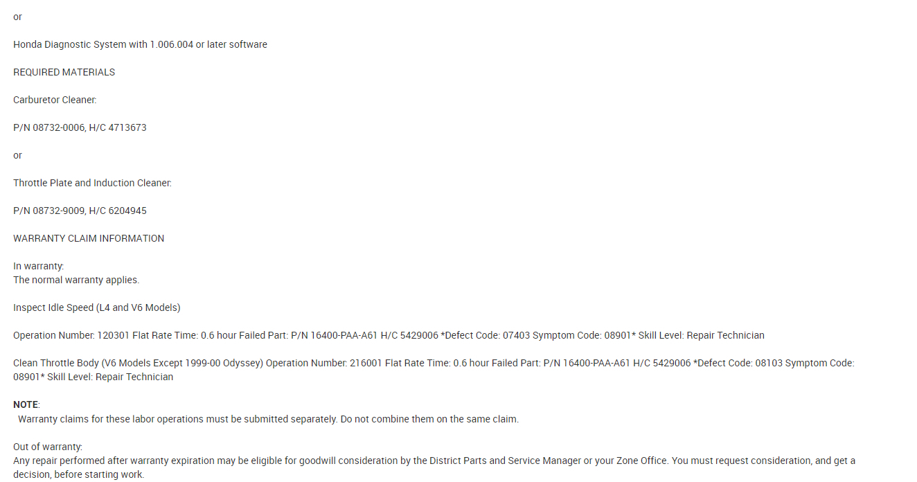

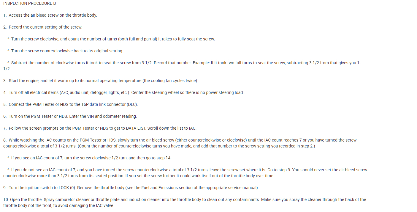

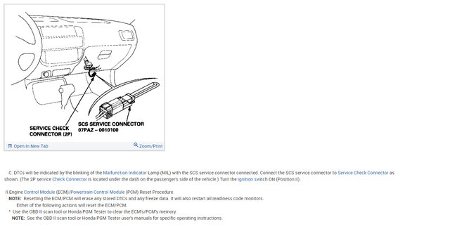

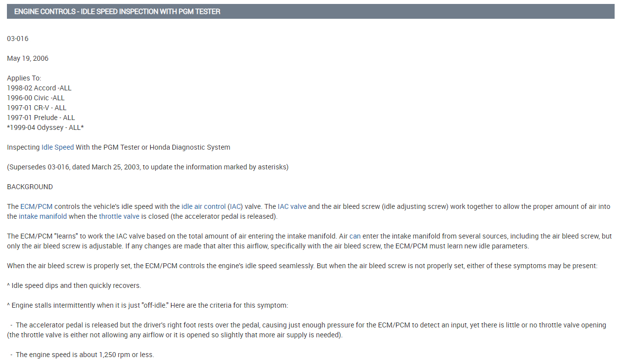

NICKOLAOSF
  • 69 POSTS

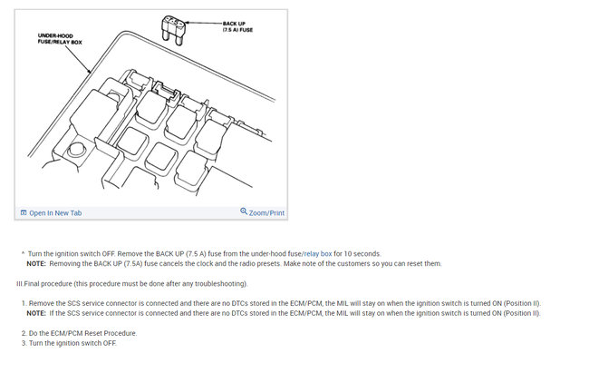

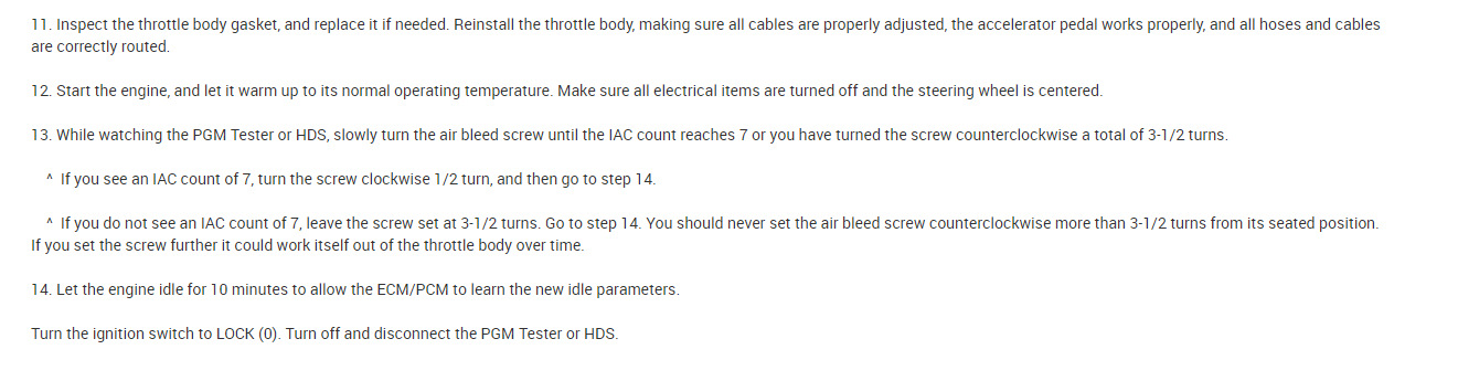

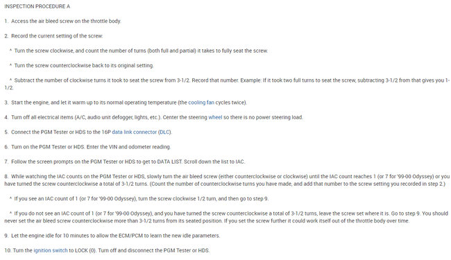

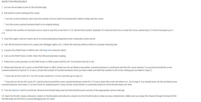

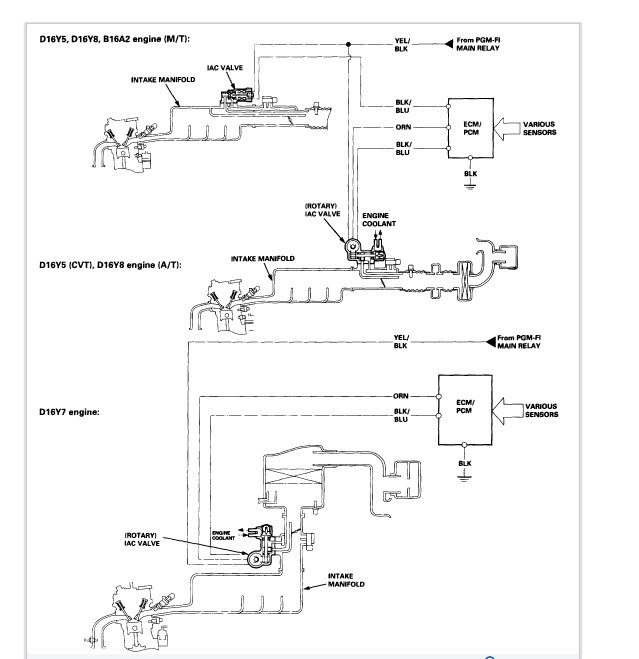

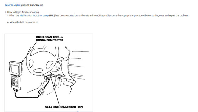

I would go to another parts store, it is possible then connector has been push up and it is behind, and just can see it, you have to look for it.
Check out the diagrams (below).
Cheers, Nick
