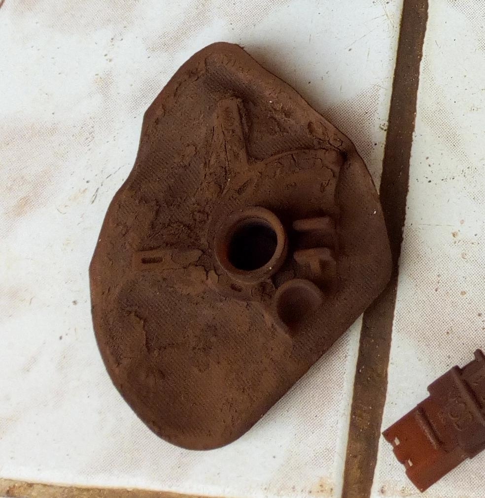

A local Nissan mechanic suggested that the problem with my Nissan Qashqai was the catalytic converter. To cut a long story short, they removed my catalytic converters by breaking them into small pieces and left my exhaust system open to the atmosphere.
Unfortunately, the cars performance became worse!

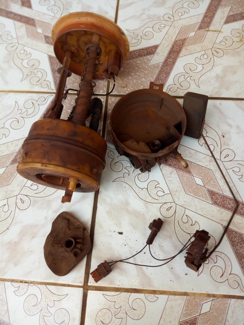

I called a friend who is an auto electrician and we both decided to check out the fuel pump.
We removed the car's back seat and gained access to the cover plate covering fuel pump assembly (within fifteen minutes we brought the pump assembly out).
We found a deposit of contaminated muddy fuel at the bottom of the fuel tank and pump. This is what has been clogging the strainer (inlet) to the fuel pump and causing the engine to lose power during acceleration.
What I did:
Drained the fuel tank and cleaned off the muddy sludge.
Cleaned the strainer thoroughly with a stiff brush and gasoline.
Cleaned the pump and assembly (carefully).
Then reinstalled strainer and pump assembly, and filled with fresh gasoline.
Problem solved at last (but after destroying the very expensive catalytic converter that was still new!).
The car has been performing well and there is no more engine hesitation or loss of power or lack of acceleration experience any more.
Please check out the pictures below for what was causing my problem.
Thanks for all your suggestions.
