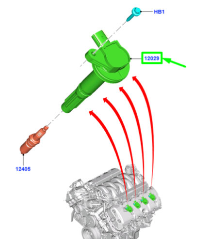

If the engine stutters at low RPMs with high load you most likely have an issue with the high-tension ignition system, either ignition coils or spark plugs. See image 1 below
The engine is fitted with eight ignition coils, 1 for each cylinder
