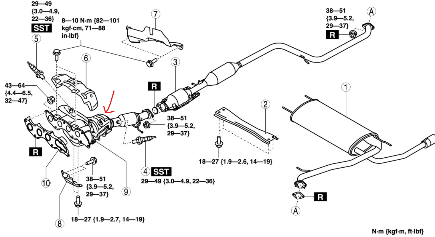

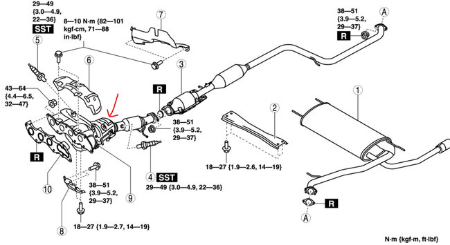

It sounds like you may have a catalytic converter that has fallen apart internally. We need to run the codes to see which ones are stored so they can tell us where to look for the problem.
