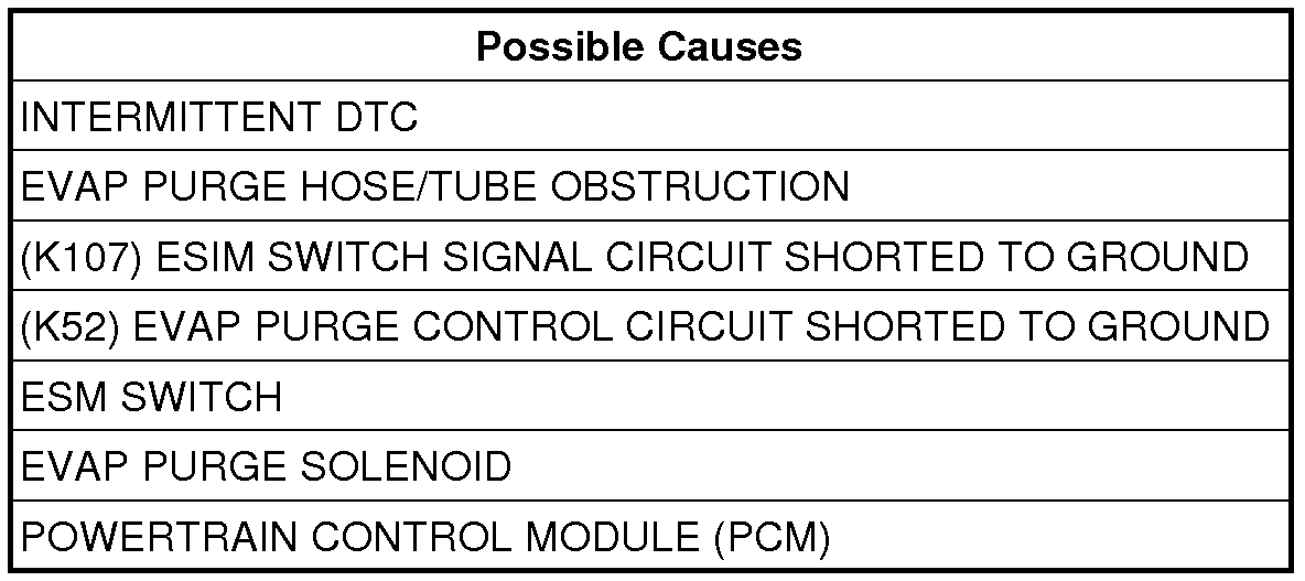

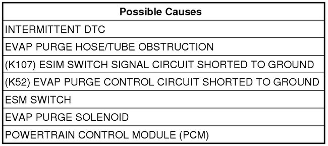

What I think is happening is either the pressure switch is bad or the purge solenoid is bad allowing fuel to enter the EVAP system and causing a hard start when you refuel.

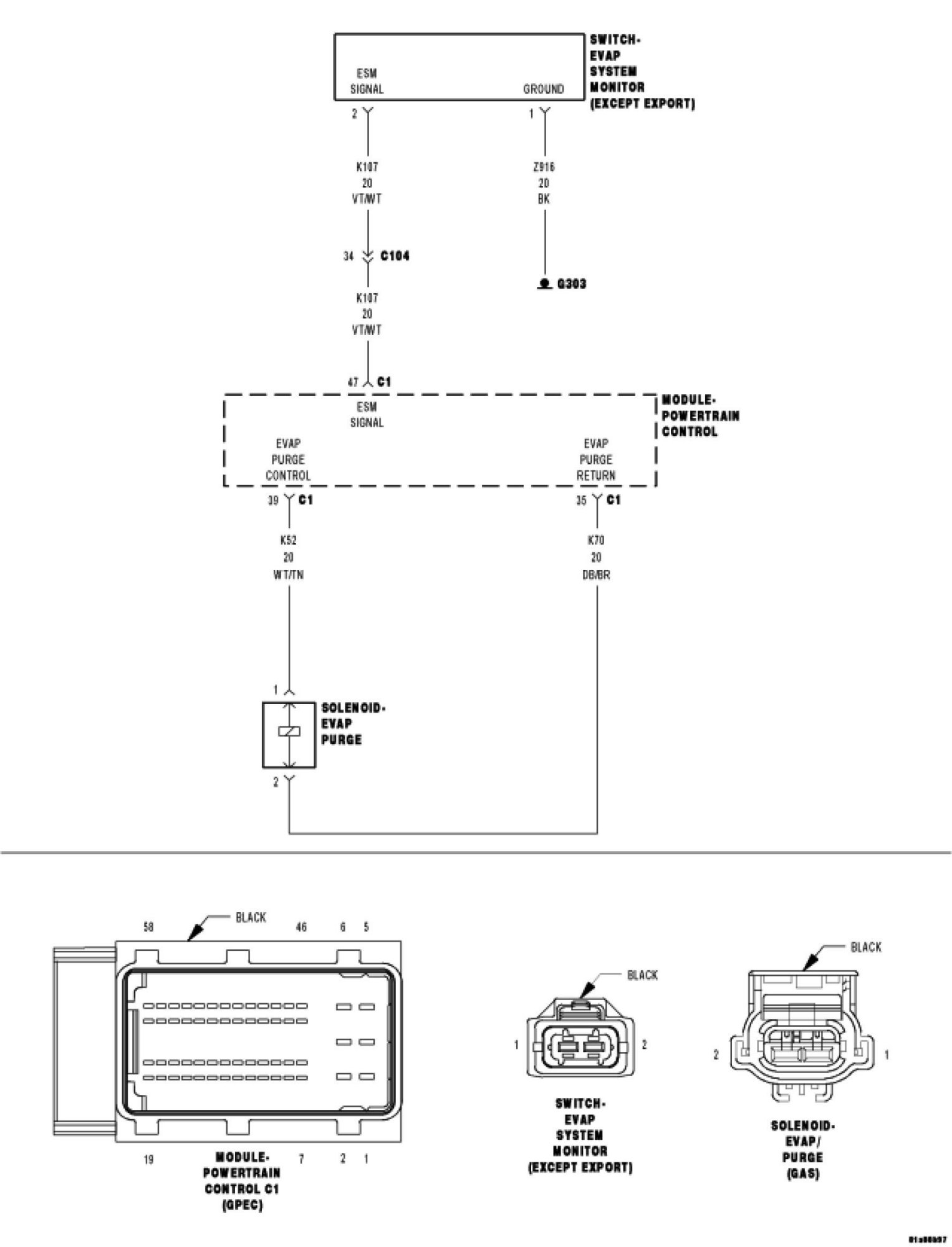

I attached a picture to showing possible causes for the code and a schematic of the system.
Now, I have to say, most likely the purge solenoid is bad. However, here are the diagnostic checks. It will require a live data scanner.
Here are the directions. They are somewhat involved. See pictures 3 and 4
For a complete wiring diagram Consult Diagrams/Electrical.

5. (K52) EVAP PURGE CONTROL CIRCUIT SHORTED TO GROUND
Turn the ignition off.
Disconnect the PCM harness connector.
Measure the resistance between ground and the (K52) Evap Purge Control circuit in the EVAP Purge Solenoid harness connector.
Is the resistance below 100 ohms?
Yes
- Repair the (K52) Evap Purge Control circuit for a short to ground.
- Perform the PCM Verification Test Ver. 1See: A L L Diagnostic Trouble Codes ( DTC ) > Verification Tests > Powertrain Verification Test.
No
- Go to 6

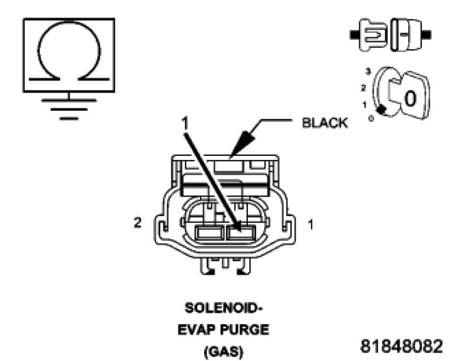

6. EVAP PURGE SOLENOID
Using the wiring diagram/schematic as a guide, inspect the wiring and connectors between the Evap Purge Solenoid and the Powertrain Control Module (PCM).
Look for any chafed, pierced, pinched, or partially broken wires.
Look for broken, bent, pushed out or corroded terminals.
Search for any Technical Service Bulletins that may apply.
Were any problems found?
Yes
- Repair as necessary.
No
- Replace the Evap Purge Solenoid.

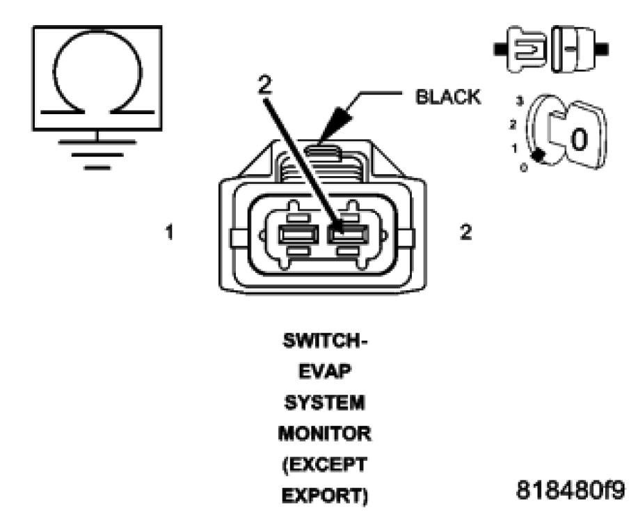

Disconnect the Evap System Monitor Switch electrical connector.
Does the ESIM Switch state change from CLOSED to OPEN when the switch is disconnected?
Yes
- Replace the ESIM Assembly.
No
- Go to 8
8. (K107) SIGNAL CIRCUIT SHORTED TO GROUND
Measure the resistance between ground and the (K107) ESIM Switch Signal circuit in the ESIM Assembly harness connector.
Yes
- Repair the short to ground in the (K107) ESIM Switch Signal circuit.
No
- Go to 9

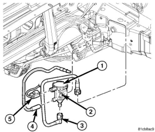

If you determine the purge solenoid is bad, here are the directions for removing and replacing it. The remaining pics correlate with these directions.
________________________________________________________________________________
EVAP PURGE SOLENOID - REMOVAL
REMOVAL
1. Disconnect and isolate negative battery cable at battery.
2. Remove the PCM, See: Engine Control Module > Removal and Replacement > Powertrain Control Module - Removal.
3. Disconnect electrical connector (5) from evaporator purge solenoid (1).
4. Remove purge hose (4) from evaporator purge solenoid (1).
5. Remove quick connect fuel tank hose (3) from evaporator purge solenoid (1).
6. Release tab (2) to remove evaporator purge solenoid (1) from bracket.
__________________
Replacement
1. Install evaporator purge solenoid (1) to bracket. Make sure the tab (2) secures the solenoid (1) to the bracket.
2. Install quick connect fuel tank hose (3) to evaporator purge solenoid (1).
3. Install purge hose (4) to evaporator purge solenoid (1).
4. Connect electrical connector (5) to evaporator purge solenoid (1).
5. Install the PCM, See: Engine Control Module > Removal and Replacement > Powertrain Control Module - Installation.
6. Connect negative battery cable, tighten nut to 5 Nm (45 in. lbs.).
