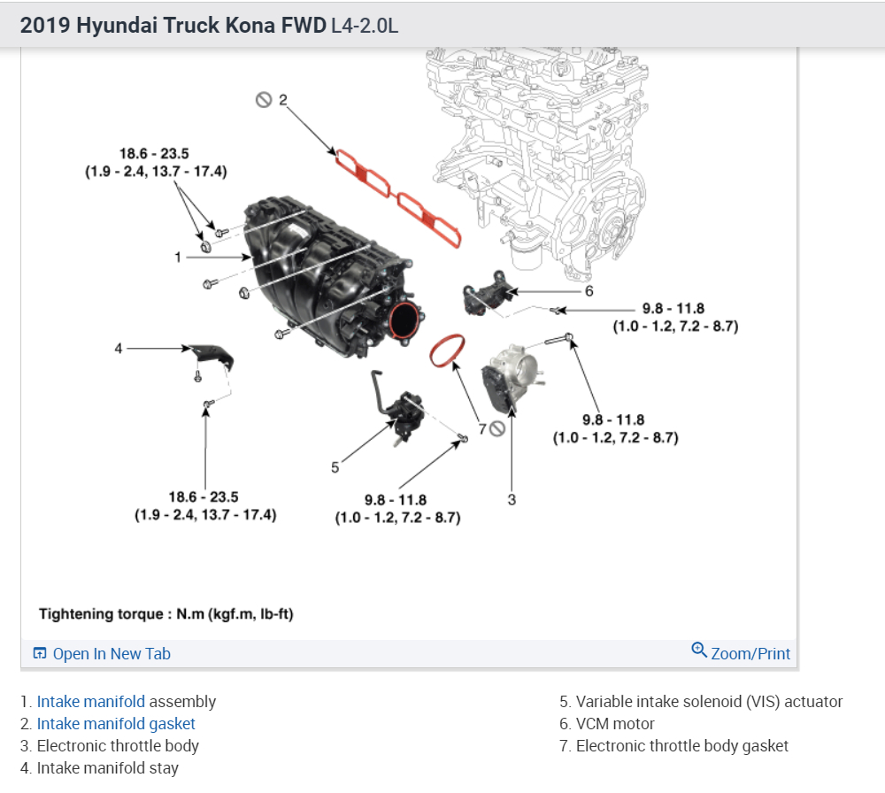

This can be a dirty throttle body or a vacuum leak.
here are three guides we need to go over to help us fix the problem:
https://www.2carpros.com/articles/stall-at-idle
and
And this guide test with the engine cold only:
Check out the images (below). Please let us know how it goes.
