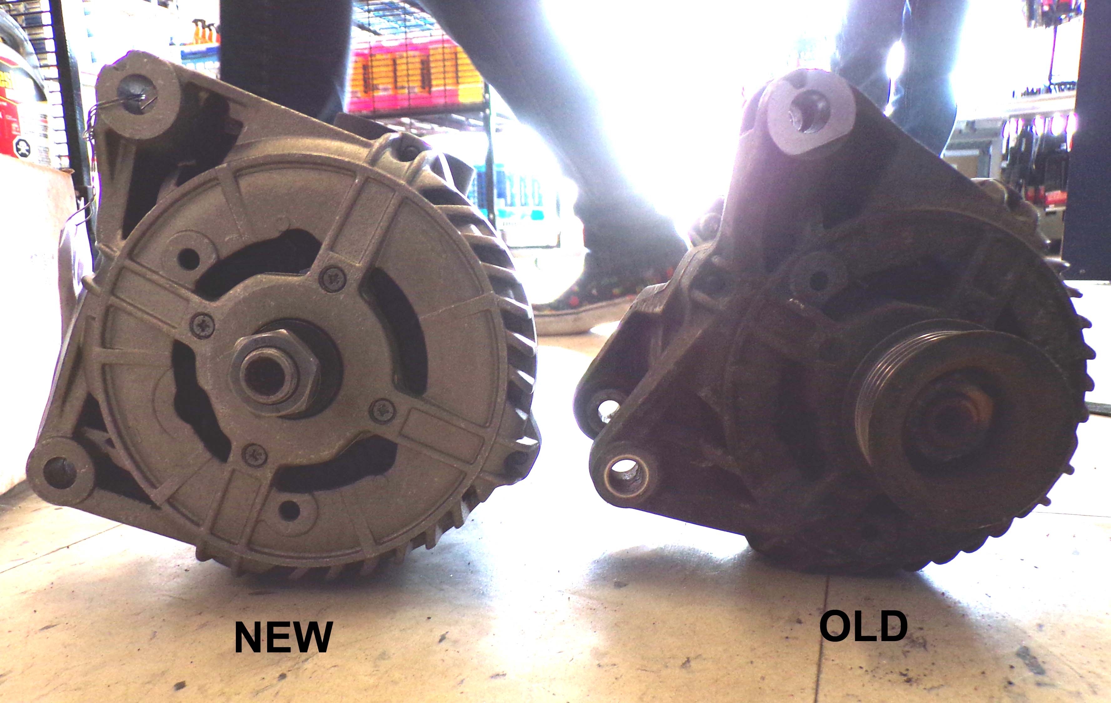

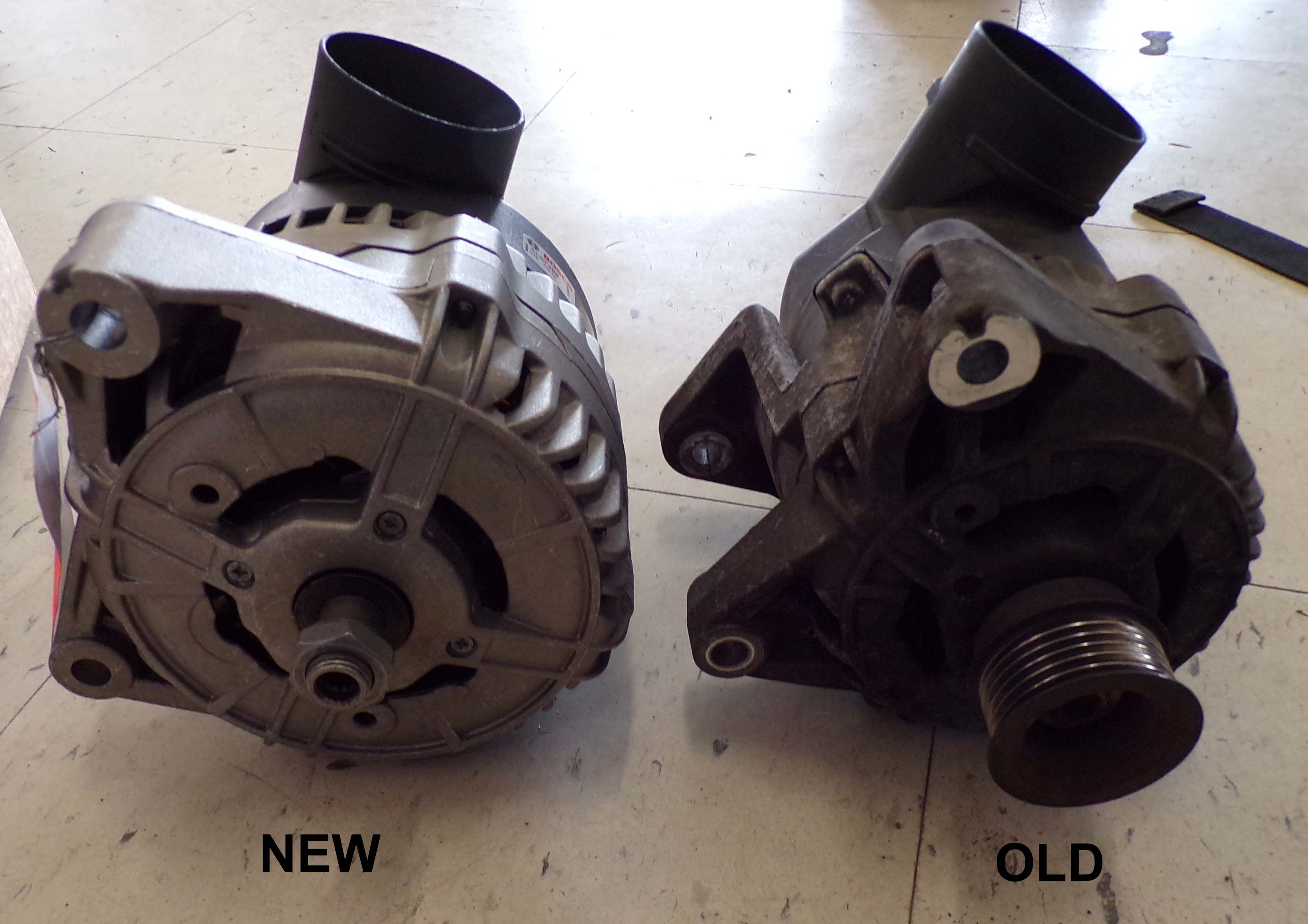

I got home okay, about a mile away, and then took the alternator out and sent it off to be tested and, if necessary, refurbished.
I had the alternator looked at and it is toast! The rotors have completely worn out, so it was the alternator that caused the issue. A new one is being ordered.
