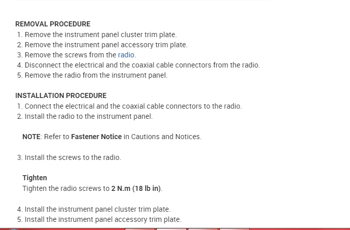

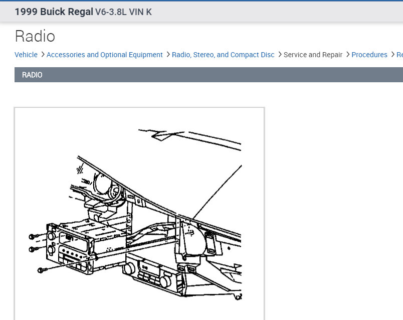

I have included the vehicle manufacturer's instructions for the removal and installation of the radio in your vehicle. I hope this helps. Please get back to us with how everything turns out.
