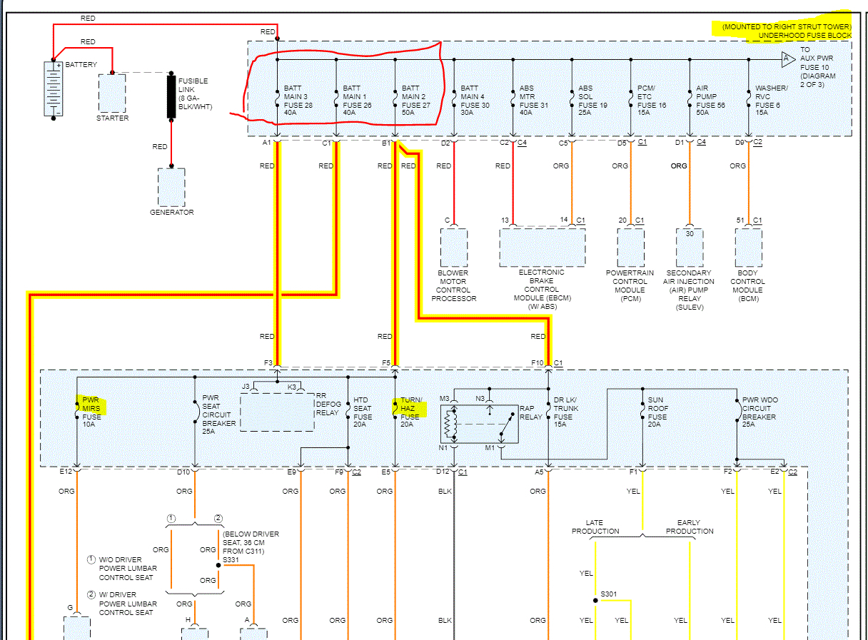

If you have no power to the inside fuse box, there are three fuses to check under the hood. I suspect two are good because you mentioned the horn and wiper fuses had to be removed.
If you look below, I attached the wiring schematic. I highlighted the wires between the under-hood fuse box and the interior fuse box. Check the three fuses I circled.
Let me know what you find.
