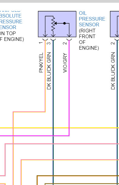

Hello is this car a 5.7L engine? And is it All wheel drive or 2-wheel drive?
It looks like this car has a three wire Oil Pressure Sensor. So, it will have a 5-volt reference, a ground wire and a signal wire going back to the engine computer. All these circuits must be checked. If one is missing the sensor will not work correctly. What is the code you're getting? And are there any other codes with it?
The pink/yellow wire is 5 volts, the dark blue/green wire is the ground, and the violet/grey is the signal wire going to the computer.
