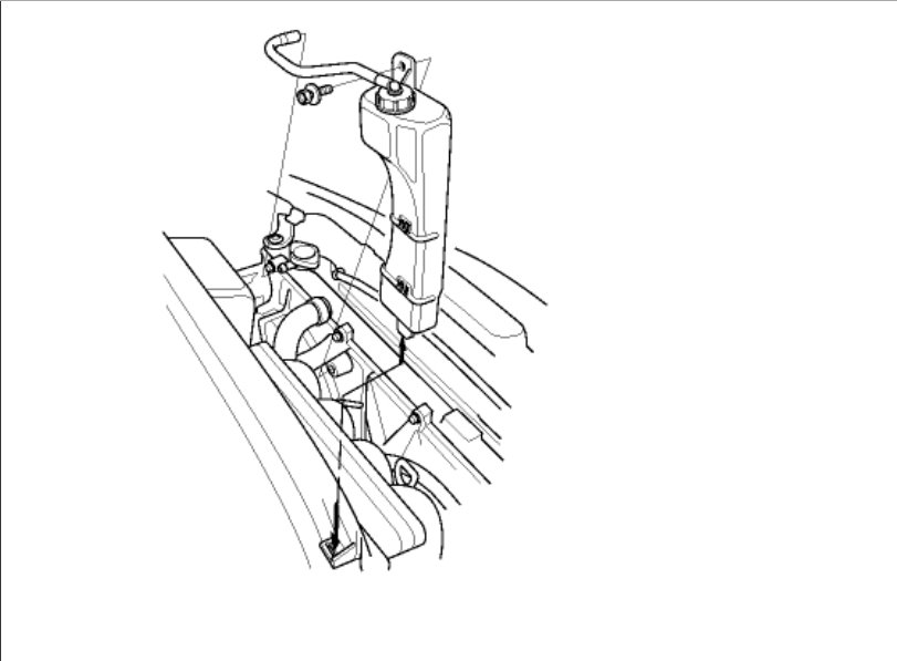

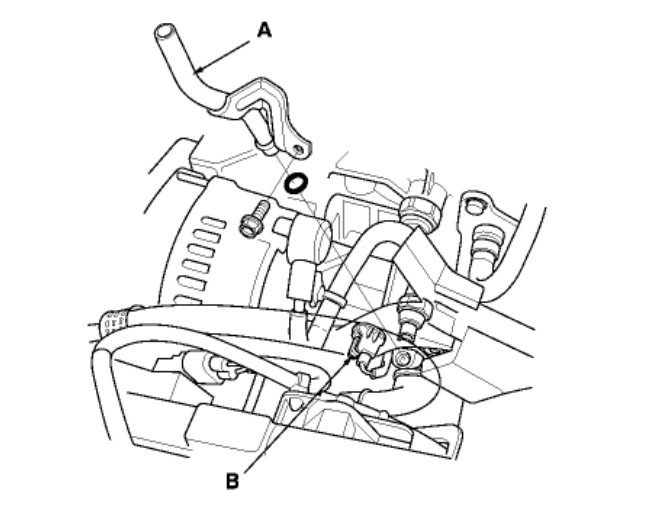

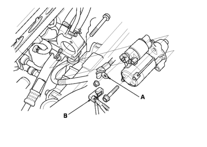

and if bad this guide gives you an idea of what you are in for when doing the job.
Below is what it will be like on your car.
