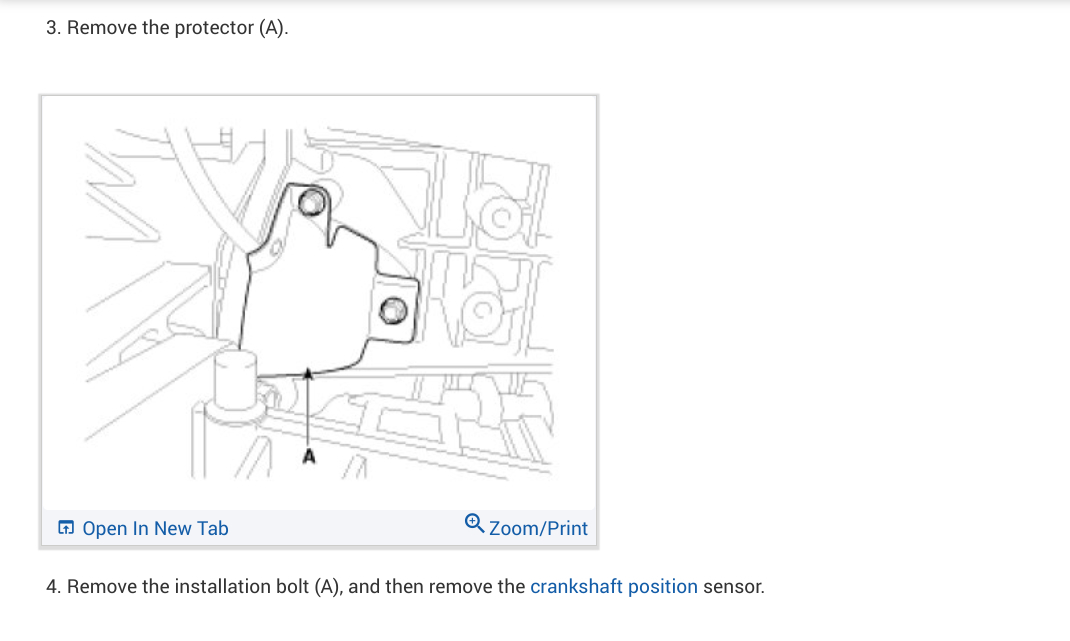

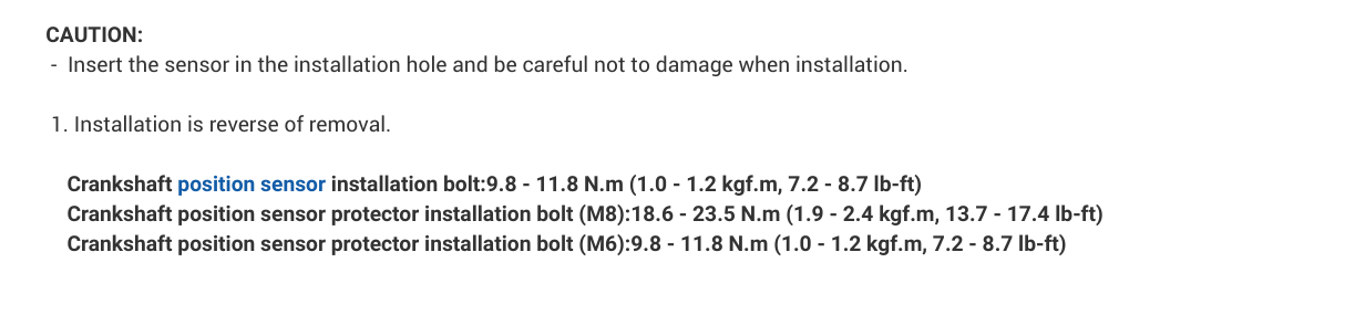

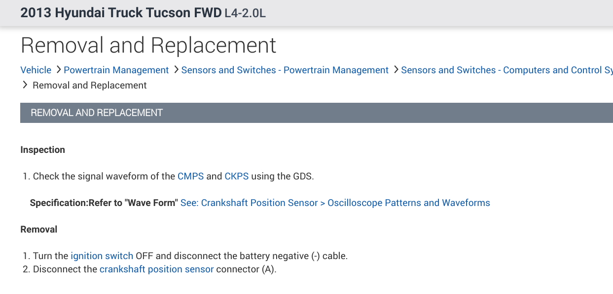

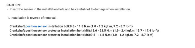

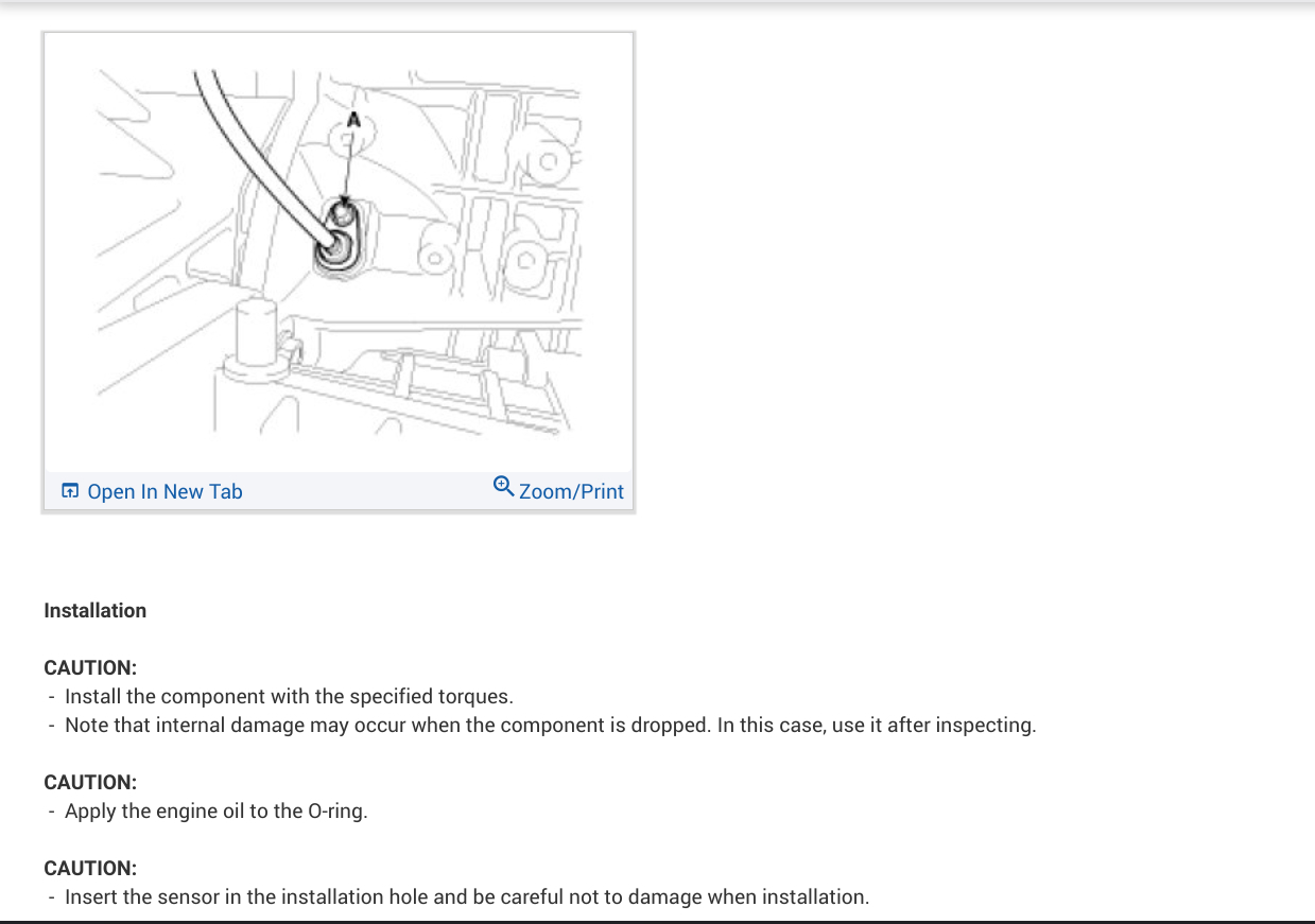

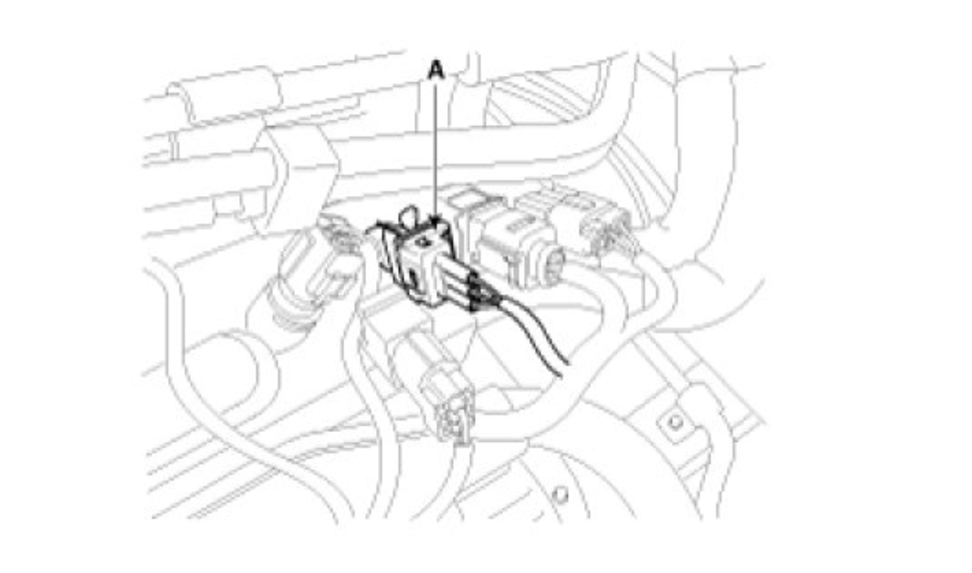

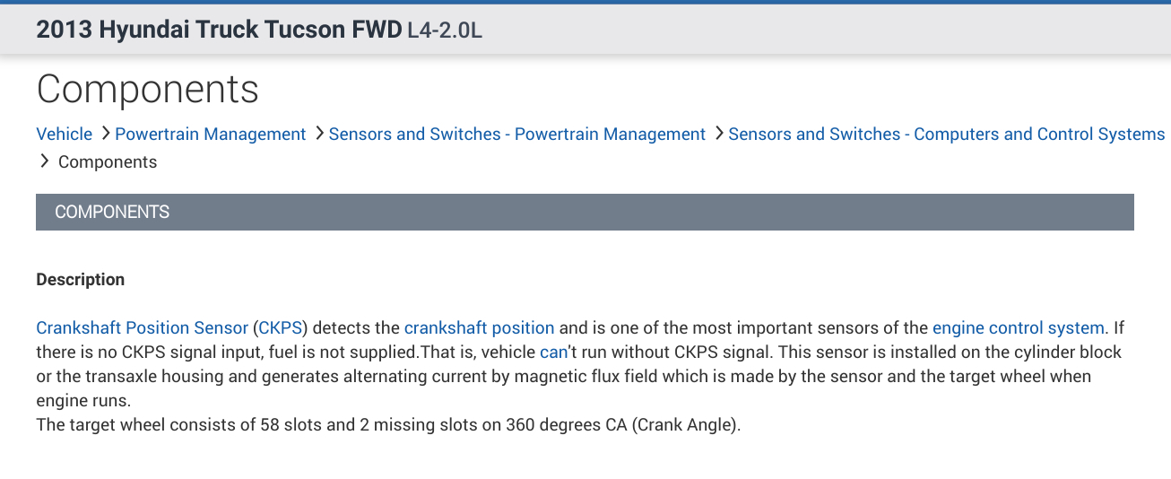

This could be a problem with your vehicle's Crankshaft Position Sensor[CKP]. In the diagrams down below I have included the description of operation and the instructions for the removal and installation of the CKP for your vehicle. Please go through these guides and get back to us with how everything turns out.
Thanks,
Alex
