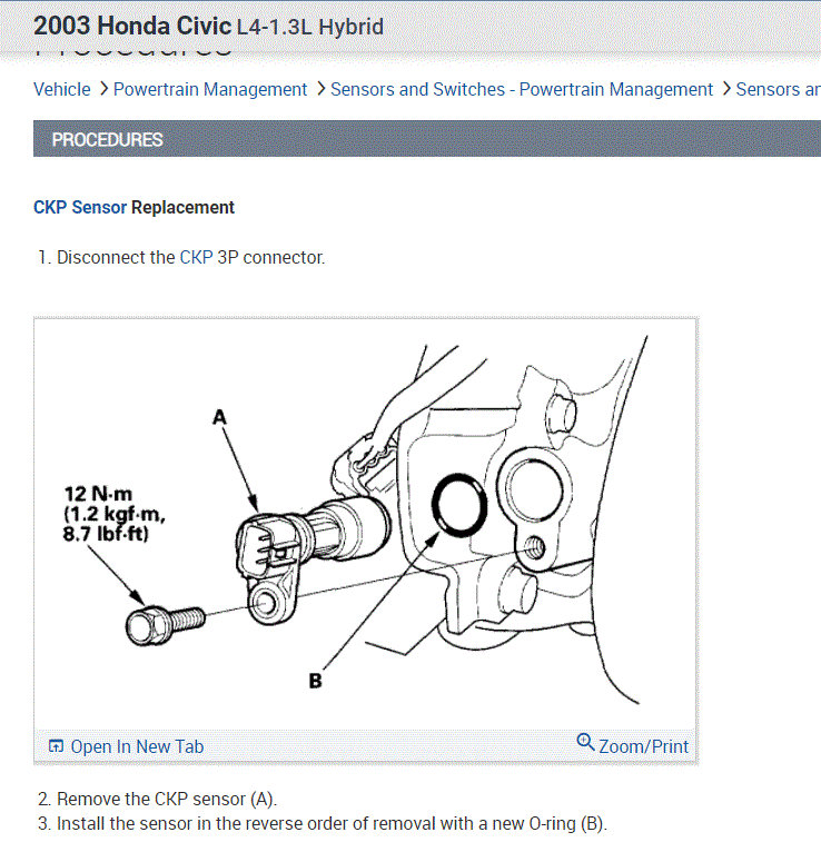

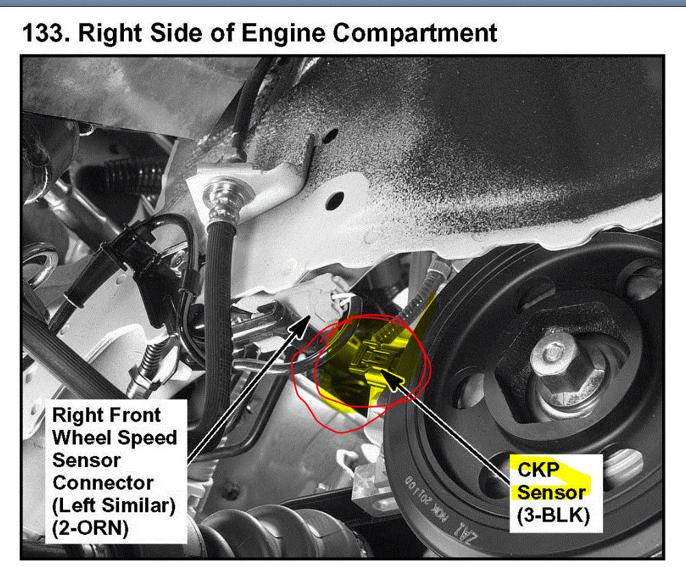

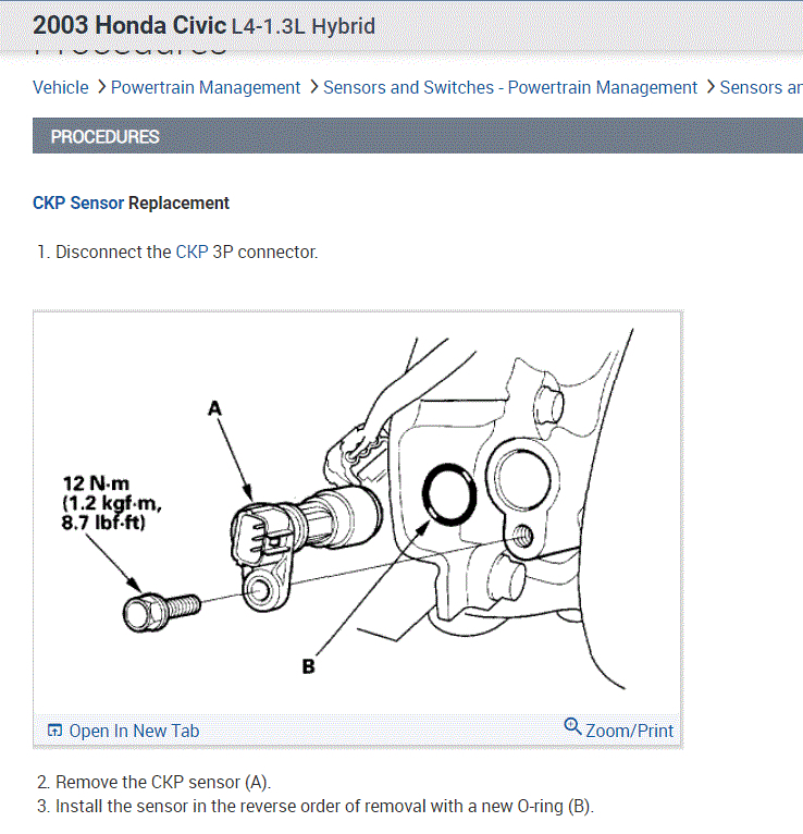

If you look at the pics below, they are the directions specific to your vehicle for replacement. Pic 1 shows the location and the remaining picture is the procedure.
See pics below.
