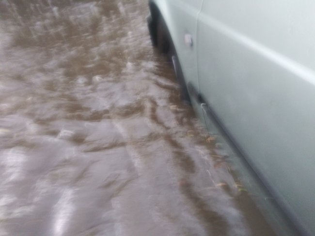

The other day we had a bad rain storm and I drove throw some water and did not think it was that deep, so right away it shuts off the car. so push it out as fast as I can towed the car home and started draining the water out of every where I could of. now I can get it to turn over for like two seconds then shuts off right away.

Yes it did, you can see in the picture how deep it was. After i drain all the water out of the turbo in the air cooler and exhaust out of the i change the plugs. I check to see if the fuel pump was working it was not vary strong so I run a hot wire to the fuel pump it seem stronger.then I pull the injector out and turned the car over. it seem to me like they are working.the only thing that does not work right that i know of is my key fob. It does not not open the trunk or unlock the doors.

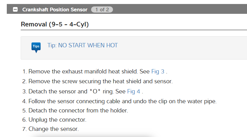

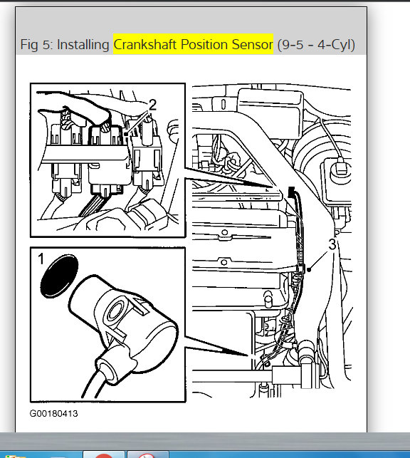

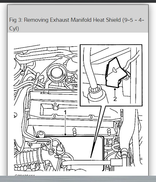

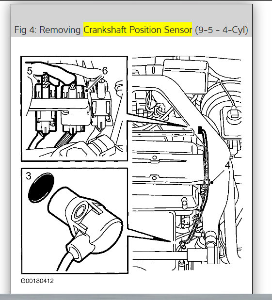

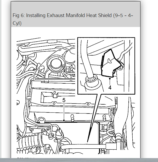

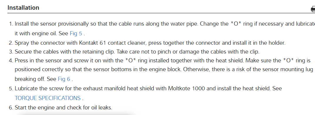

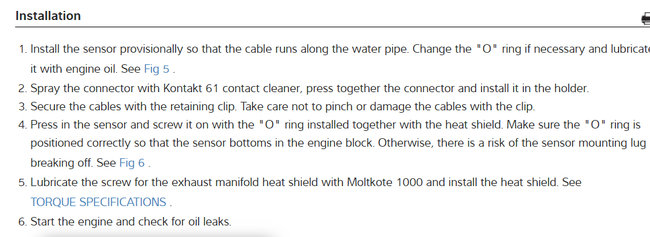

Okay, that's good. This could be a problem with your vehicle's Crankshaft Position Sensor (CKP). Your vehicle's Power-train Control Module (PCM) or "computer" uses the CKP signal to keep track of where the engine is in it's 4 stroke cycle and takes the information and fires the ignition and fuel injectors off of it. In the diagrams down below I have included instructions for the removal and installation of your vehicle's CKP. Please go through this guide and get back to us with what you are able to find out.
