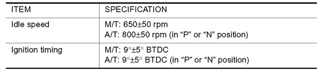

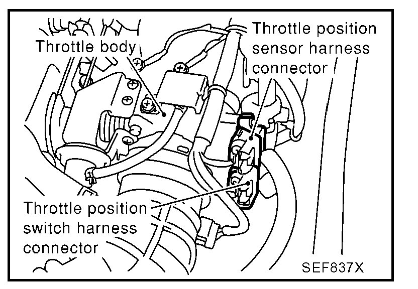

I am so sorry. I forgot to add the pics. Pic 1 and 2 follow the same order as above. As far as the pre conditioning, here is the list.

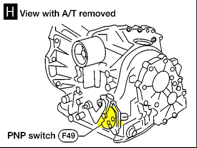

What and where is the PNP switch
Jul 26, 2019 at 4:27 AM
Welcome back:
See the attached pic.

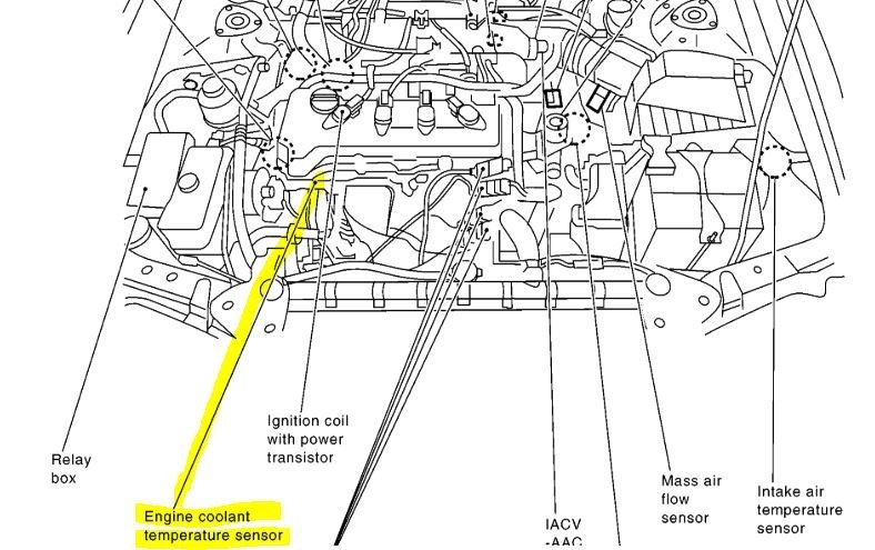

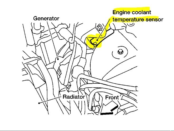

That code is related to the engine coolant temp sensor (ECT). What makes this interesting is the idea that based on the sensor's signal, the computer determines how rich or lean to make the fuel mixture. It could cause it to stall and not want to start if it is too rich or lean. Now, if you have access to a live data scanner (I assume you have a scanner because you provided the code) I want you to go to live data and check the signal from the ECT. It should indicate the correct engine coolant temperature. If it is way off, replace the sensor.
I attached 2 pictures below. The first shows ECT location in general. The second is more pinpointed.
___________________________
Let me know what you find or if you have questions.
