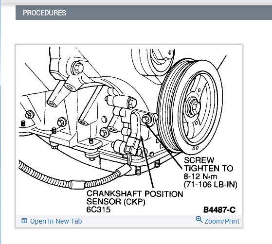

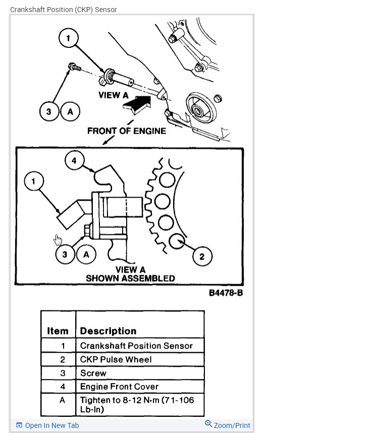

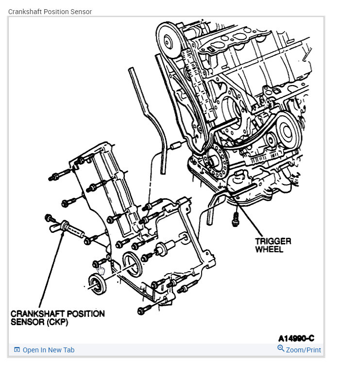

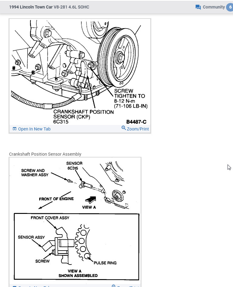

This sounds very much like a crankshaft position sensor that is failing.
I attached a bit of info about this which explains in more detail. However, the basic point is that the sensor gets hot and it fails which causes the vehicle to shut off and not restart. Then when the sensor cools off it closes the circuit again and the vehicle operates as normal until it does this again.
Clearly this could be other things but this is the most likely cause.
Let me know if you have questions. Thanks

I am going to put one in tomorrow. I'm glad it's up top. I didn't realize these things are so sensitive to heat. I may have to get back with you if I experience problems. I do thank you so much. Randall Beard, Pickford, Mi.

Yes. It can cause a stall or a no start. If the engine is cranking and not starting then the crank sensor is the most likely cause.
Did you replace it before and now it is doing this?
Jan 26, 2020 at 6:33 PM
RANDALL729
  • 59 POSTS
I put in the new part I think was less than 6 months ago. I replaced all the relays. I also replaced the the camshaft sensor as well. The crankshaft position sensor at the bottom of the engine must be the problem. I have eliminated the relays as a problem. Has to be what you are suggesting to look for. Thank you 2CarPros Kasekenny1. But I may have to ask more questions about my car to get it running if okay.
Jan 26, 2020 at 8:20 PM

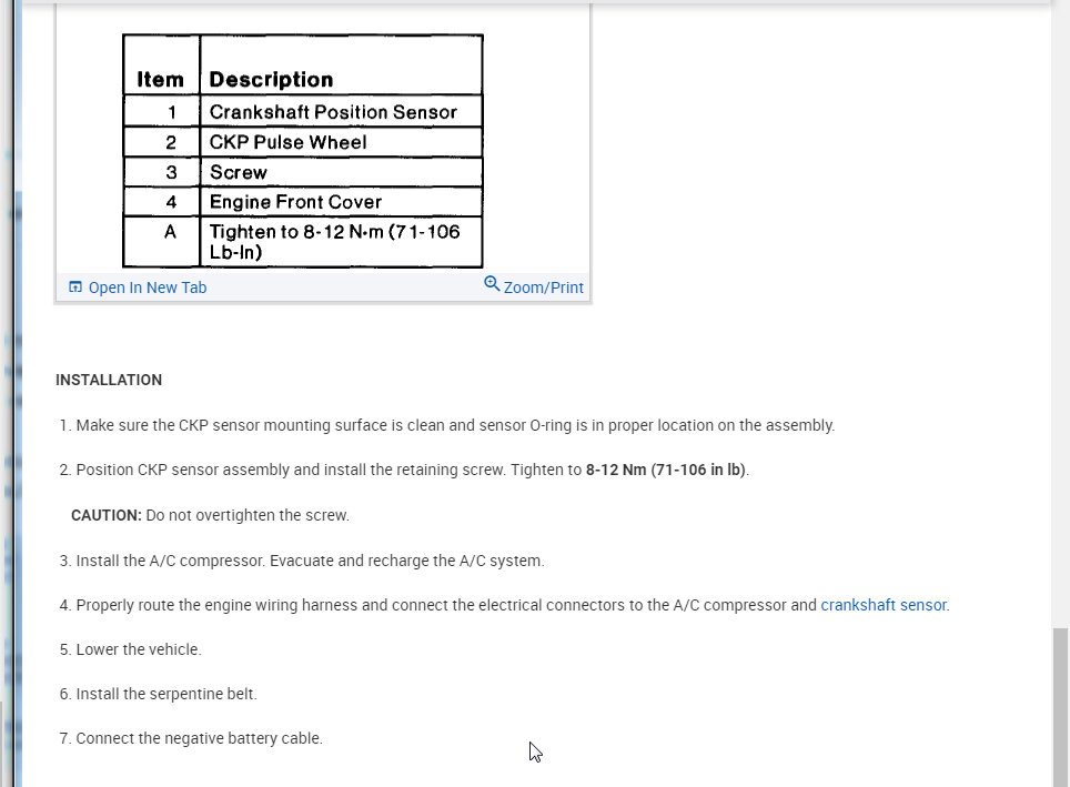

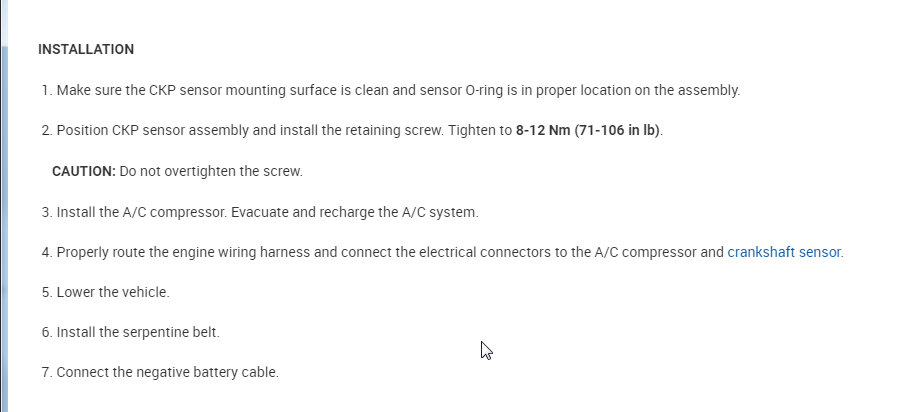

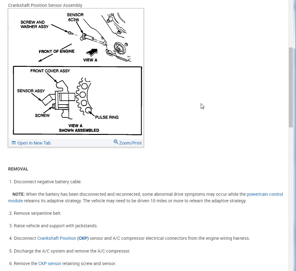

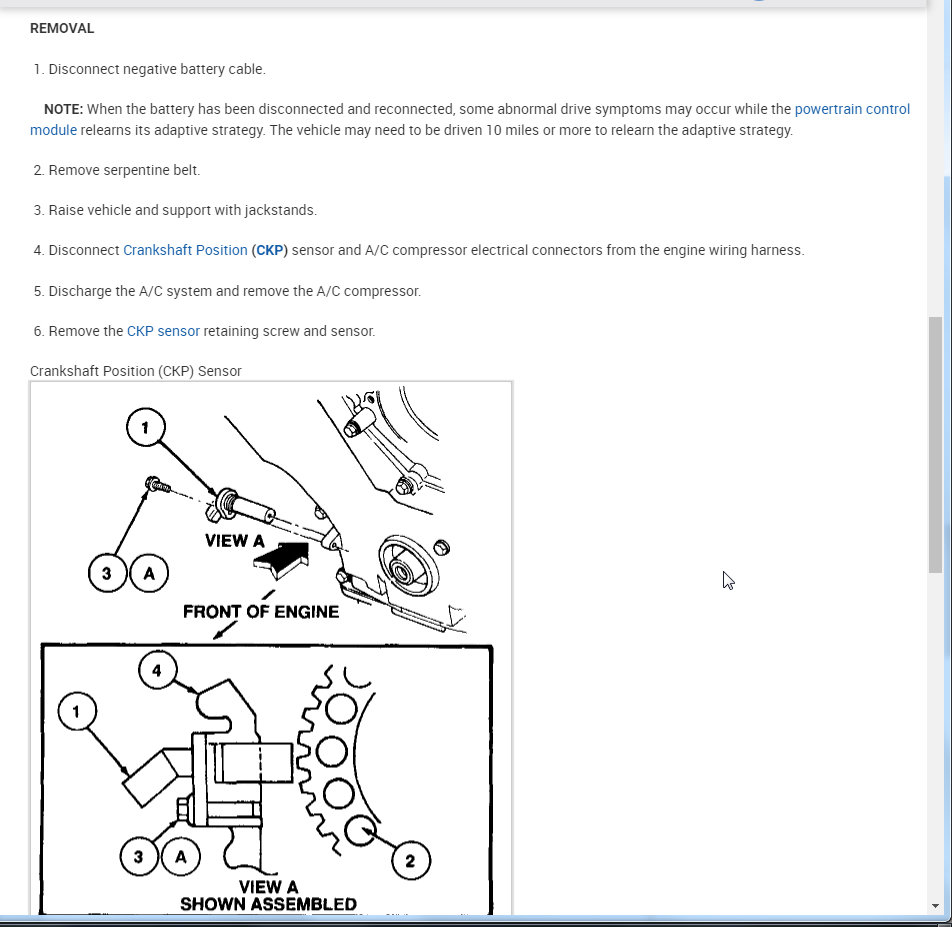

I agree that the crank sensor sounds like the issue. I included the info about it and the process to do it. They are not too hard on these engines.
Please ask as many questions as you need. We are here to assist. Most of us have complete vehicle knowledge and if one of us doesn't know, others will jump in and help out.
If you have questions related to this topic, just post them here. However, if they are different then go ahead and start a new post. Basically we need to keep each post to one topic so that others can find the issues when they are searching for solutions on their own.

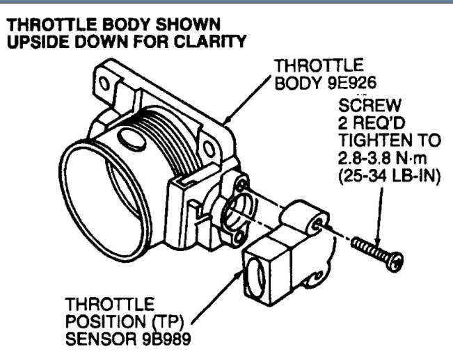

My inlet heater core hose ruptured and water came out while I was on the highway. I replaced the hose replaced the spark plugs and wires. the engine will crank but it will not start. I know water got over the engine. I’ve change the CPS Sensor but still will not turn over. what do I do?
Feb 22, 2021 at 8:24 AM (Merged)
DANNY L
  • 5,648 POSTS
Hello, I'm Danny.
First thing I suggest would be to clean the throttle position sensor. It's possible it got engine coolant inside the connector when the hose blew. Here is a tutorial showing what is involved for removal and replacement for a mass air flow sensor which is similar:
https://www.2carpros.com/articles/mass-air-flow-service
I've attached a picture below of what your throttle position sensor looks like on your car. Let us know what you find. Hope this helps and thanks for using 2CarPros.

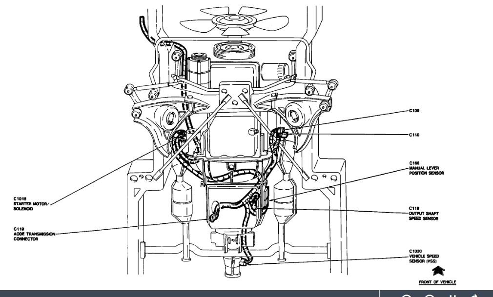

Turn key and tries to start, had in shop twice, replaced a sensor and was not problem, then replaced ICM (ignition control modulator) and bam car started! Brought it home, got in it next day and nothing! No start again, towed it back to same shop. Found new ICM on eBay, bought it took to shop, he popped it in, car started right up, came home, started car every day for four days and it would start, last day let it run for about five minutes and turned it off and went back in about an hour later and nothing! Back to trying to turn over. Everything else is fine or so it was, fuel is fine, starter/alternator fairly new. What could cause two ICM's to fail? We have it stored for winter, so not something to get done immediately but we are going to have to get it fixed by spring. Ideas?
Feb 22, 2021 at 8:25 AM (Merged)
Good afternoon.
It may not be the module at all. There is a sensor on the rear of the transmission at the driveshaft that sends a signal to the module for spark. If the is bad, it will cause this.
It may be that if you disconnect the wires at the module and re attach them, it may start.

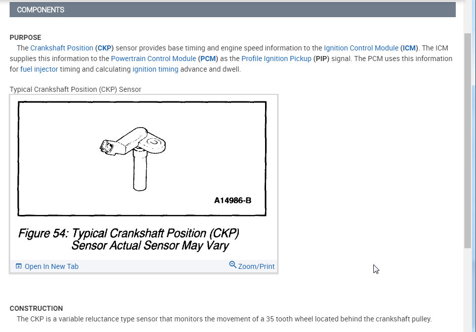

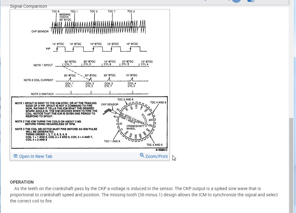

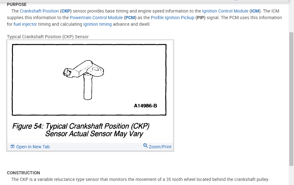

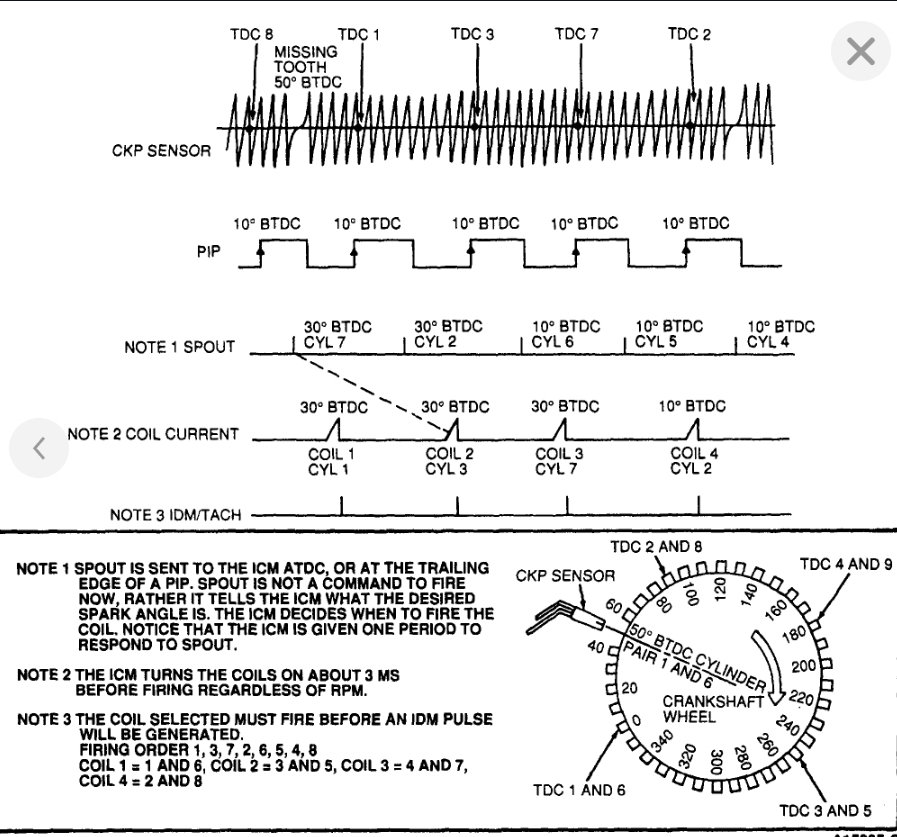

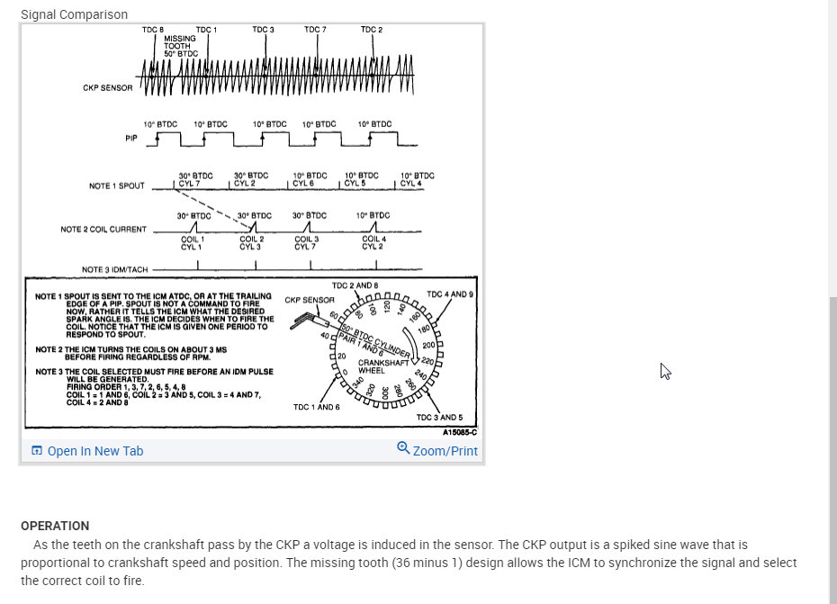

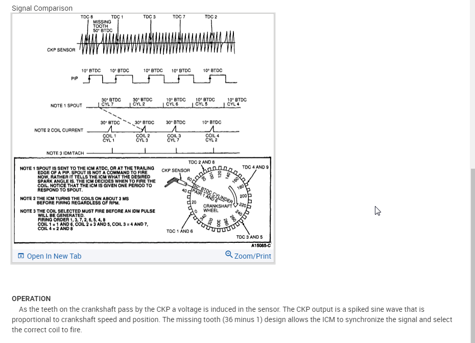

PURPOSE
The Electronic Distributorless Ignition System (EDIS) module's primary function is to deliver full energy spark at a crank angle targeted by the Electronic Control Assembly (ECA) module and to provide the ECA with crankshaft position information.
CONSTRUCTION
The EDIS ignition module is a twelve pin custom microprocessor-based thick film module. Even though each engine is very different in size and structure, EDIS modules for each engine are very similar. With the exception of some pin assignments, basic operation of the EDIS systems for the different engines is identical.
OPERATION
The EDIS module receives input from the Variable Reluctance Sensor (VRS) style Crankshaft Position Sensor (CKP) in order to identify the passing of the missing tooth on the VRS trigger wheel. The module is said to be "synchronized" when the missing tooth is found. Synchronization is essential to the EDIS module in order to track the angular position of the crankshaft relative to a fixed reference and when it should fire the proper coil.
Profile Ignition Pickup (PIP) output is synthesized by the EDIS module using input from the VRS signal. The PIP signal generated by the EDIS module indicates engine speed and crankshaft position to the ECA. The PIP signal is used by the ECA so that it can enable fuel and spark functions and generate a Spark Angle Word (SAW) signal.
