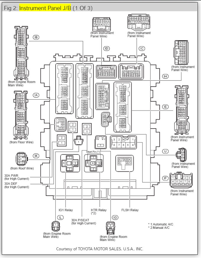

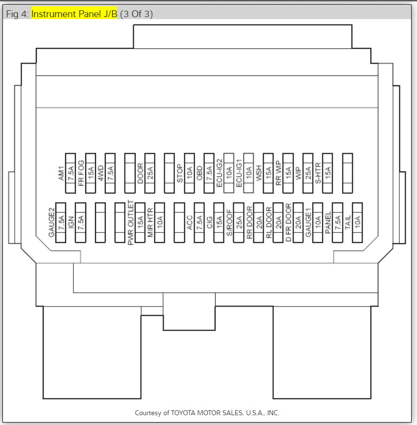

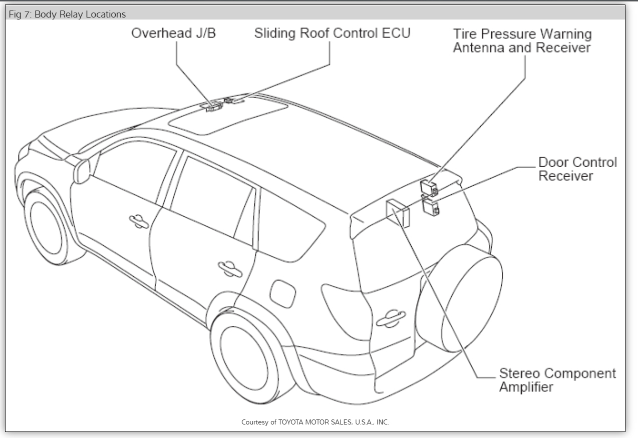

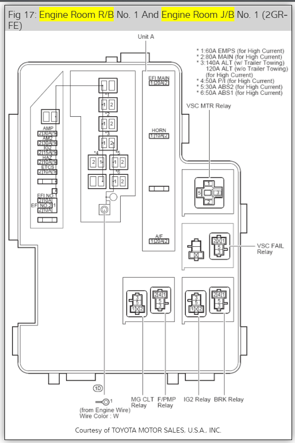

Can I get the code numbers please? Also have you checked all of the fuses? Here is a guide to help with that and the fuse location as well, test them with the key on.
Check out the images (below). Please let us know what happens. You might have burned up the main body ECU. I would do a CAN scan.

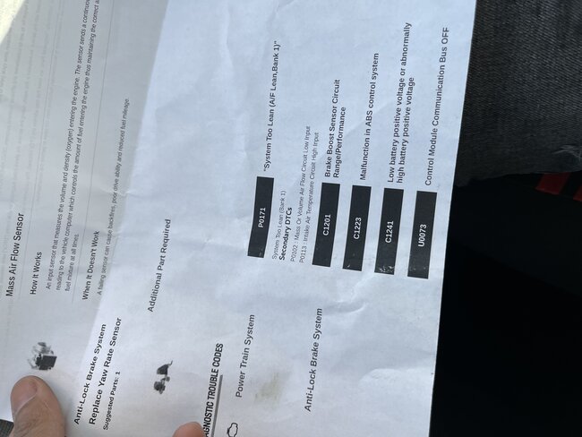

It's usually when i brakes and turn the steering wheel or turn a corner going slow it wants to shut off or stall and i have to pump the gas at keep the car from shutting off then it runs fine but rpms stay under 3,000 on highway and doesn't move with the speedometer. Below are the codes.

When the check engine light comes on so does the ABS light. For now, we need to ignore the ABS light as this may not be an issue or a separate problem. What we need to focus on is P0171 as the root cause of the fault before we address the Mass Air Flow sensor. If that is an off brand that can also present problems since they are not properly calibrated.
First thing we need is the freeze frame data for P0171. We need to see if the code posted at idle or cruising. If at cruising, then the MAF could potentially be the culprit. If it was at idle, then sounds like a vacuum leak or low fuel pressure.
Here are some repair guides on how to check those items:
Please provide the freeze frame data or your test results to advise on the next steps.

C1241 you usually get when battery voltage is low. That may have set when you left the key on too long. If memory was lost to the engine control module, then start by disconnecting the battery and while disconnected clean out the throttle body bore.
Here is a link that explains how to do the service:
Try that first and let us know if that helped you out. If it doesn't then you will need to do the fuel pressure test and vacuum leak check for issues.
