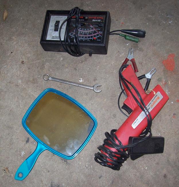

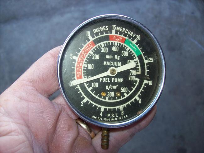

ARE YOU CAPABLE OF WORKING ON THIS YOURSELF? (LIKE KNOW YOUR WAY AROUND IN THERE)
DO YOU HAVE A VACUUM GAUGE----A TIMING LIGHT---A DWELL/ TACH METER?
