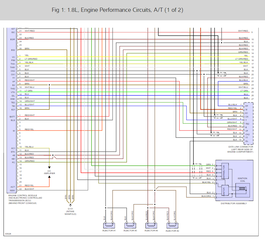

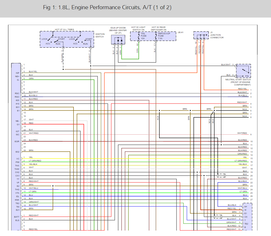

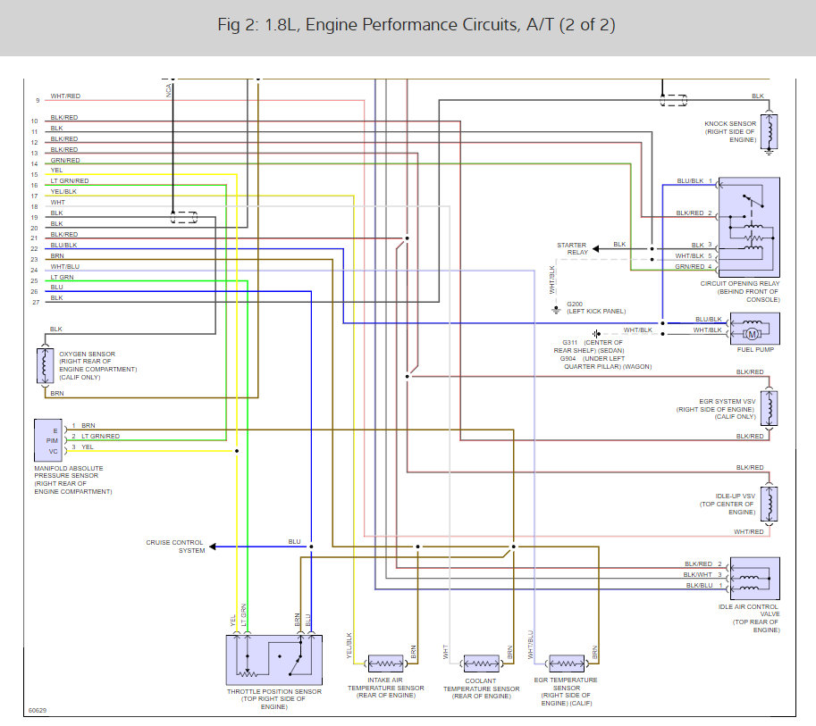

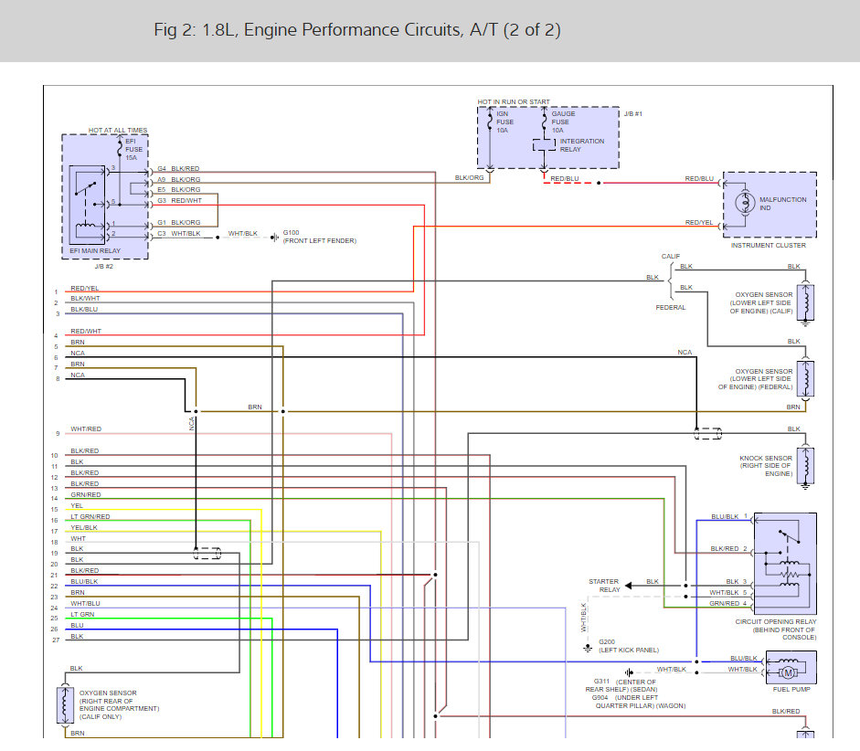

Here is a guide to help you run the codes:
https://www.2carpros.com/articles/toyota-trouble-code-definitions-and-code-gathering-method-1990-1995
Check out the diagrams (below).
