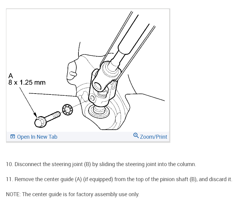

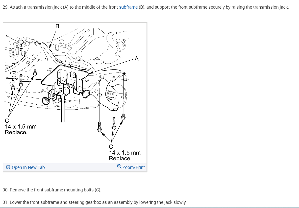

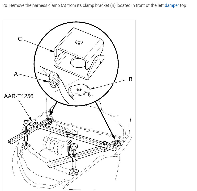

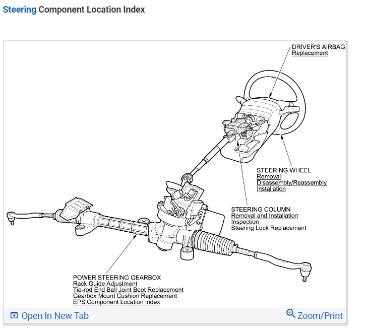

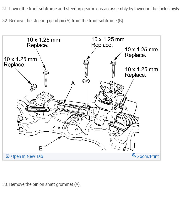

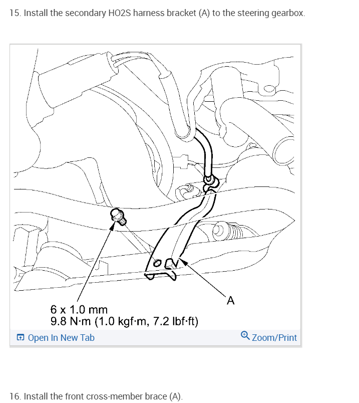

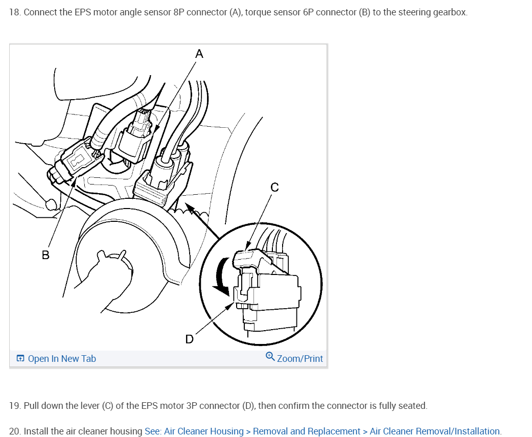

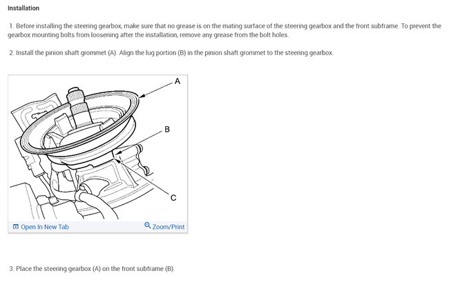

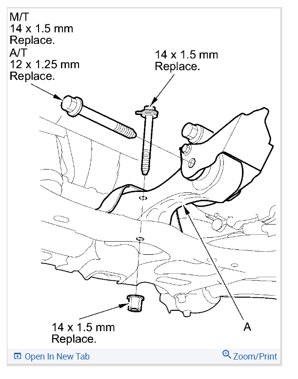

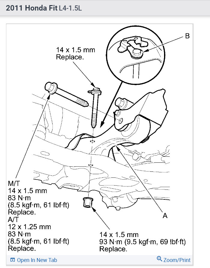

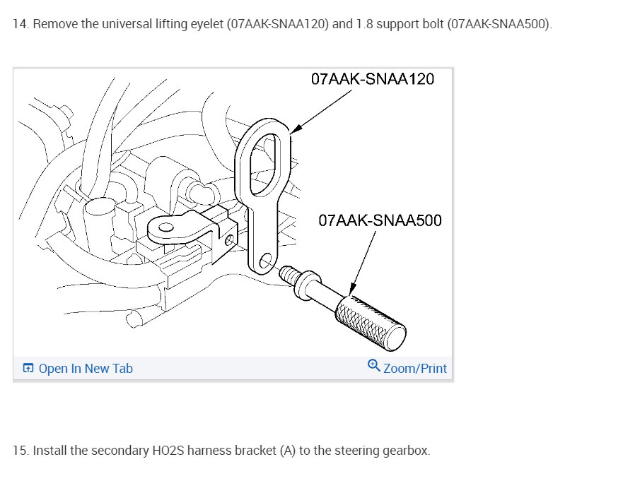

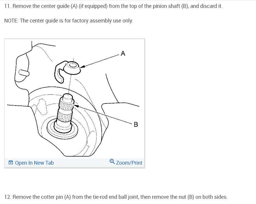

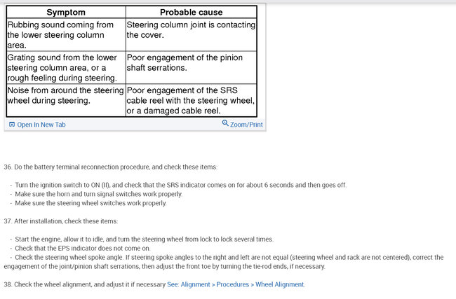

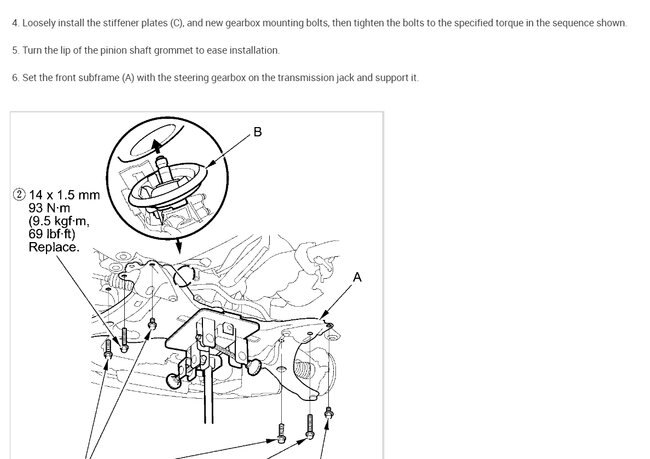

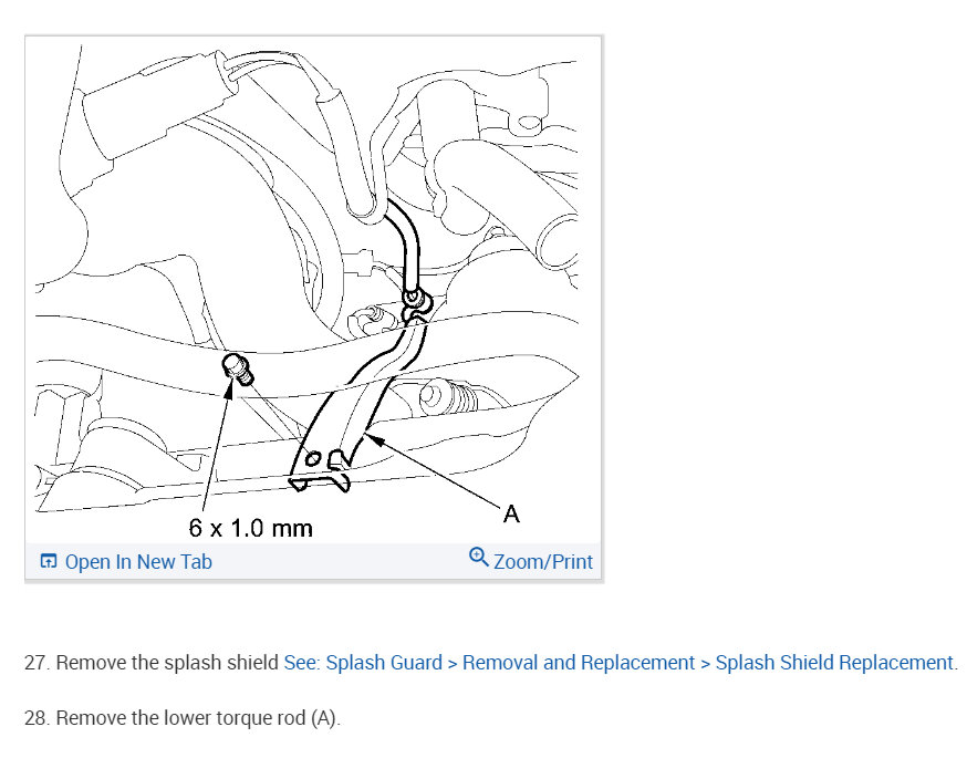

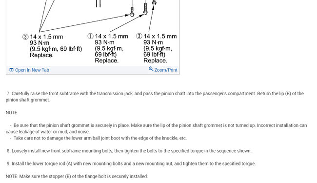

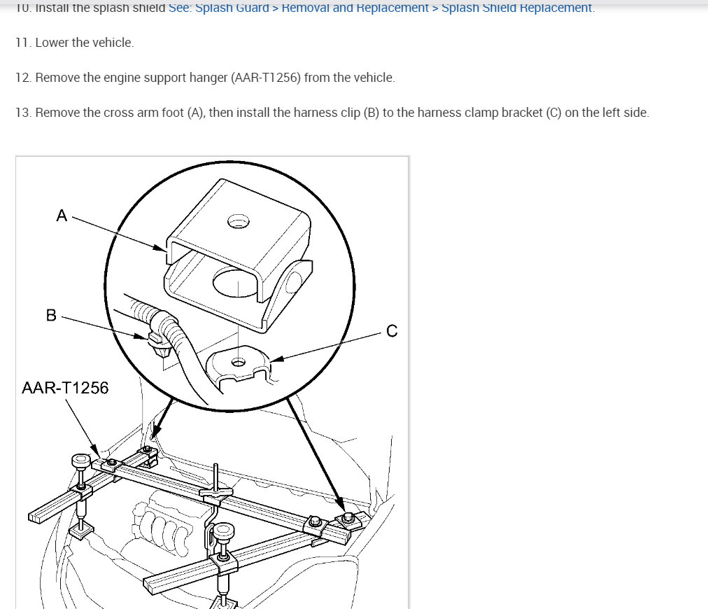

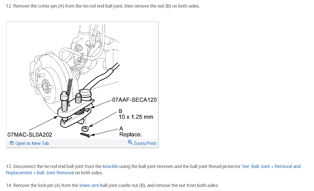

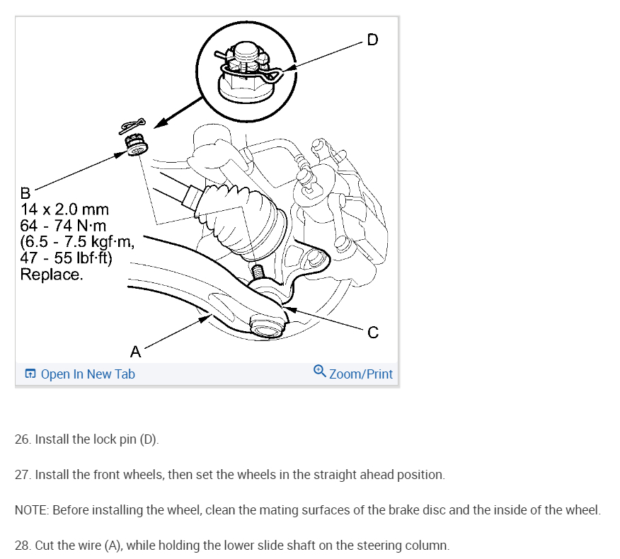

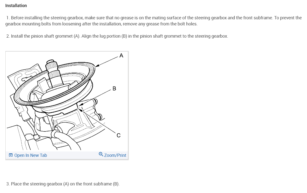

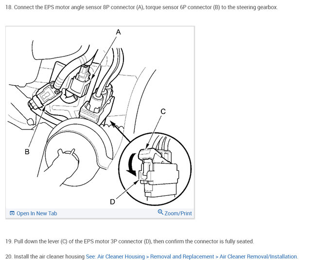

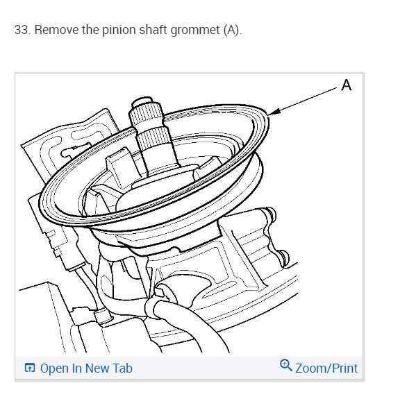

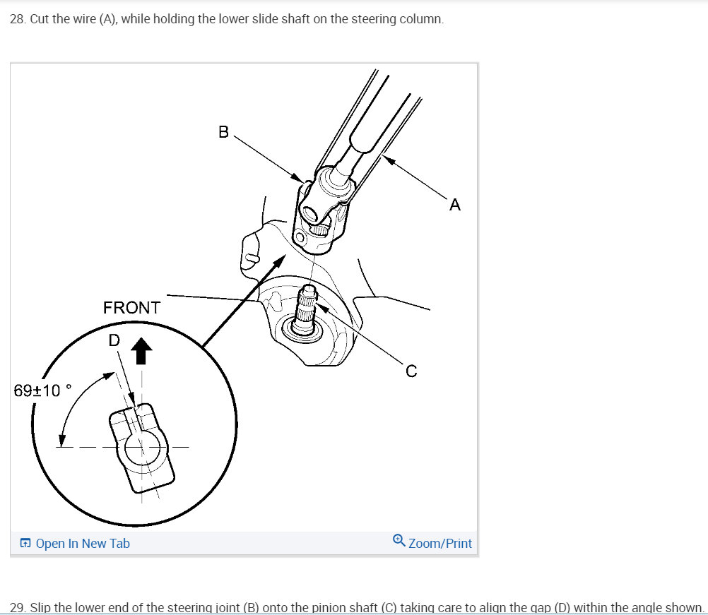

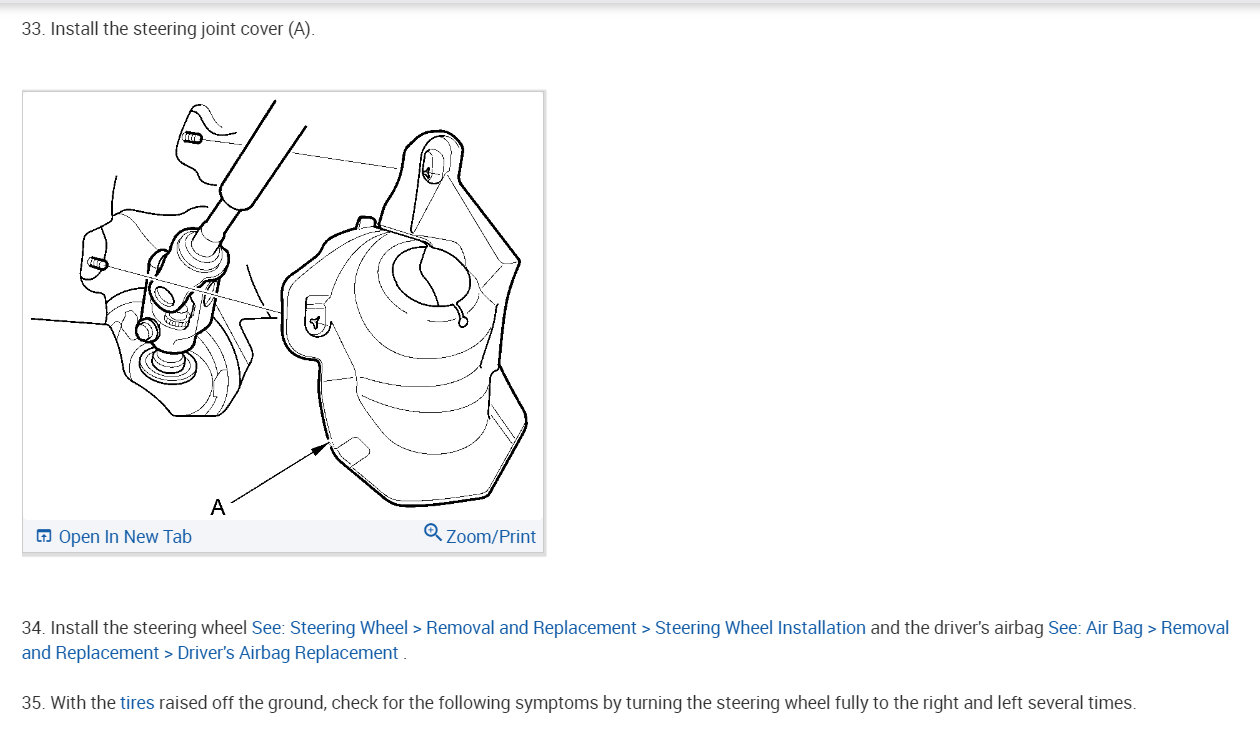

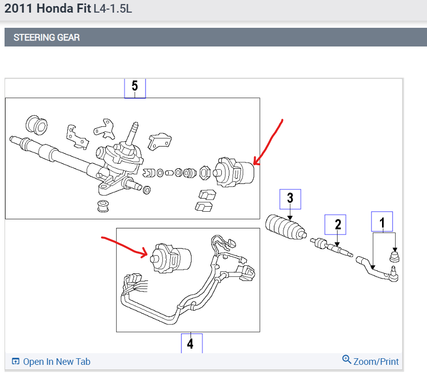

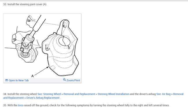

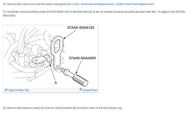

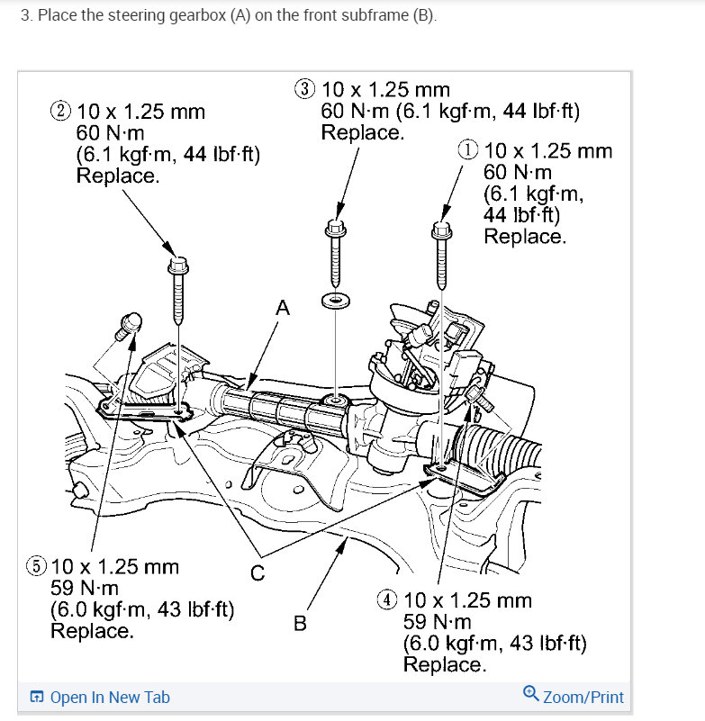

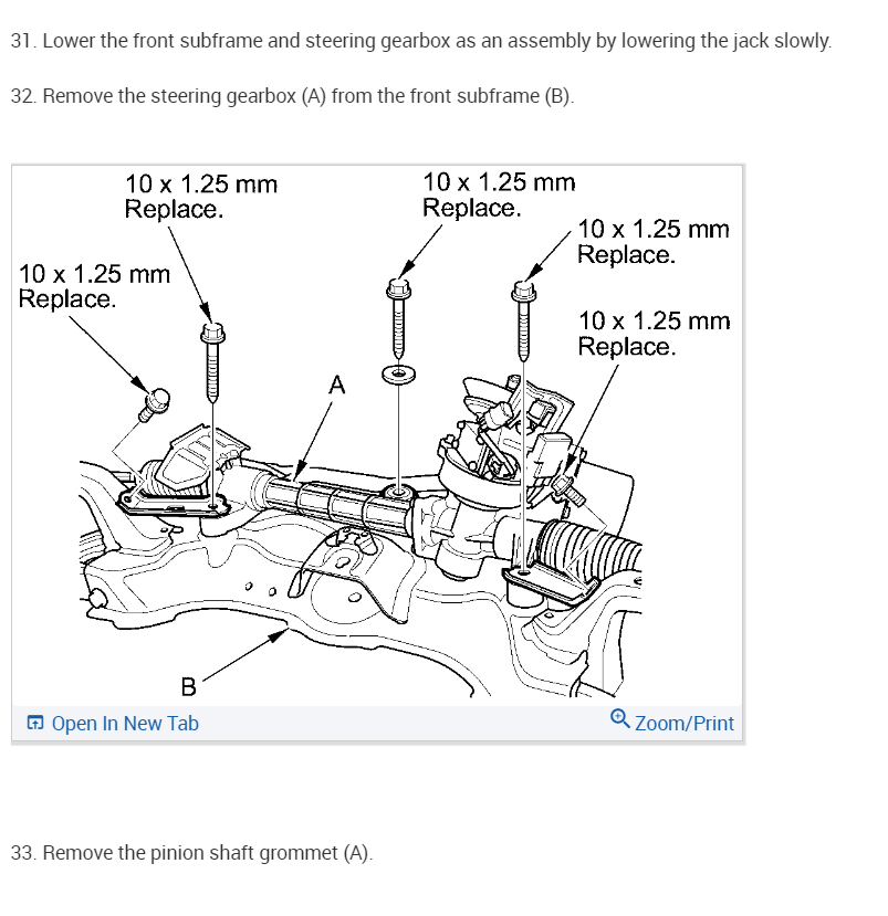

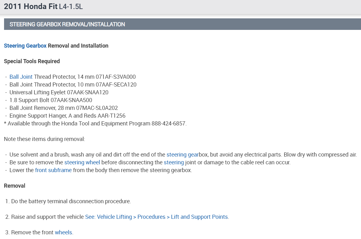

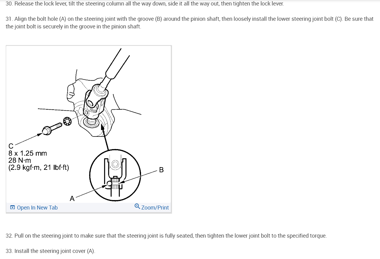

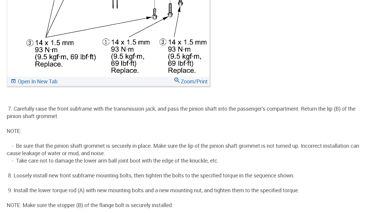

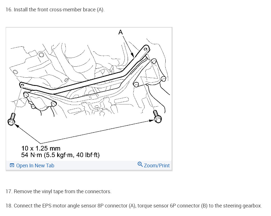

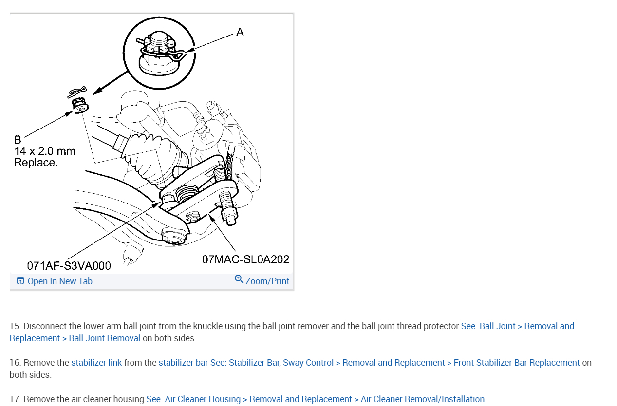

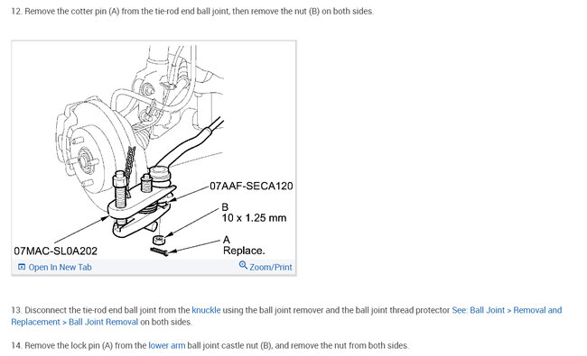

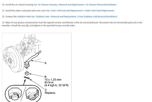

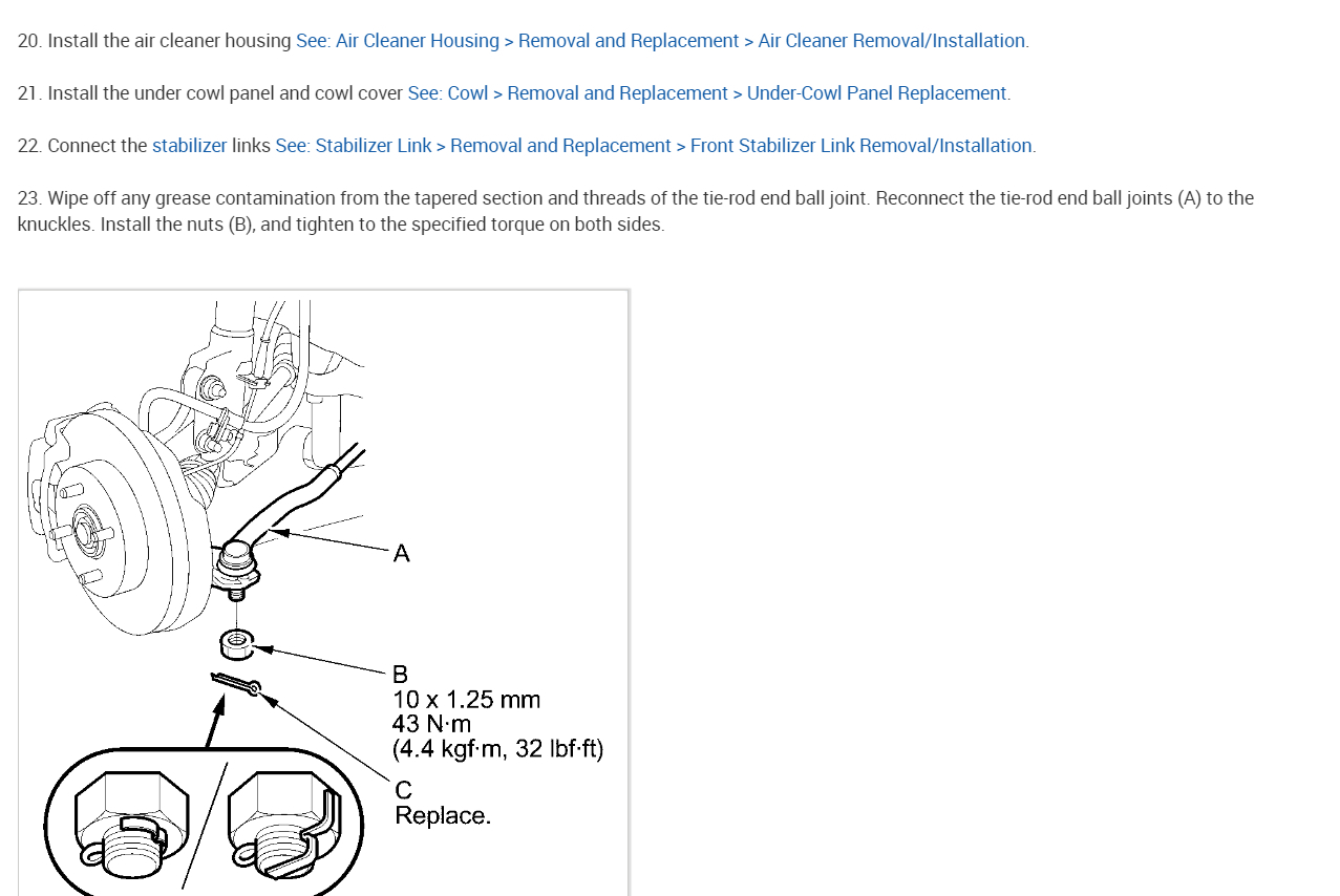

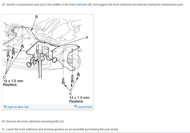

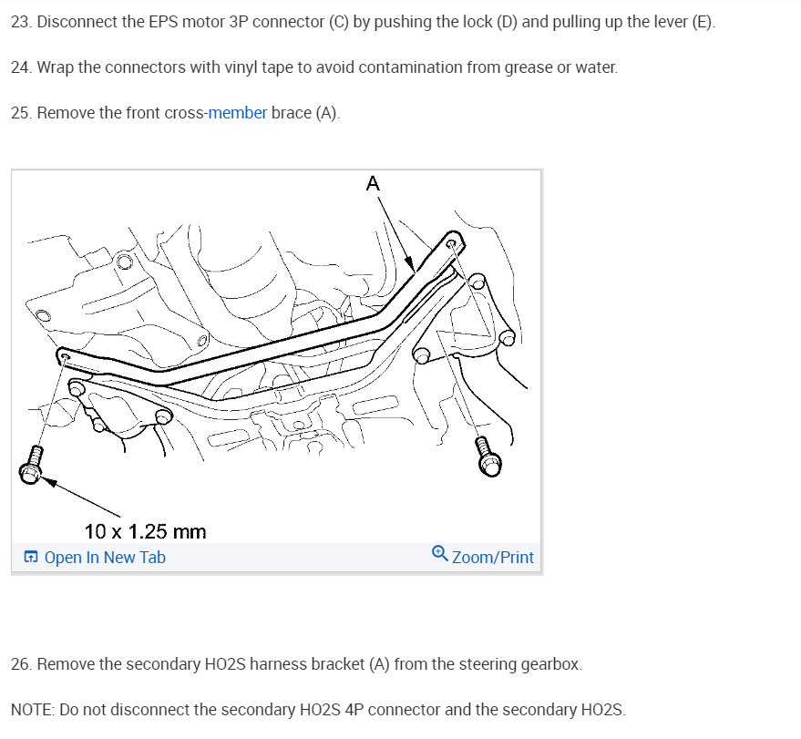

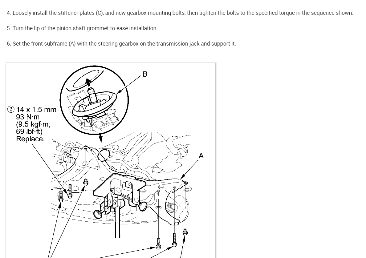

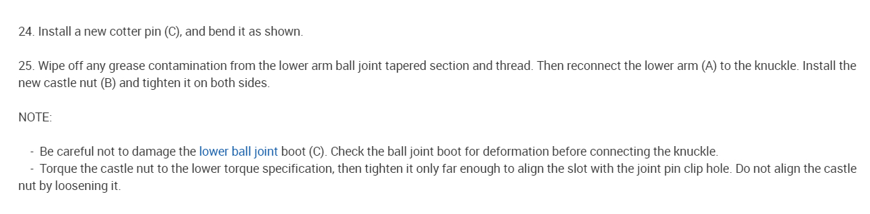

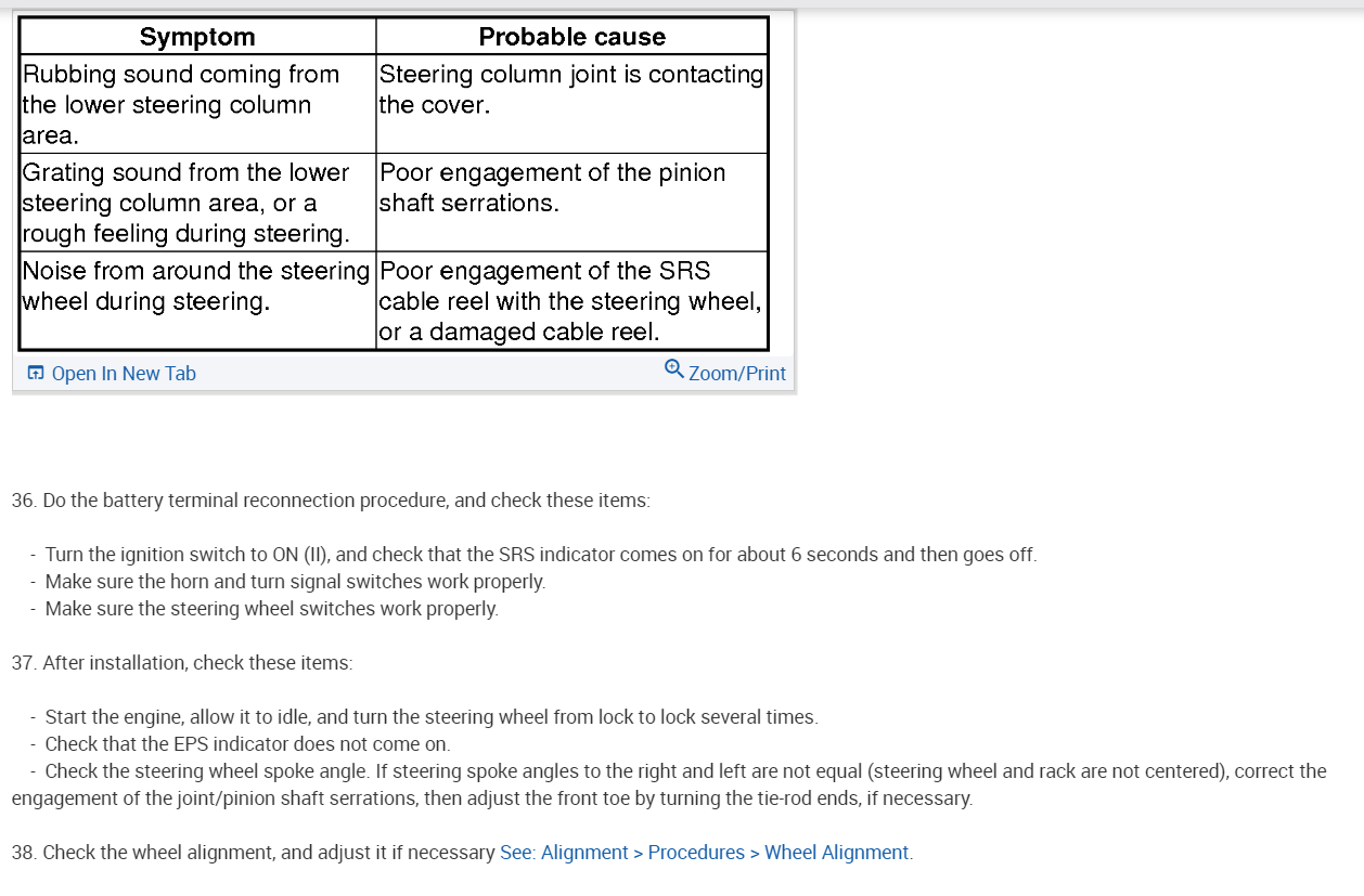

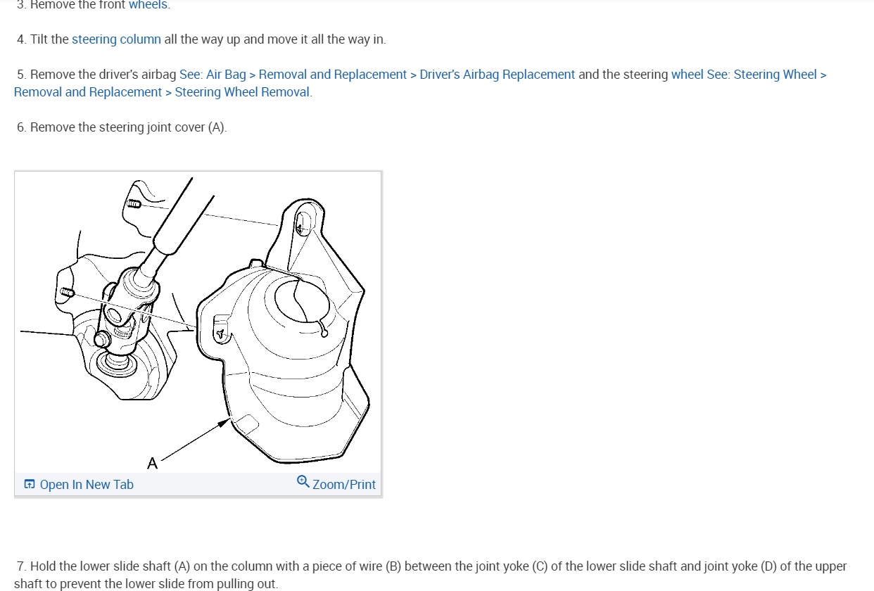

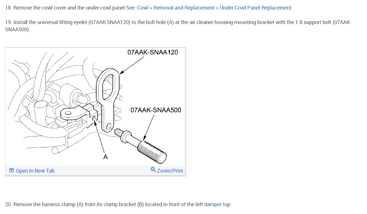

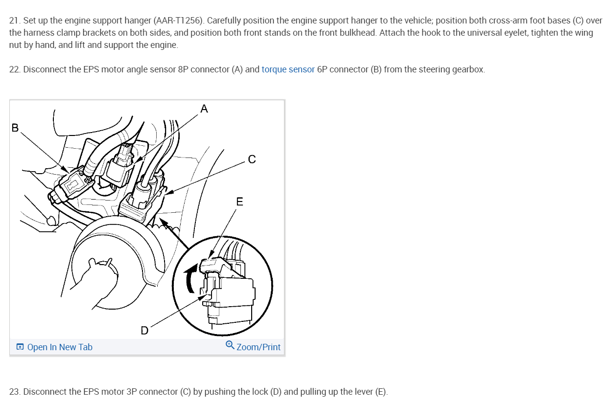

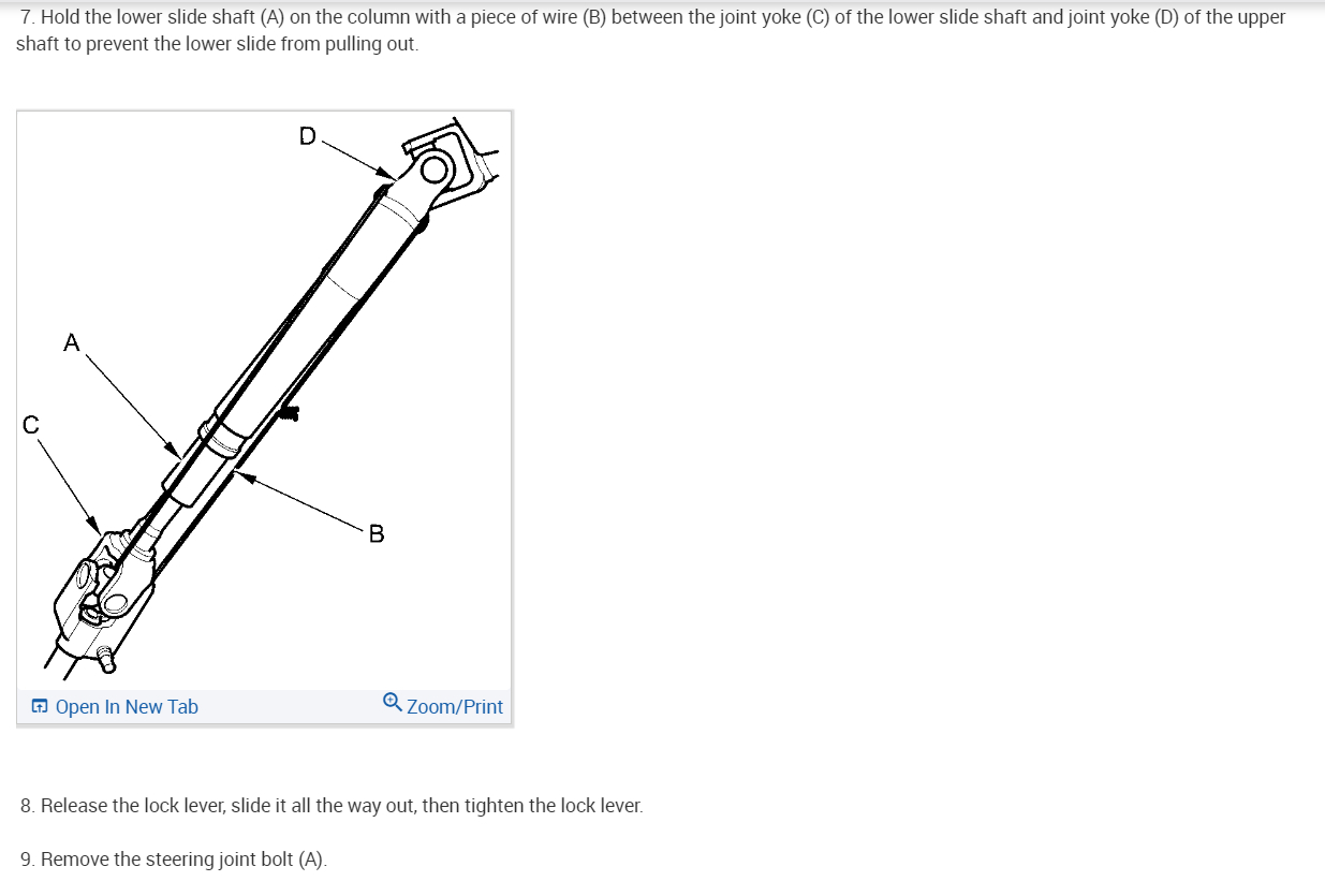

So, this happens when the electric motor inside the steering rack is shorted out. here is how to change the rack out, I would get a new or rebuilt unit to install. Check out the images (below). Let us know what happens and please upload pictures or videos of the problem so we can see what's going on.
