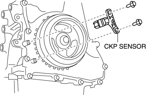

4. Disconnect the CKP sensor connector.
5. Remove the CKP sensor.
pic 1

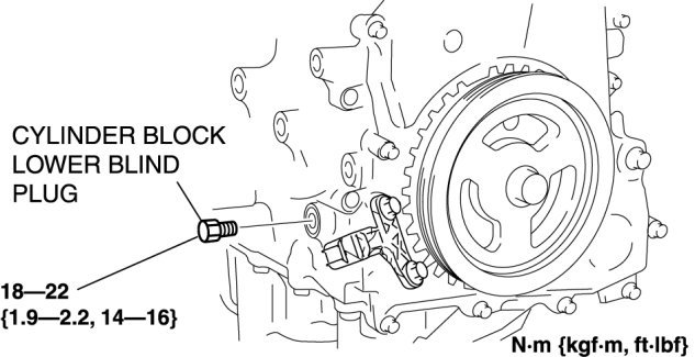

c. Remove the cylinder block lower blind plug and install the SST.
pic 2

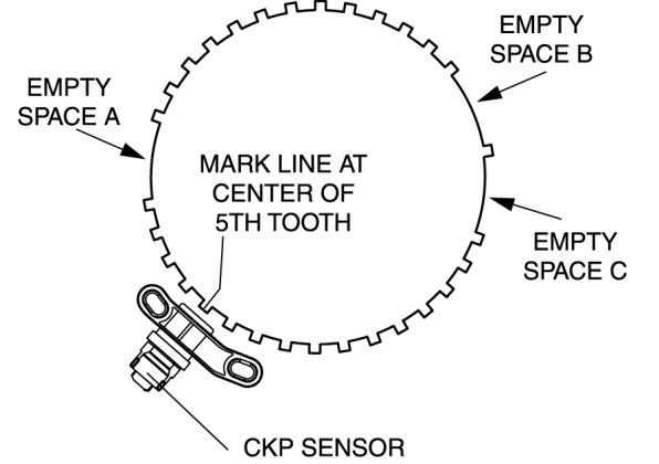

2. Fit the center of the CKP sensor with the fifth tooth (counting counterclockwise from the empty space A as shown in the figure) of the pulse wheel.
pic 3

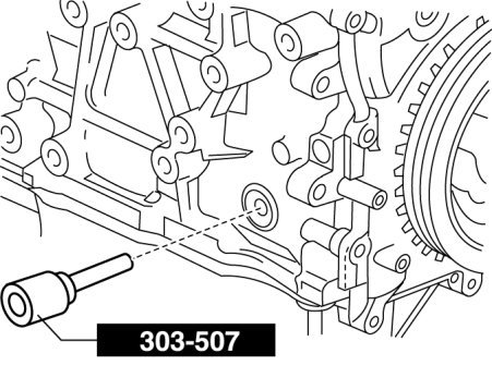

3. Install the CKP sensor fitting bolts.
pic 4

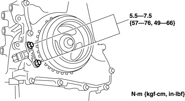

4. Remove the SST then install the cylinder block lower blind plug.
pic 5
