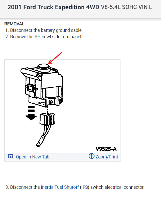

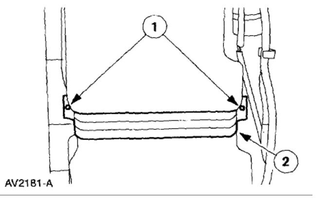

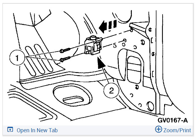

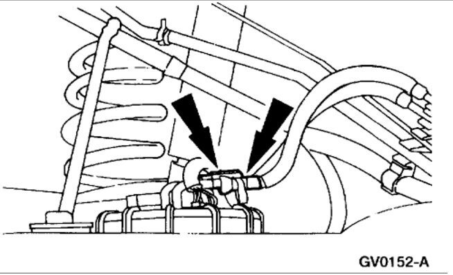

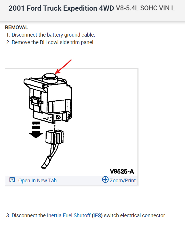

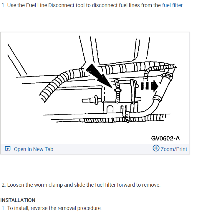

So, if you push the throttle the engine will keep running? Can I get a short video of the engine running it would help, also, I would drain the tank because the gas is bad, adding fresh fuel may not help. Also, make sure the inertia switch is pushed down, here is the location.

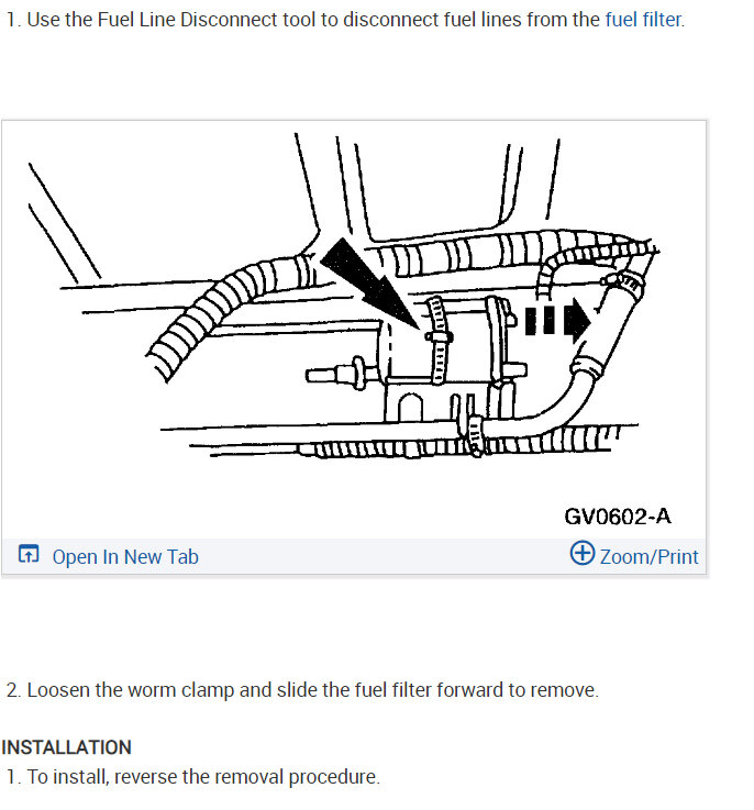

I would swap out the fuel filter after the fuel drain, this video should help:
https://www.youtube.com/watch?v=Q5MH2gnyFH0&t=32s

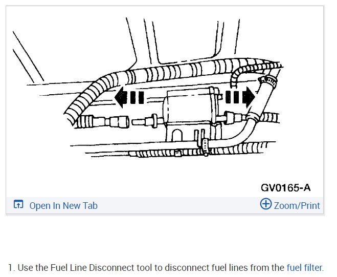

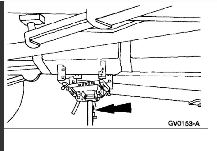

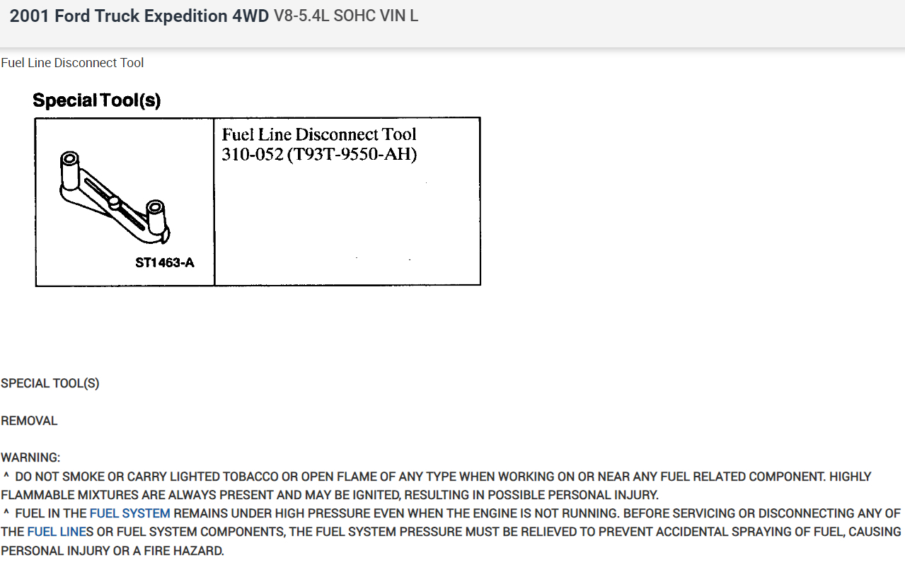

Also, can you hear the fuel pump running in the tank when you switch the key on but not start the engine? Here are the fuel filter and inertia switch locations.

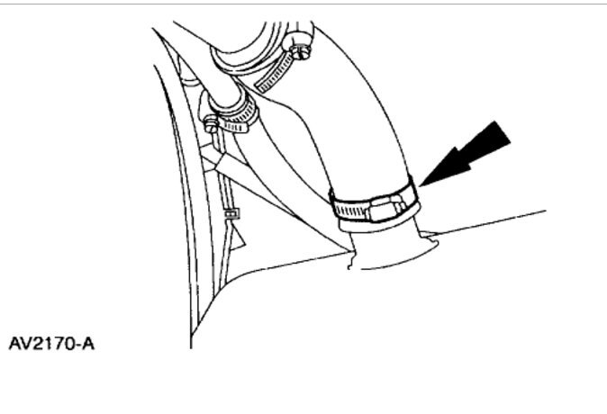

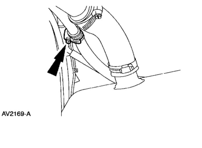

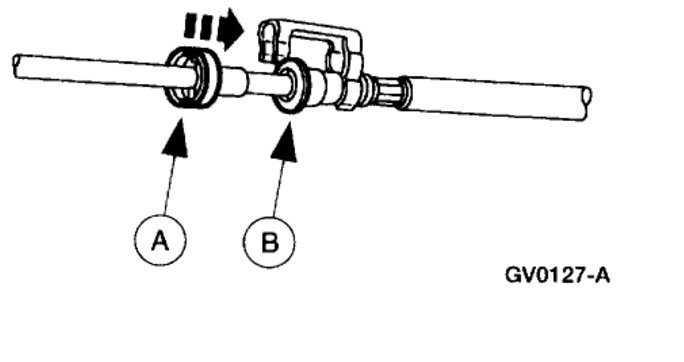

Here is how to remove the ford fuel lines:
https://www.youtube.com/watch?v=U0XdsQkq-b4
Check out the images (below). Let us know how it goes.

Checked inertia switch, it was in the down position. I don't hear the fuel pump humming when I turn the key to the on position. Bought a fuel filter and quick release tool. When i get paid I will buy a pump to empty the tank with and a few fresh gallons of gas. I'll then replace the filter and try to start it up with starting fluid. I will reply back again after that if it works or not, and if it doesn't work, I'll attach a video. Do i need to do anything to depressurize the lines before installing the new filter?
Oct 12, 2024 at 7:01 AM

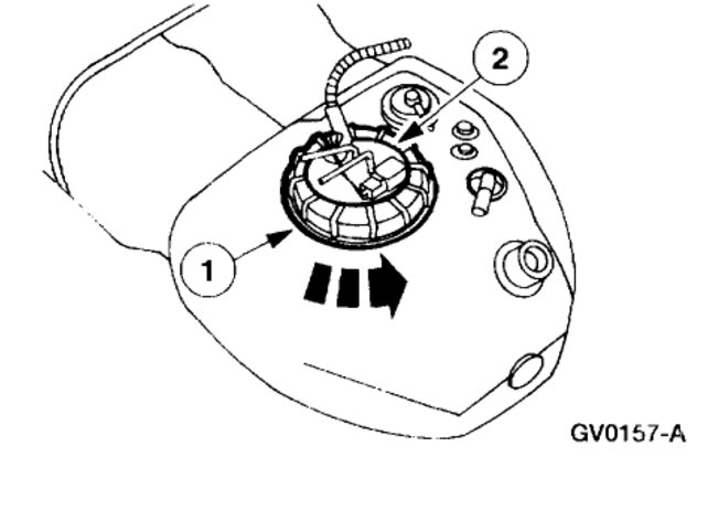

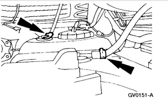

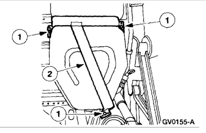

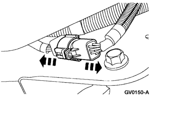

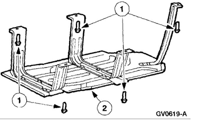

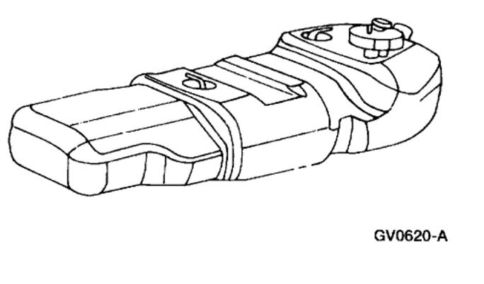

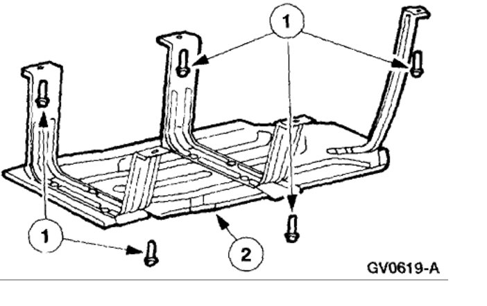

Not really, a little bit of fuel will come out when you change the fuel filter so have a fluid catch basin ready. Also loosen the gas cap. Here us how to change the pump out in case you need it. Be sure to drain the tank first.
https://www.youtube.com/watch?v=Q5MH2gnyFH0&t=35s
