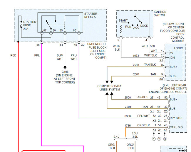

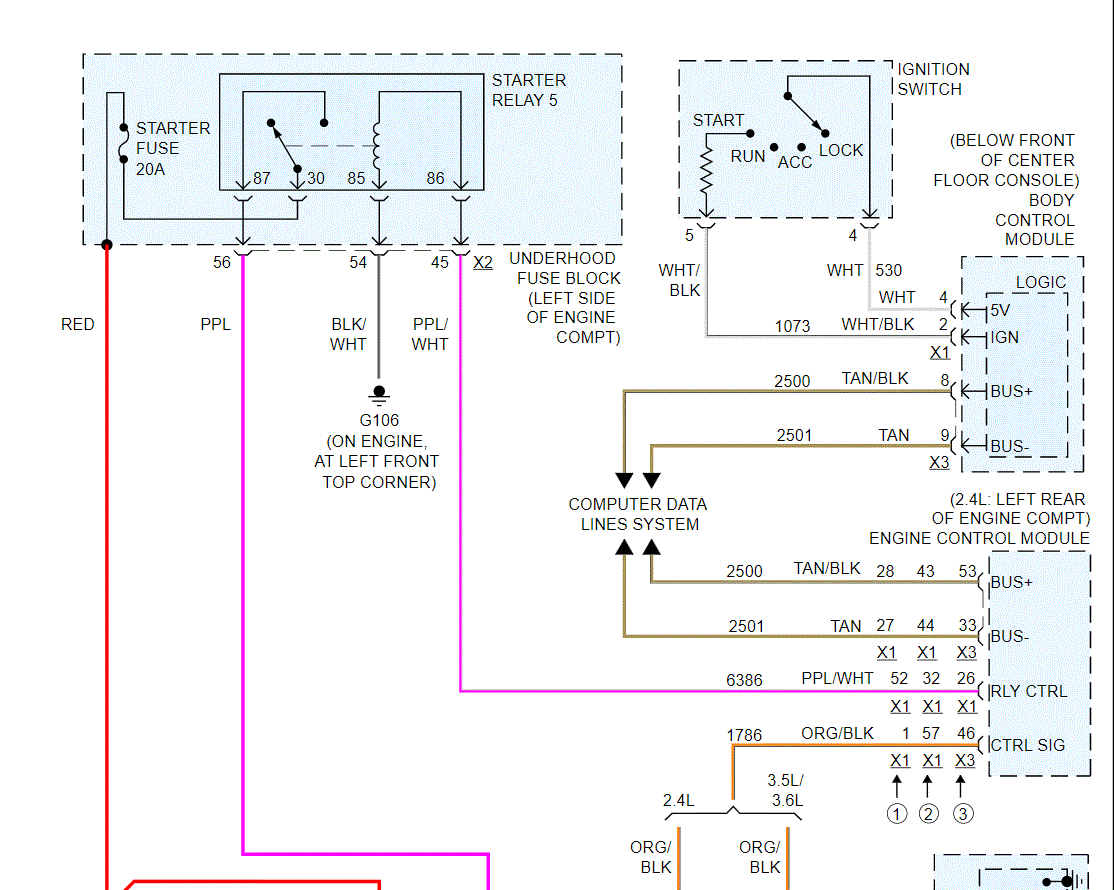

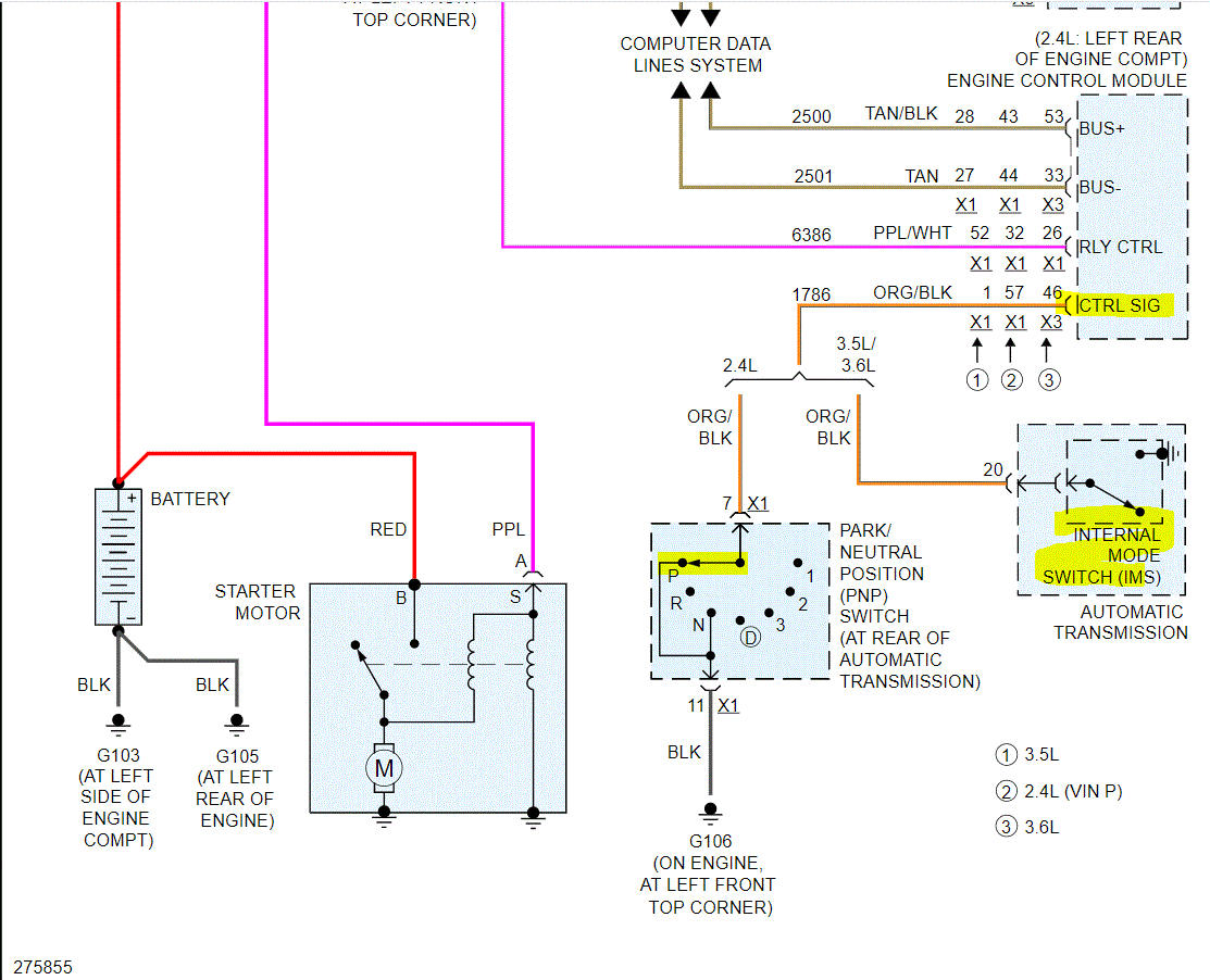

I attached the wiring schematic below for the starting system. Note that there are communication lines running between the body control module and the engine control module. If I had to guess, there is a problem with communication between the two, but the only way to tell is to scan the system.
Let me know your thoughts or if you have other questions. If you have this done, let me know what diagnostic trouble codes are found.
