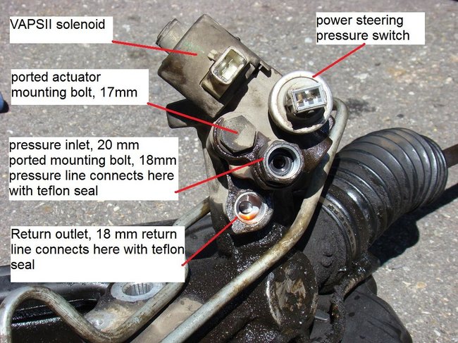

Have steering assist light and car shuts off when i turn.

If possible,retrieve the codes from the power steering module.Either the power steering circuit or the pressure switch could be bad. These are the most common faults. The pressure switch is on the rack, reference the attached picture.
