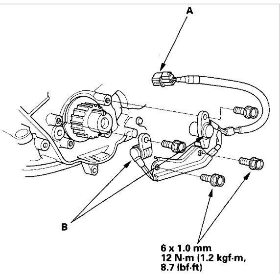

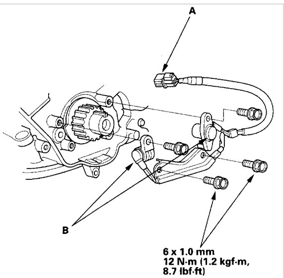

So this code comes up when the crankshaft position sensor needs to be replaced or the connector/wiring checked. Here is the location of the sensor:
P1382 - Cylinder Position (CYP) Sensor No Signal

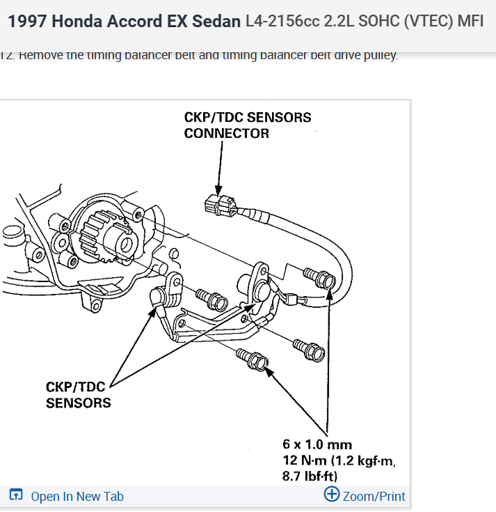

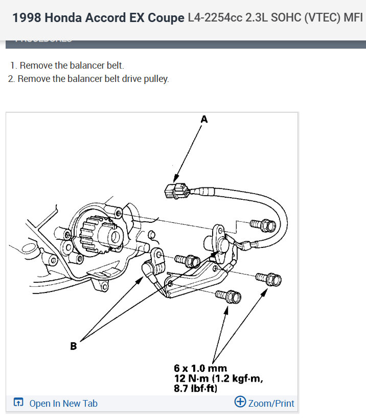

Hmm, I don't think I am wrong, please check the images again. I even checked 1997 model year.
