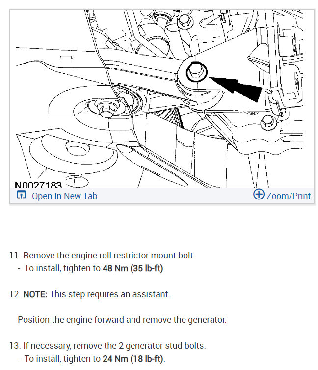

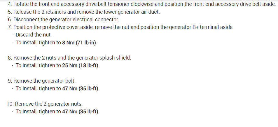

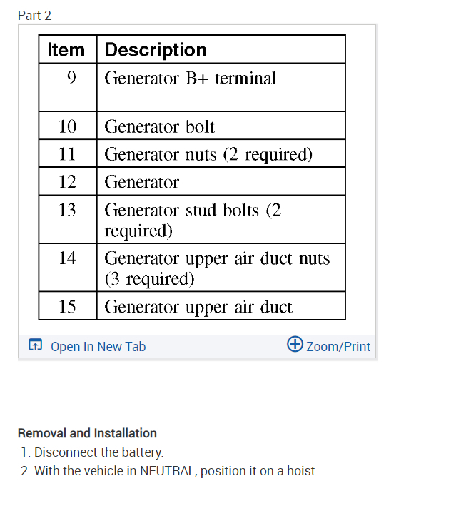

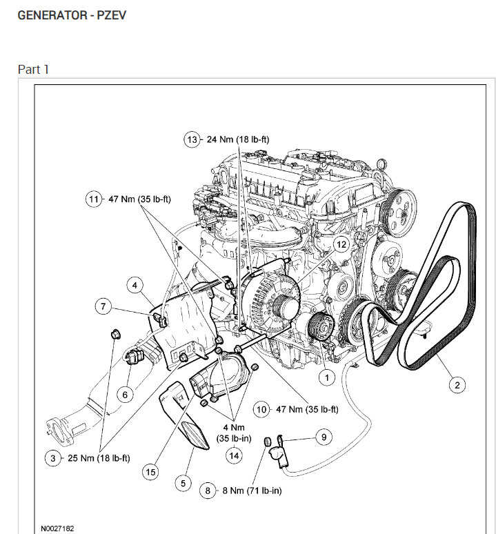

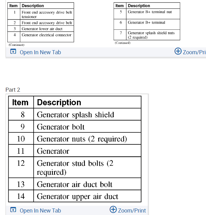

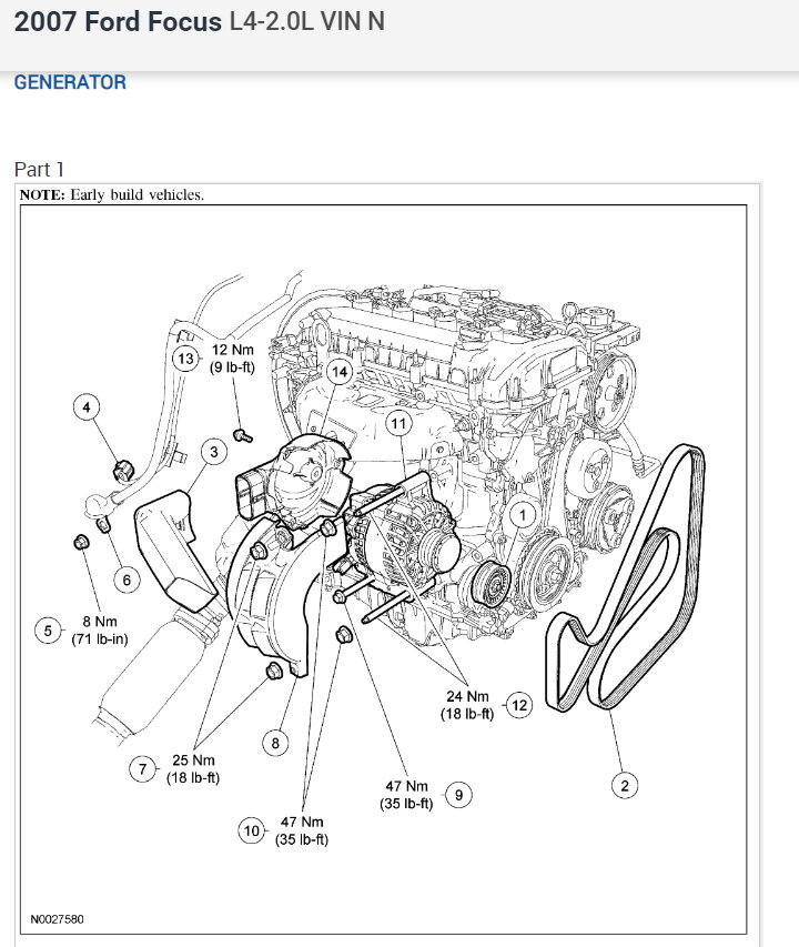

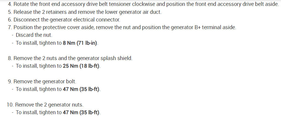

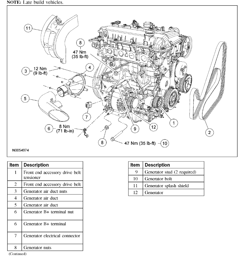

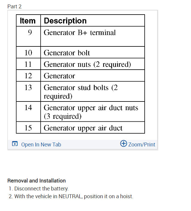

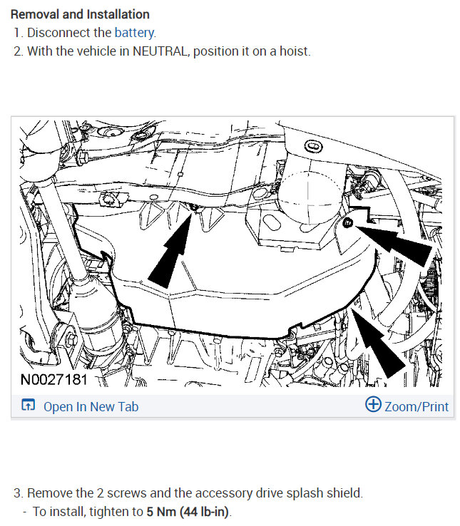

It does sound like the alternator is not working. To be sure when the engine is running let use a voltmeter to check it. This guide will show you how. The battery light may not go on all the time if the alternator is not working.
If while running the voltage is below 12.6 volts the alternator is bad. Sometimes a bad battery can take out the alternator. FYI. Here is how to remove the alternator in case you need it. Check out the images (below). Please upload pictures or videos in your response to the problem so we can see what's going on.
