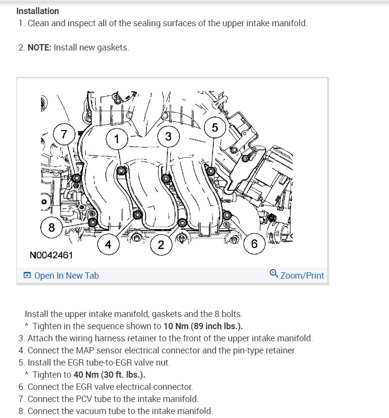

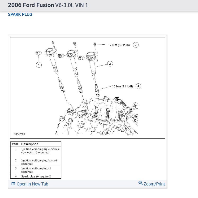

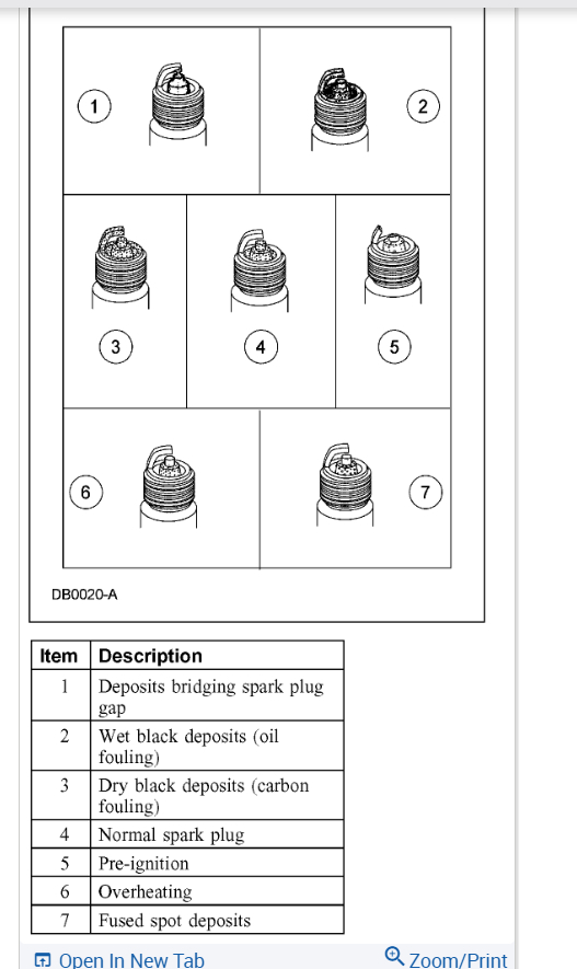

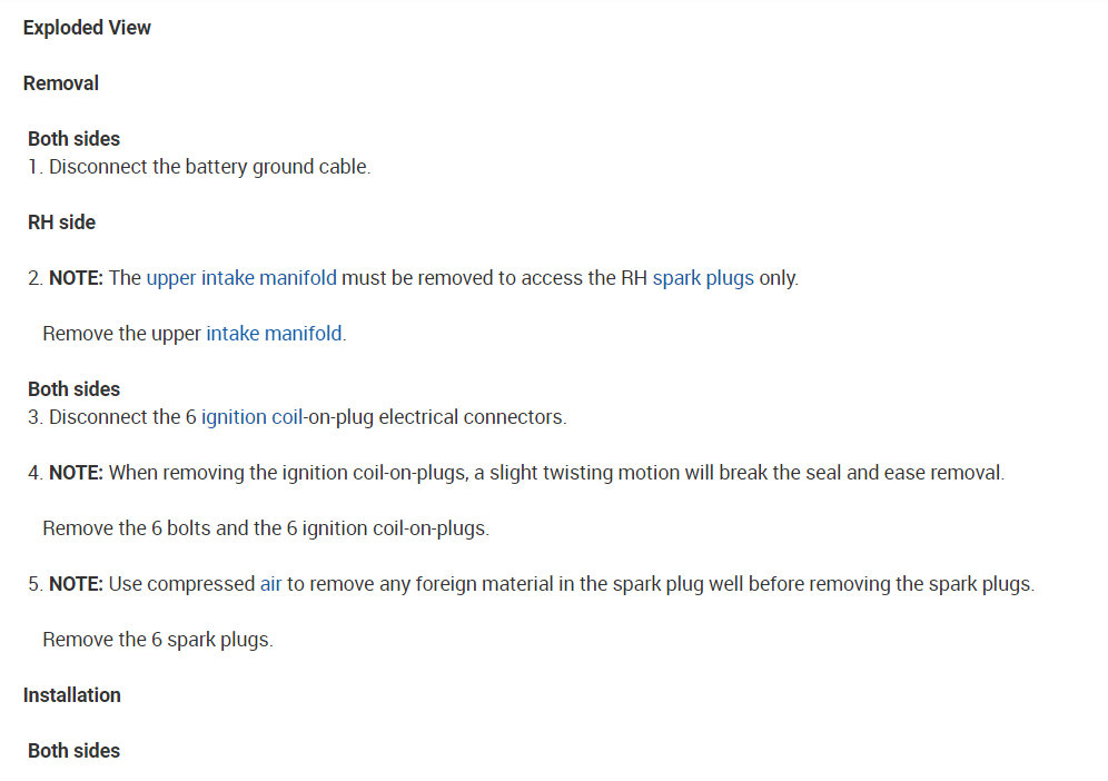

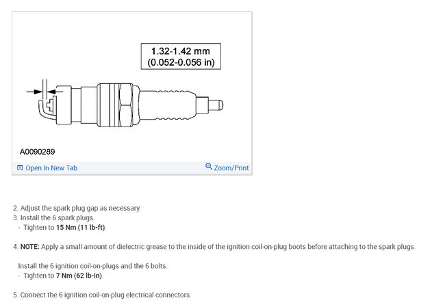

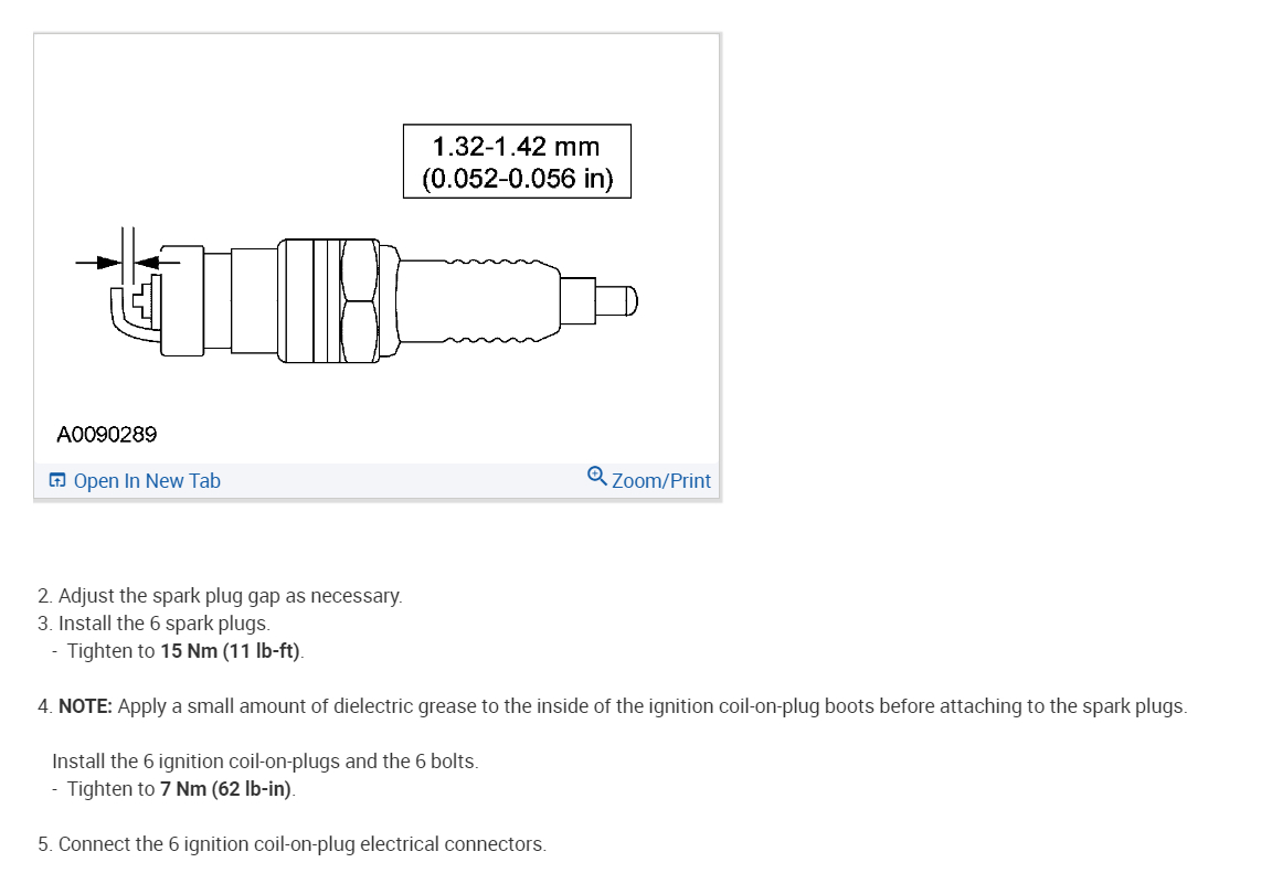

This sounds more like a misfire problem; I would replace all spark plugs and the remainder of the ignition coils. Here is a generic guide to help you change out the spark plugs with instructions below to help you with your car:
https://www.2carpros.com/articles/how-to-change-spark-plugs
Spark Plug .................... AGSF-32WM

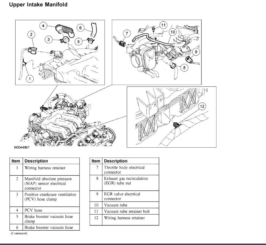

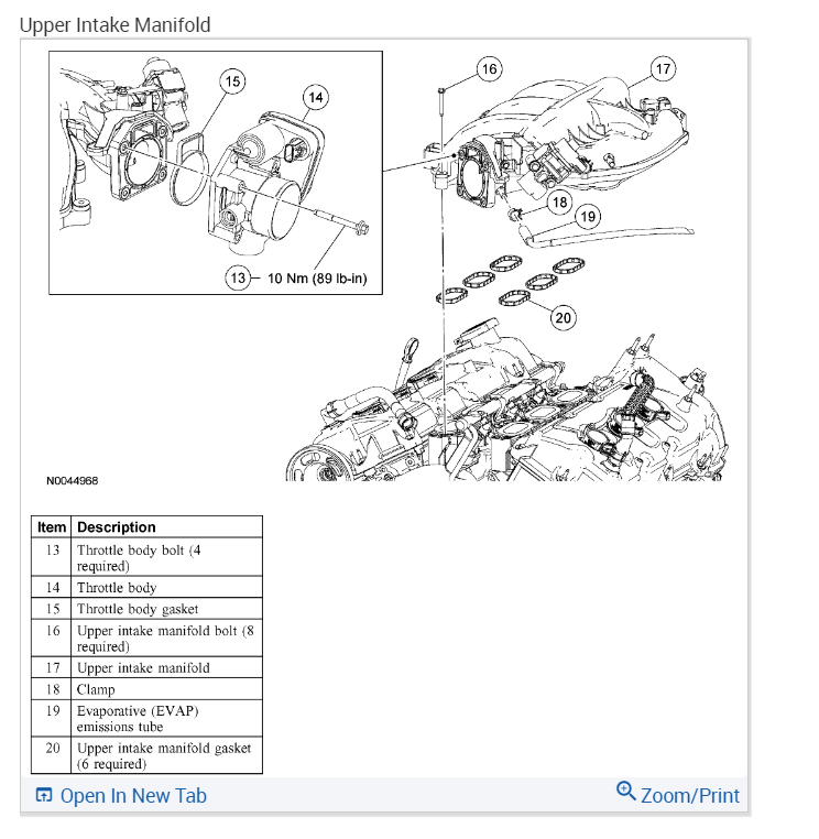

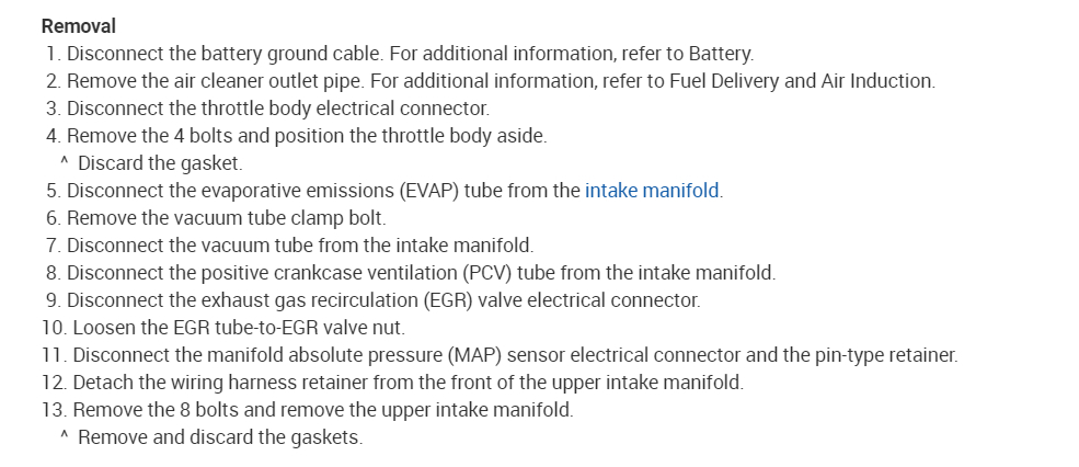

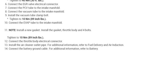

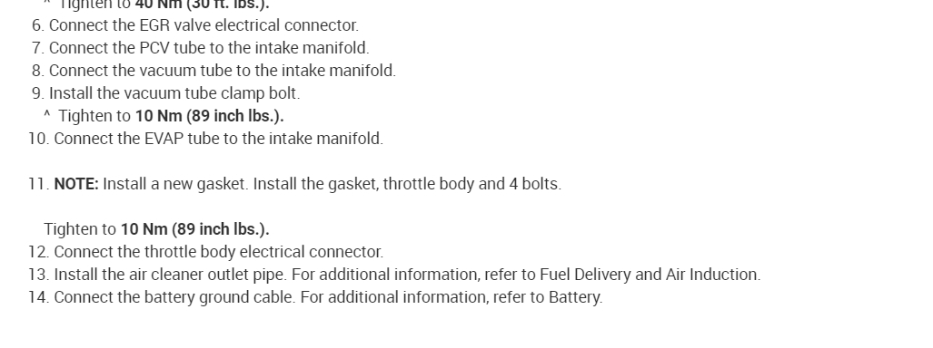

You must remove the upper intake manifold which I have included as well. I would also service the throttle bore.
here is a guide to help you:

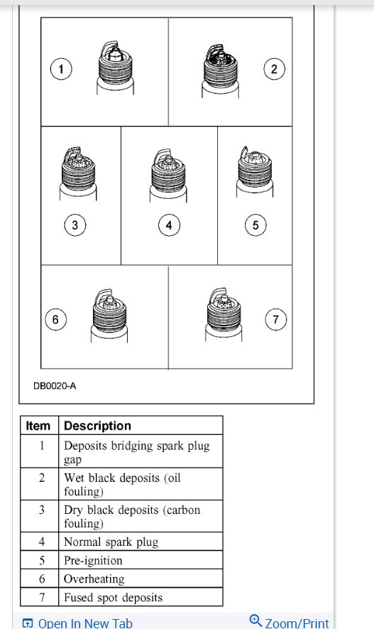

Check out the images (below). Let us know what happens and please upload pictures or videos of the problem.
