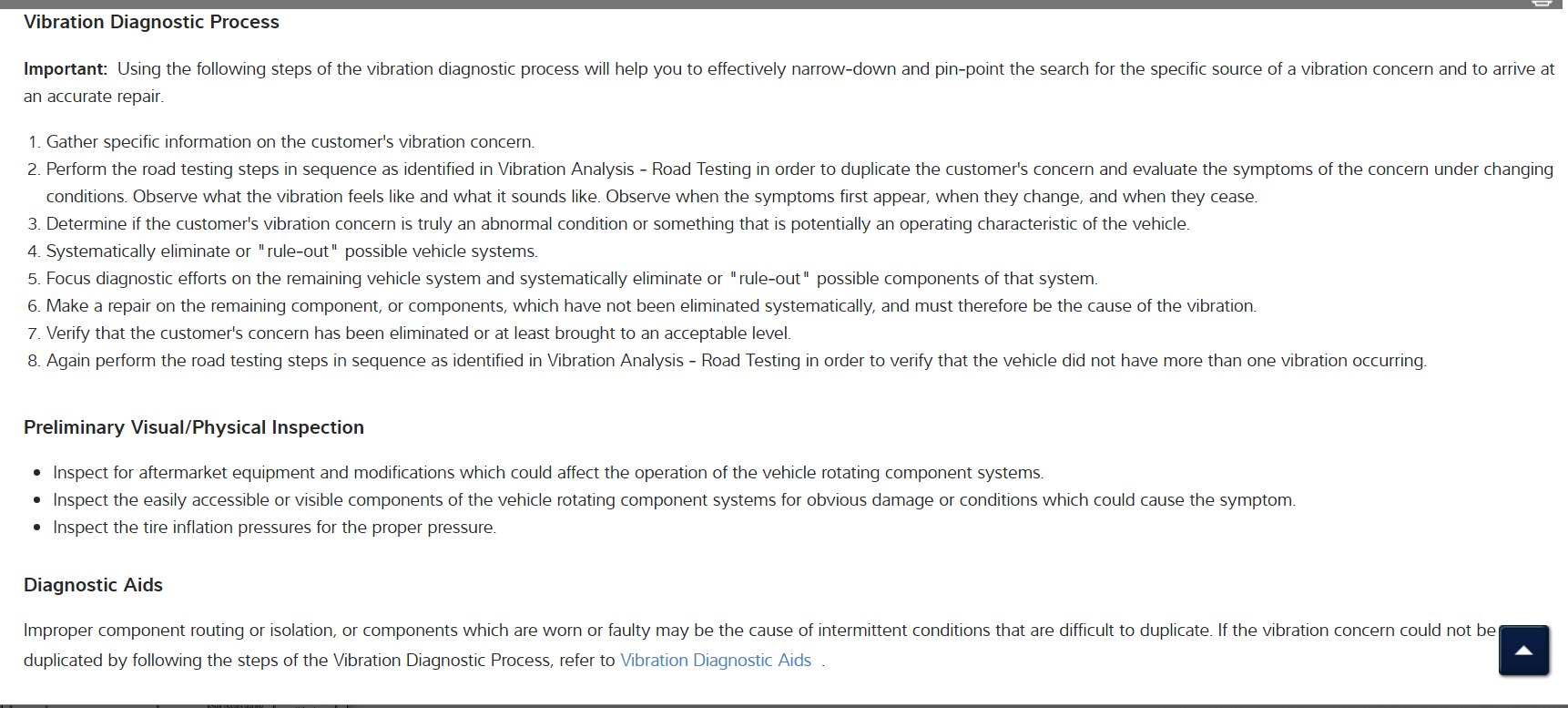

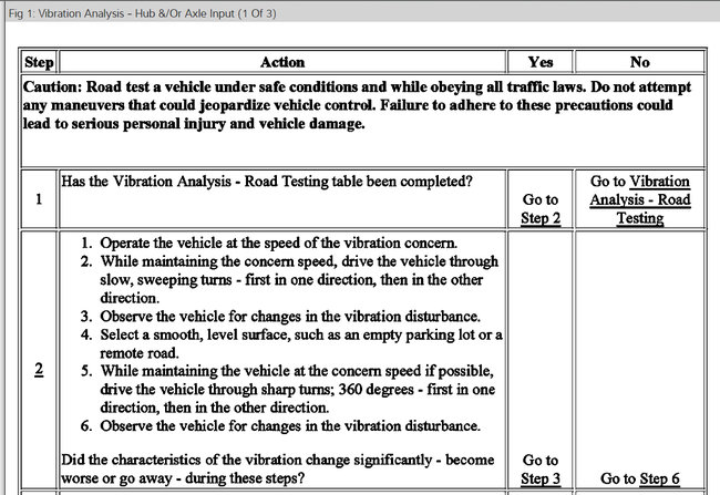

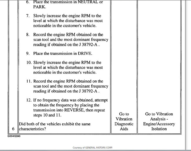

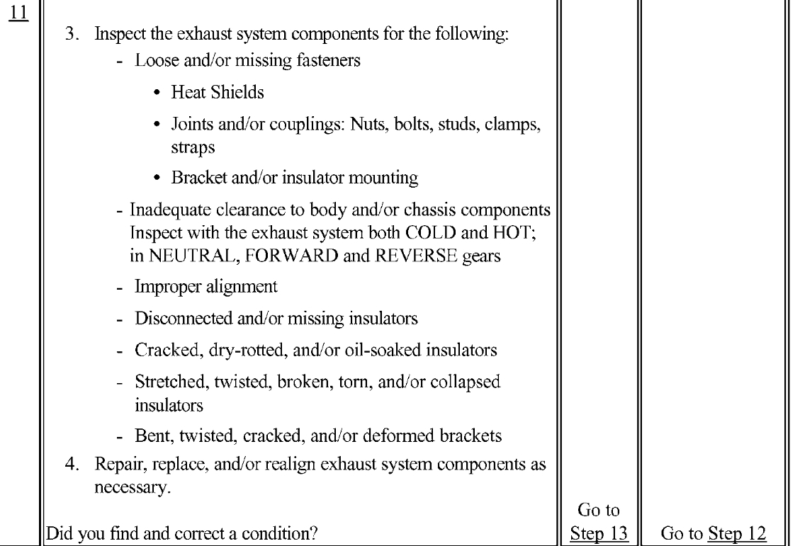

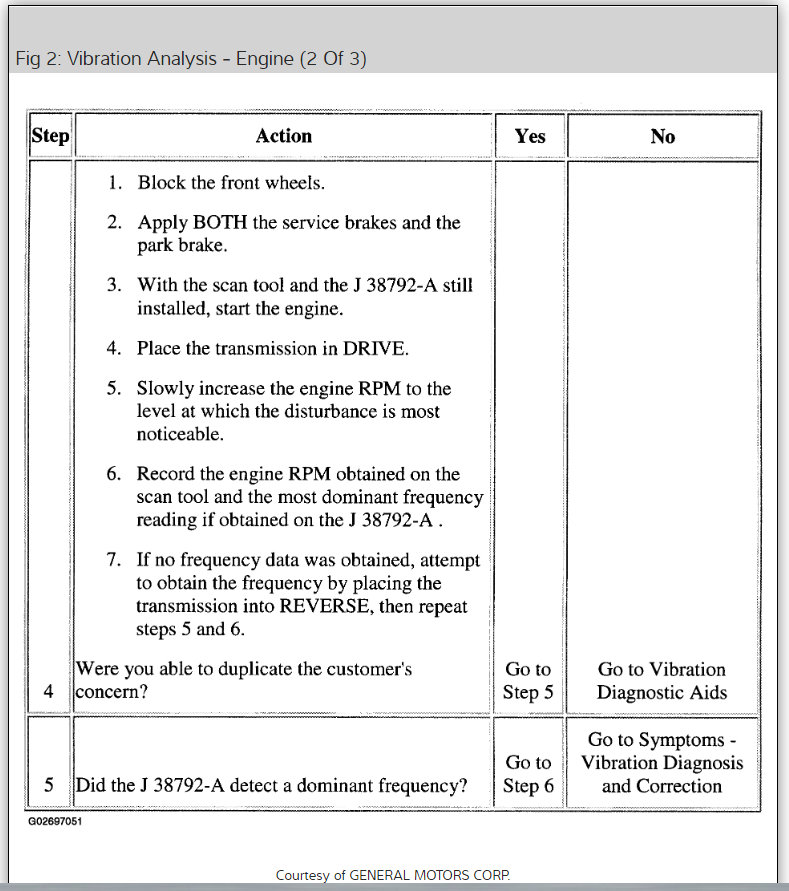

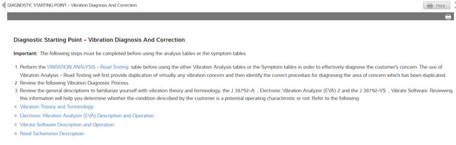

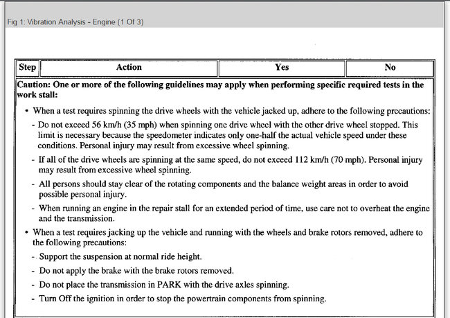

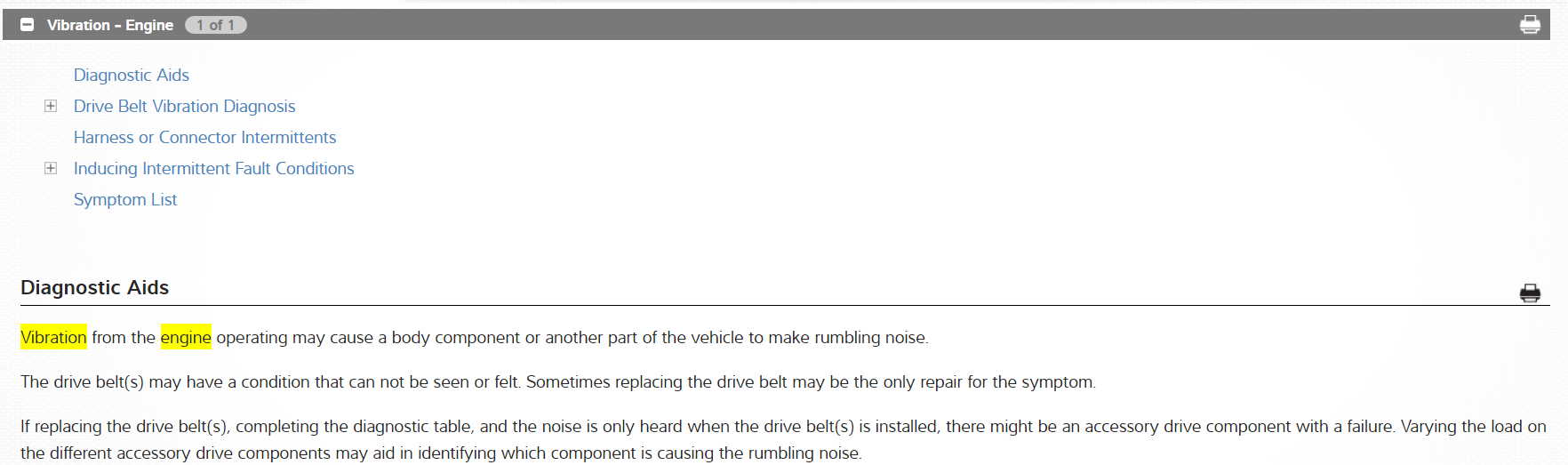

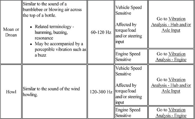

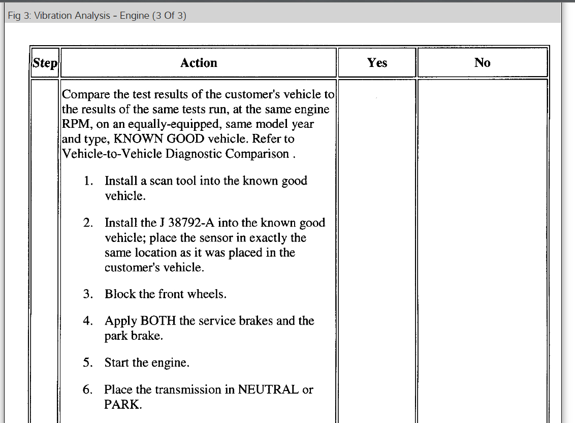

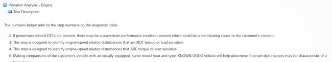

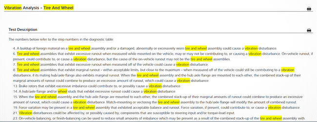

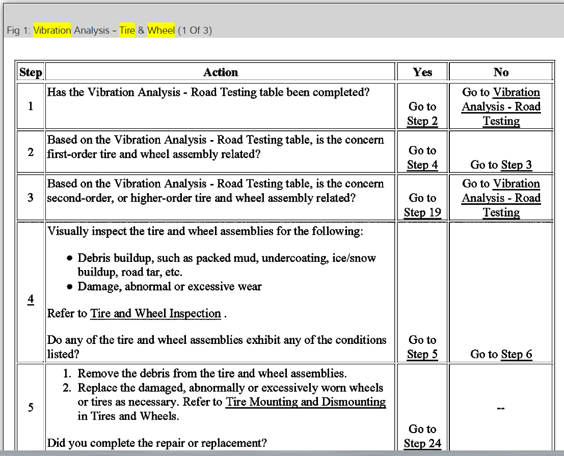

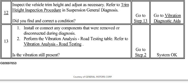

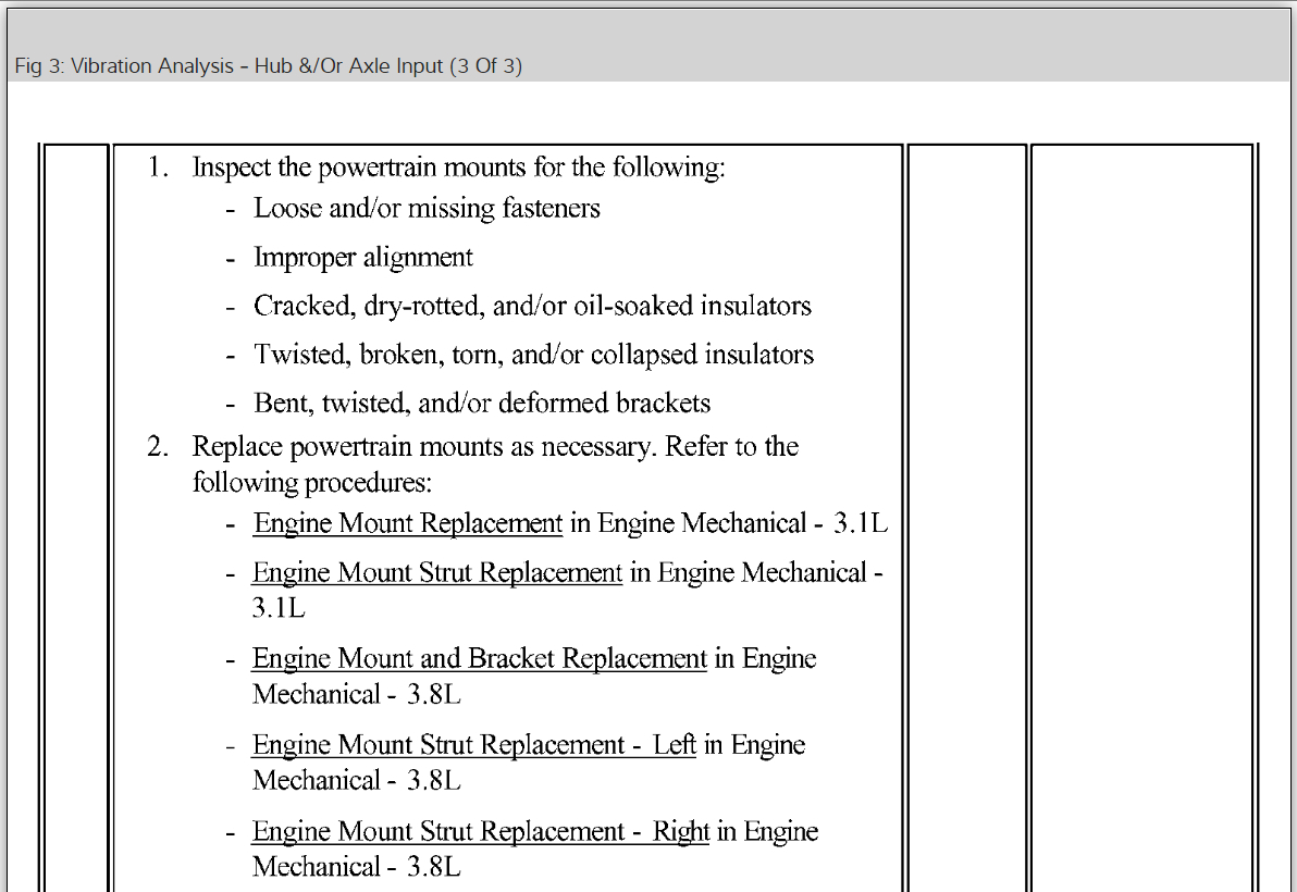

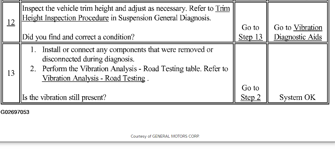

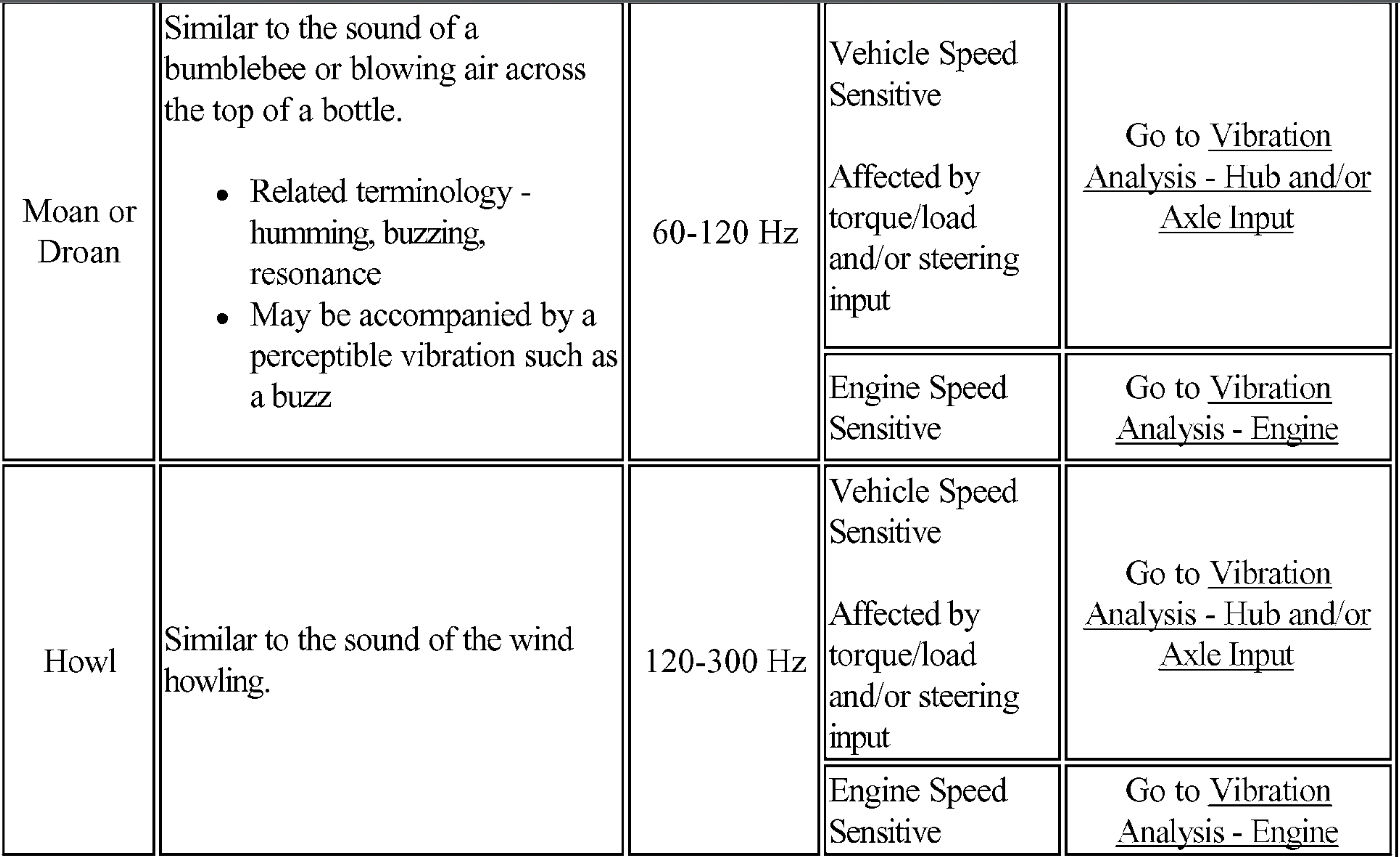

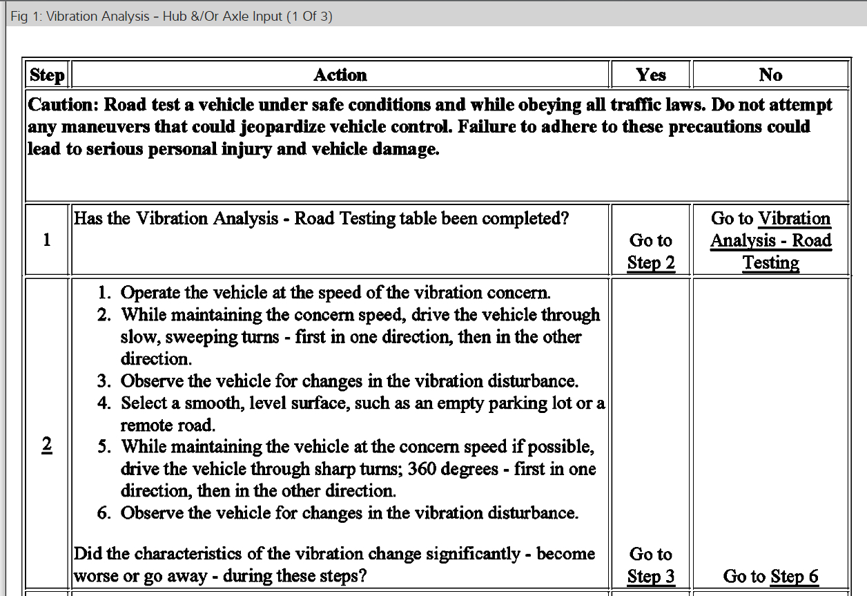

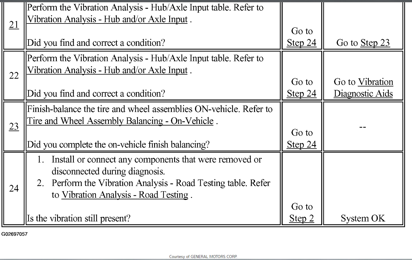

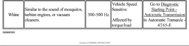

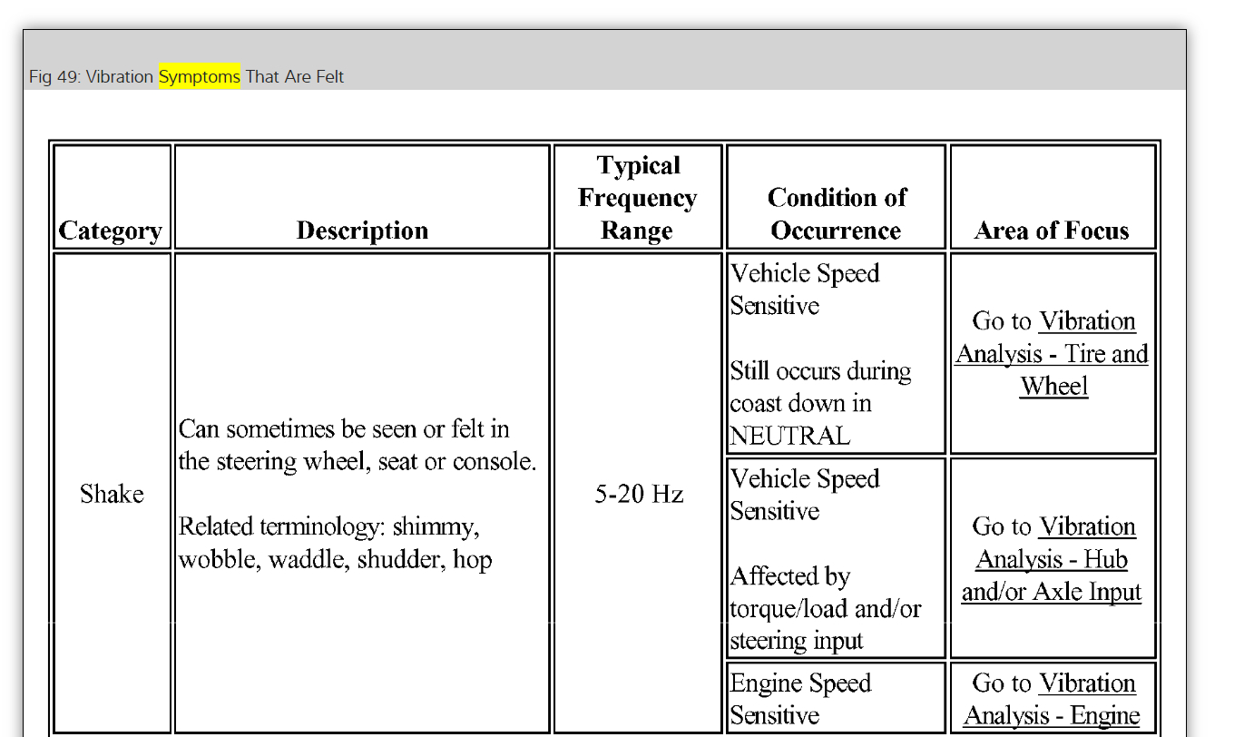

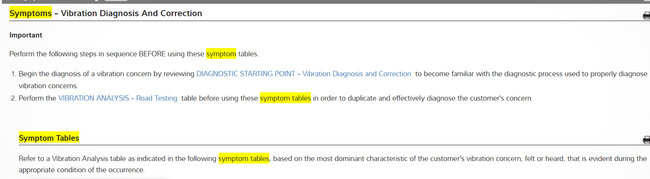

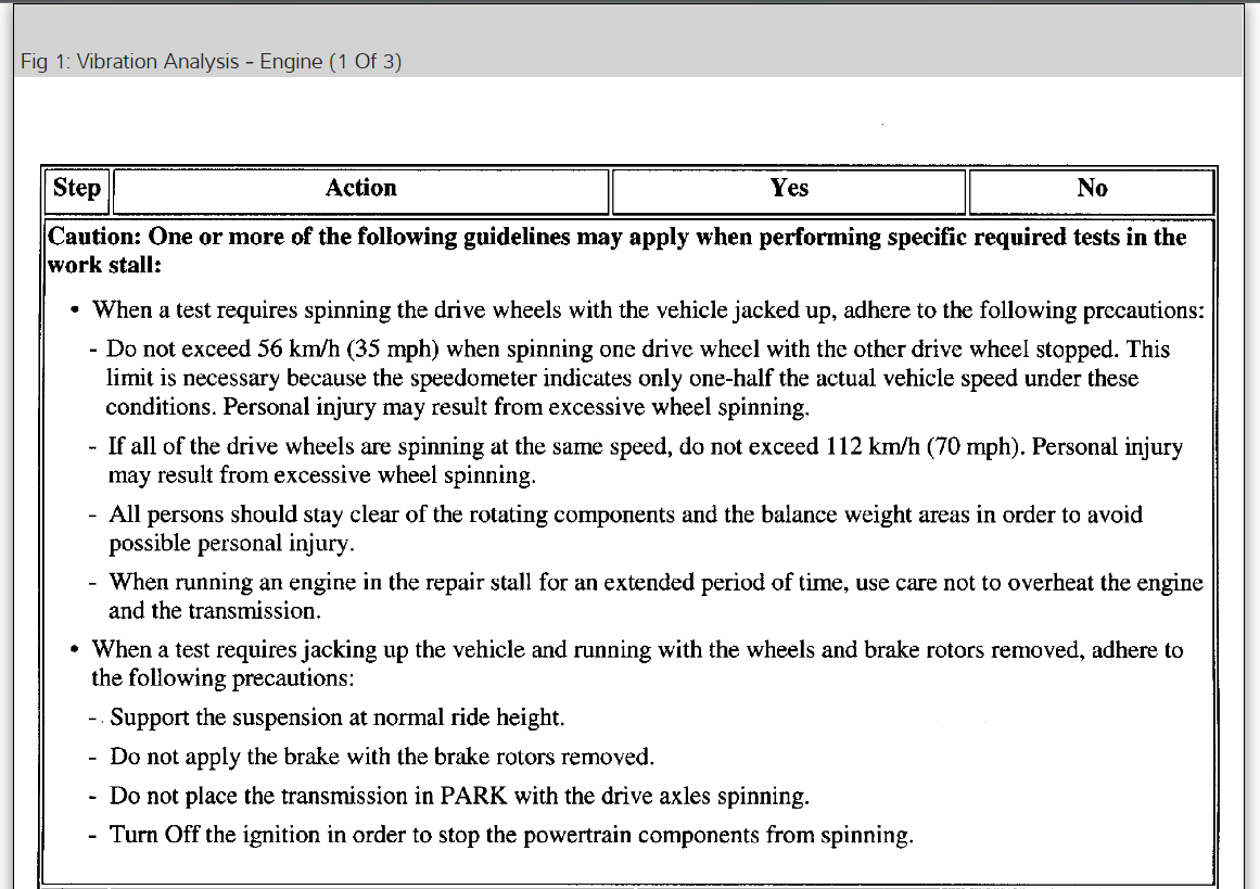

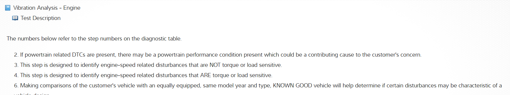

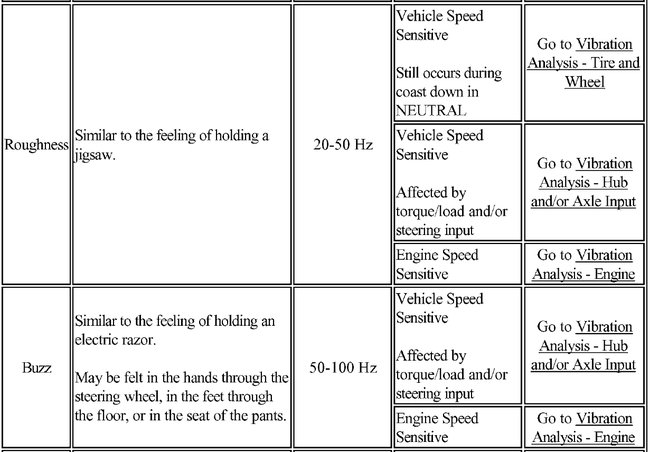

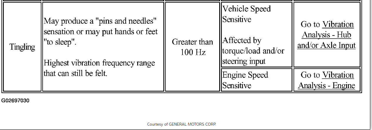

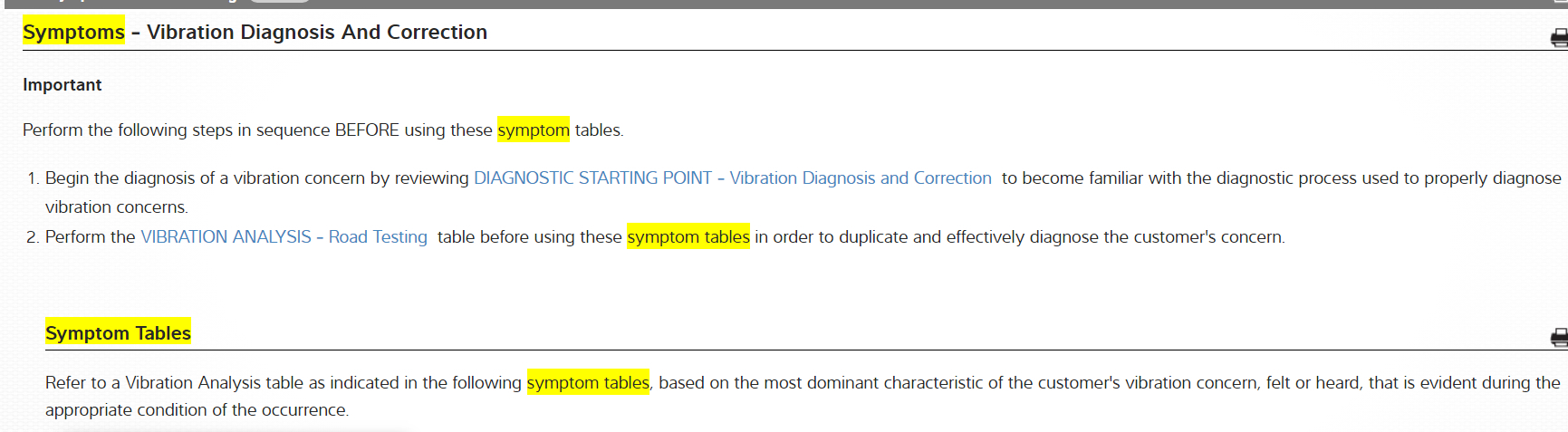

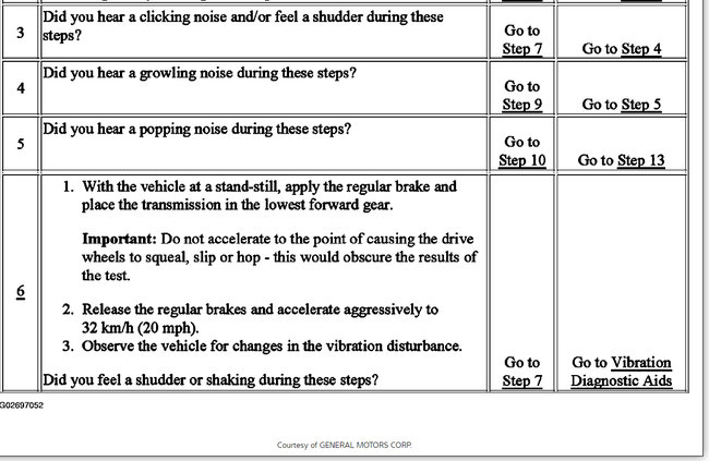

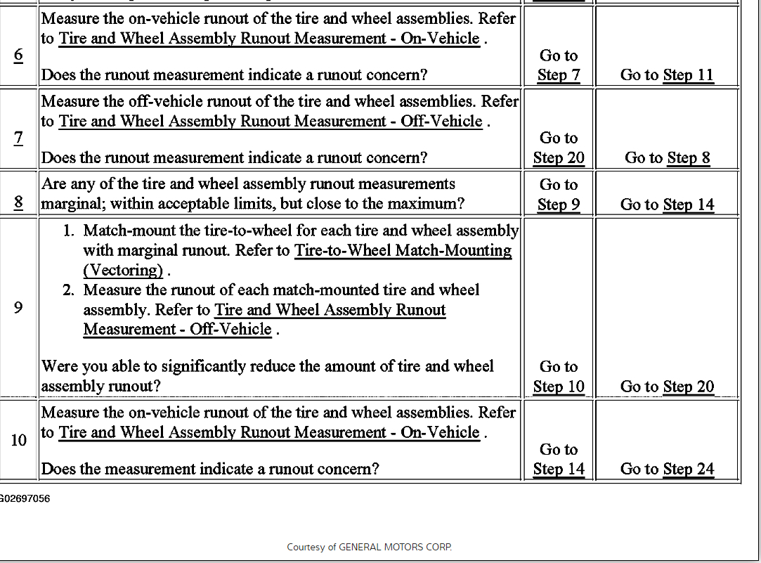

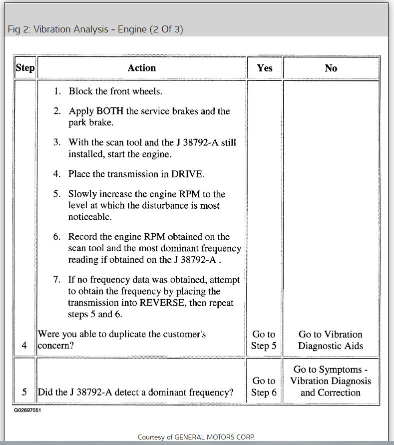

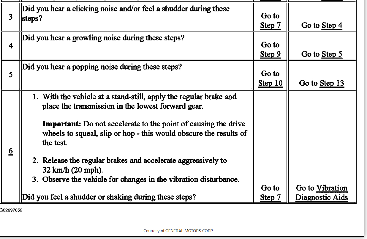

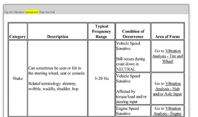

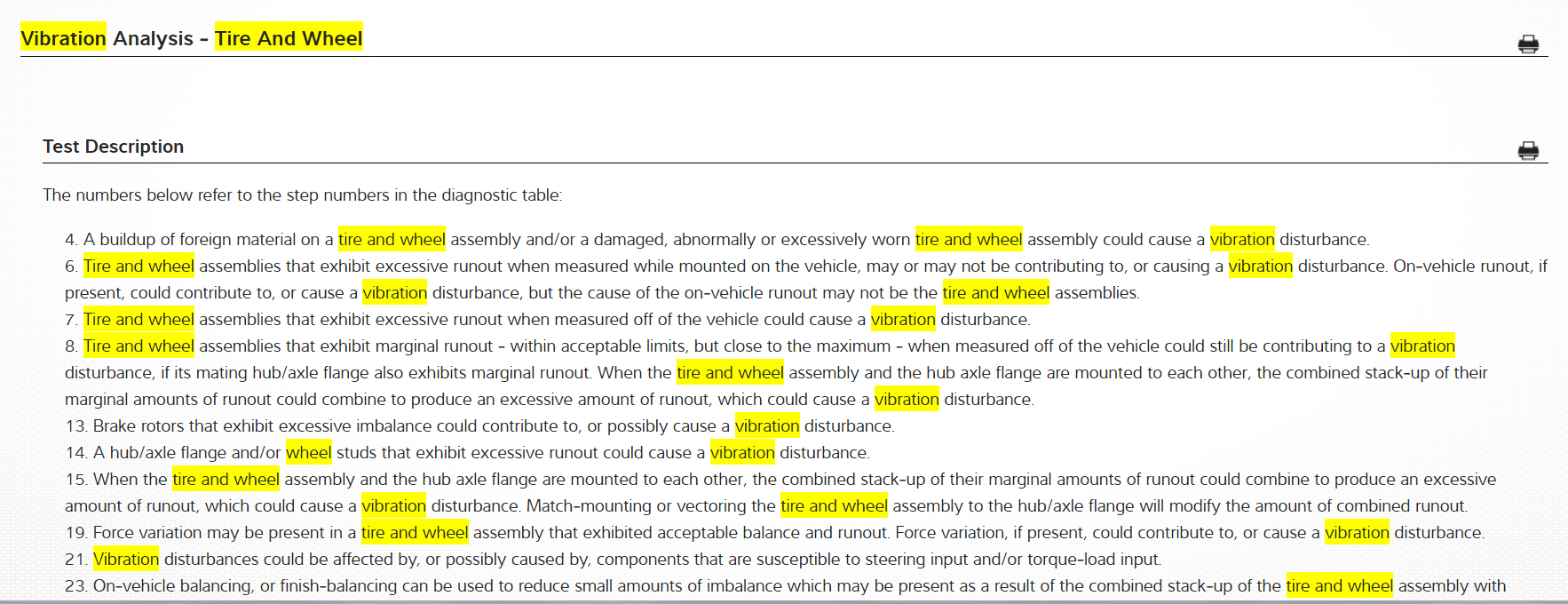

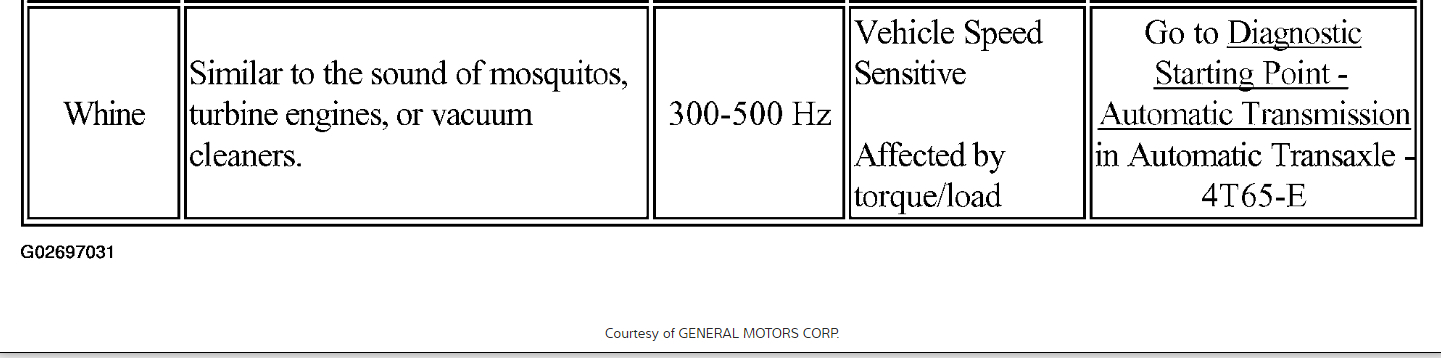

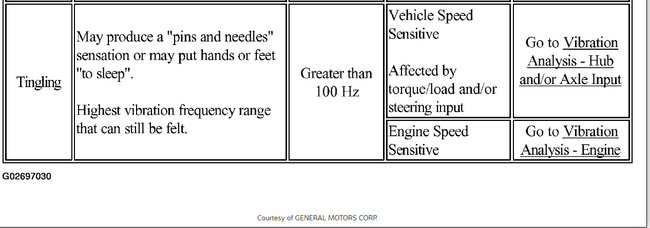

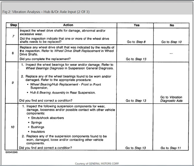

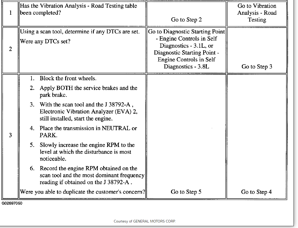

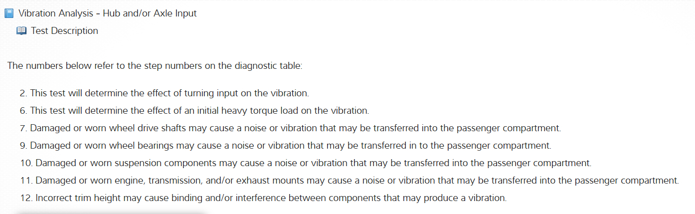

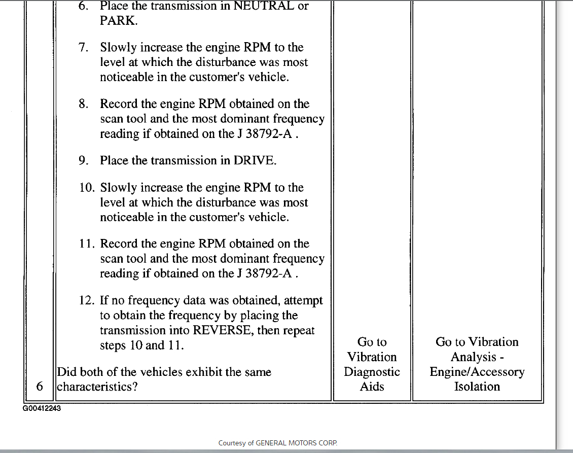

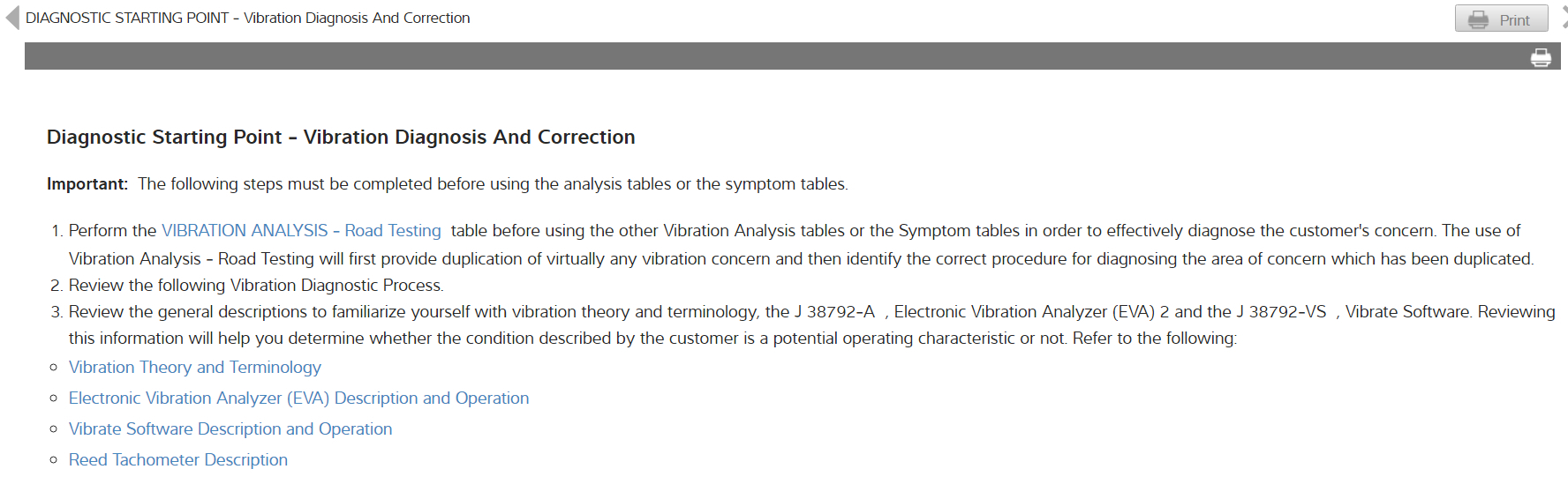

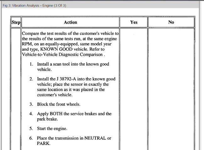

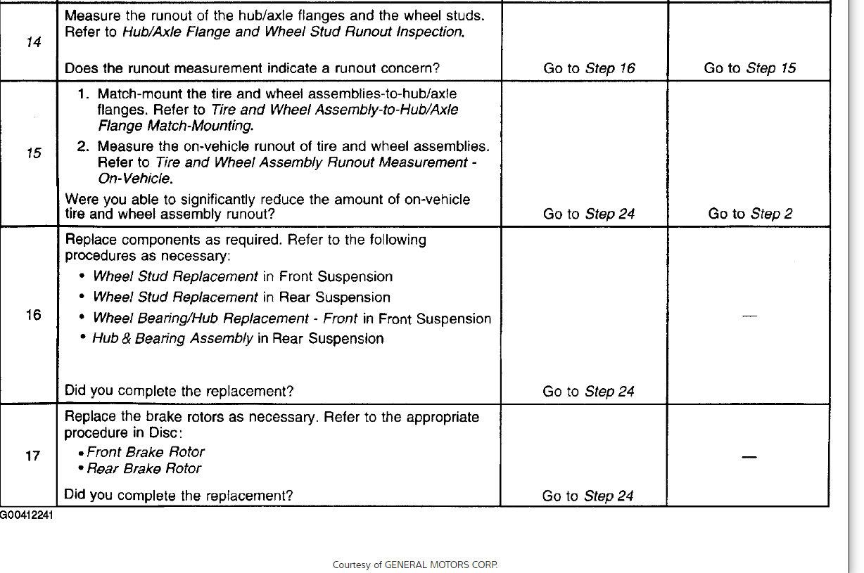

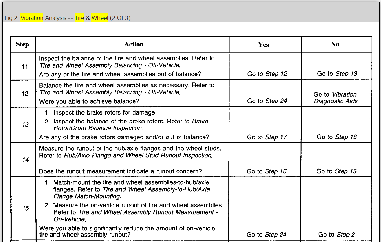

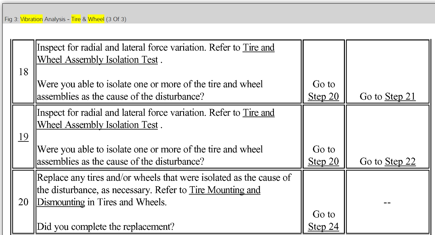

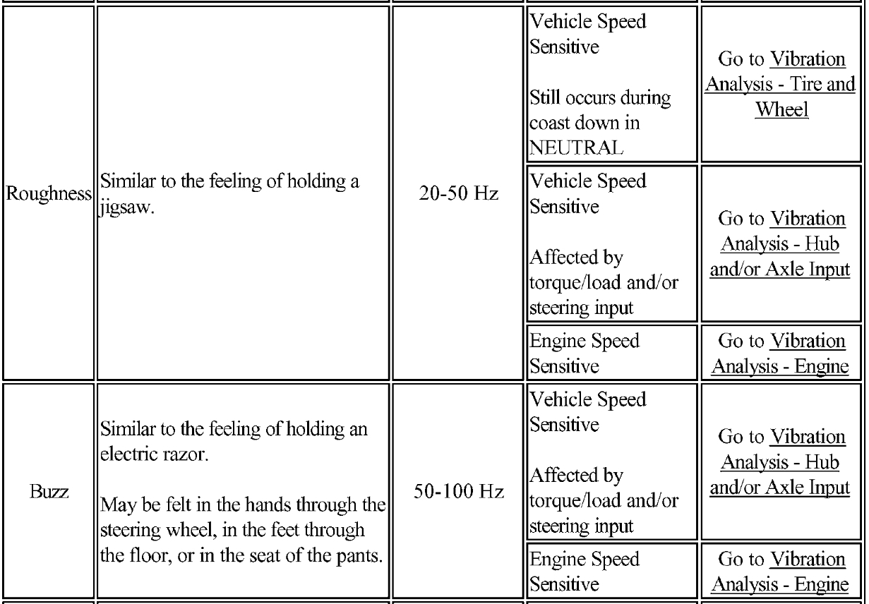

This sounds to me like it could be a problem with the motor mounts. But to be sure I have included a comprehensive vibration troubleshooting guide for you in the diagrams down below. Please go through it and let us know what you find out.

That's what my cousin said it was. so ill have to check the motor mounts.
