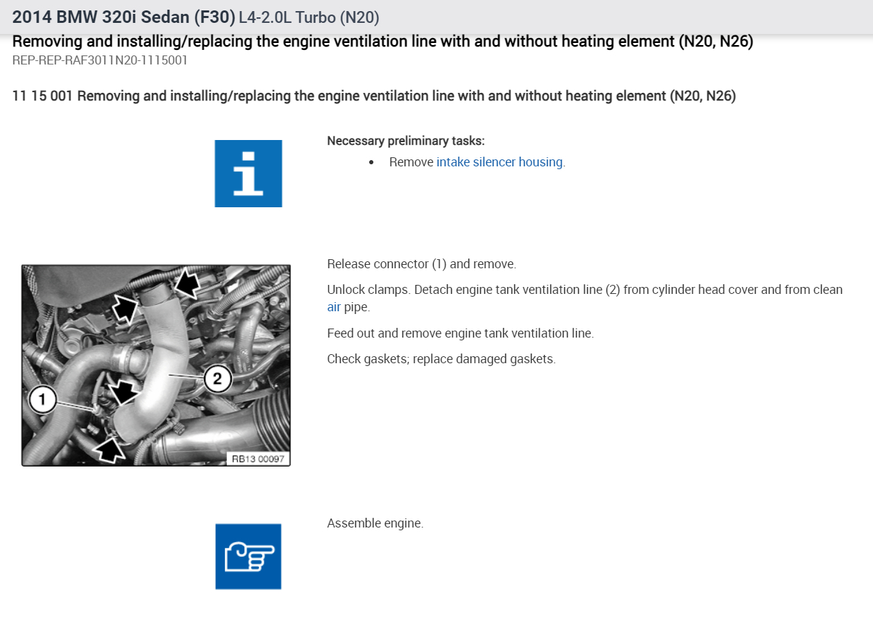

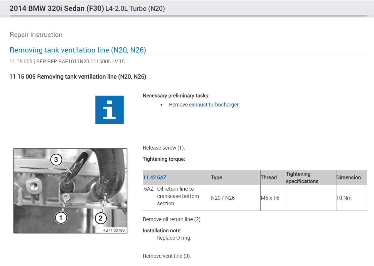

Thanks for the video, it helps, it sounds like a vacuum leak or the PCV system has a leak, I would use this guide when the engine is cold only to see if you get a reaction from the spray, this will tell you where the problem is.

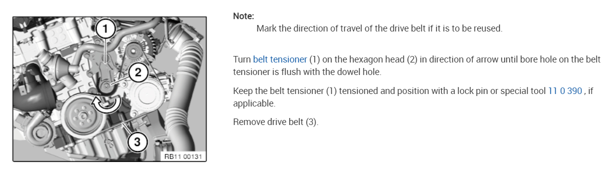

Here are some areas to check. Check out the images (below). Please let us know what happens. If you can find a leak, please remove the serpentine belt and start the engine for a few seconds to see if the noise is gone. Let me know what you find.

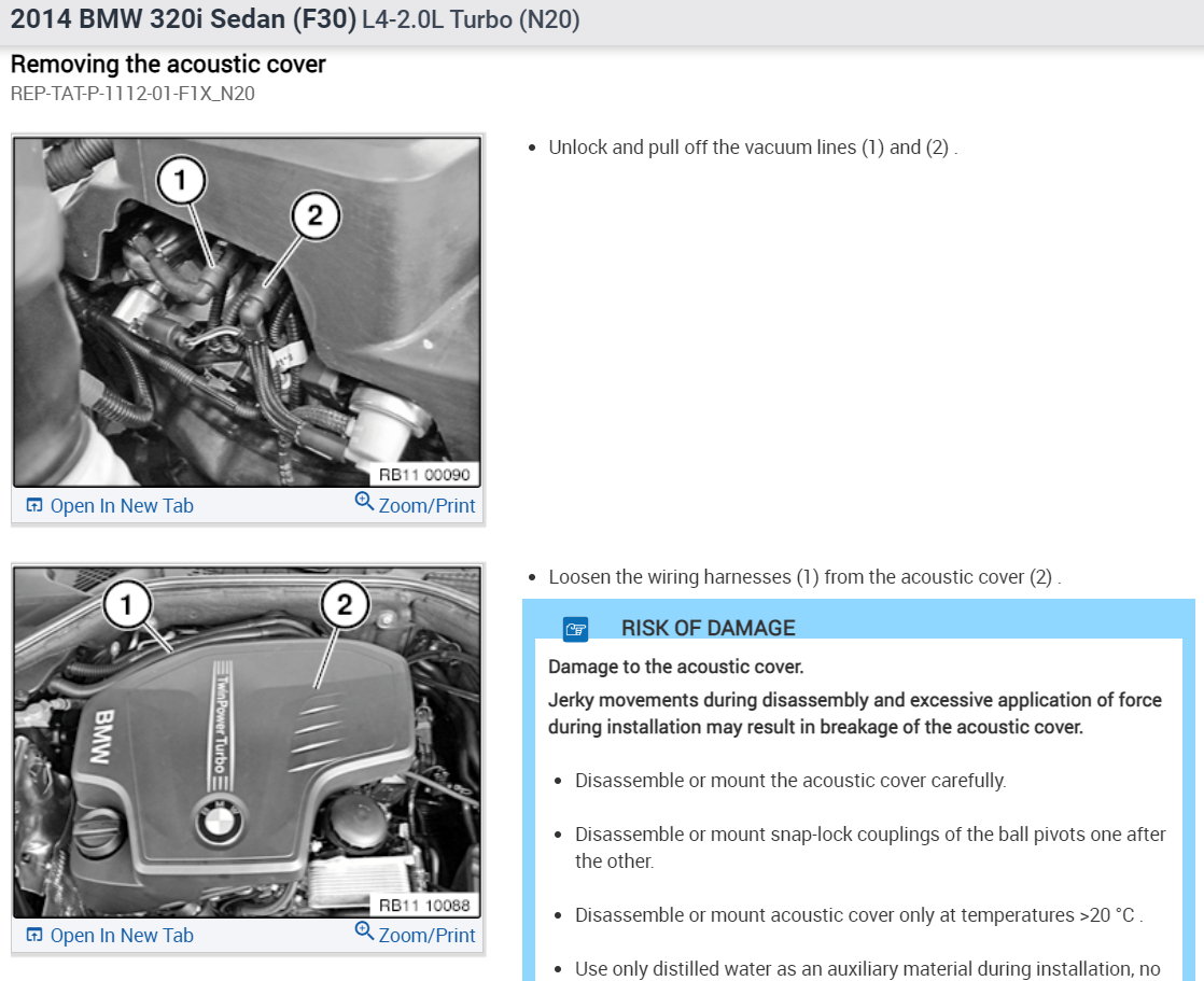

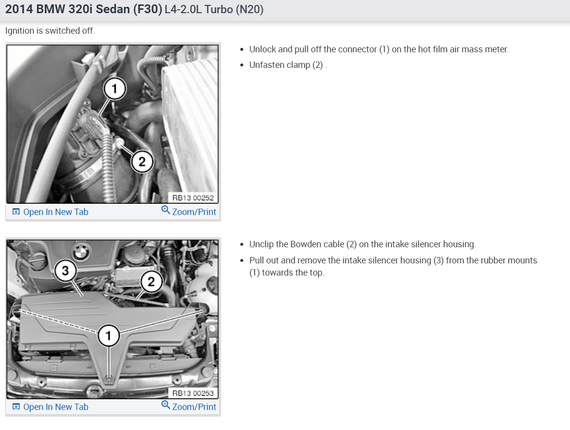

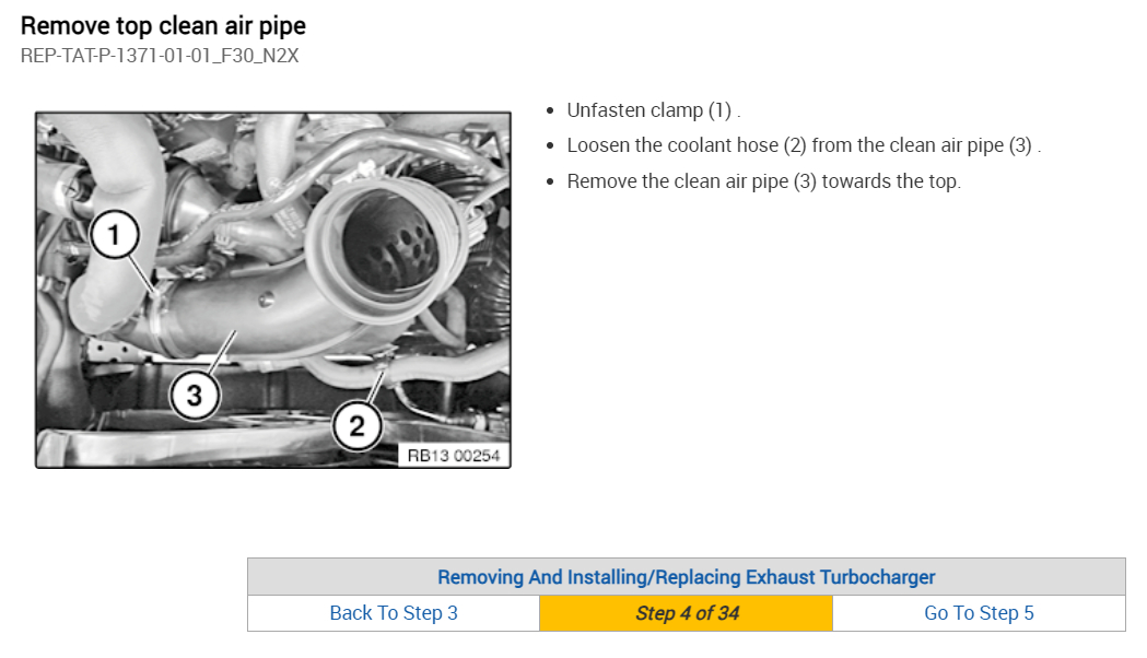

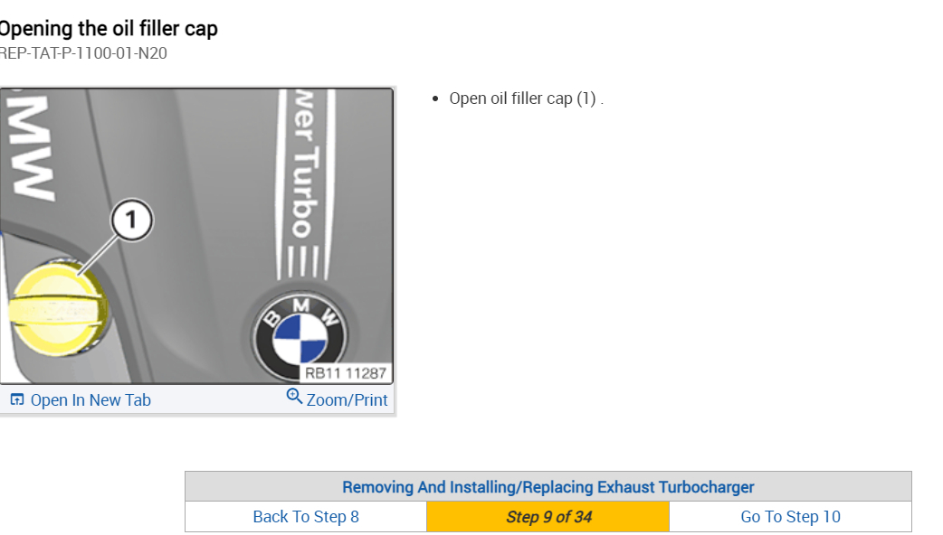

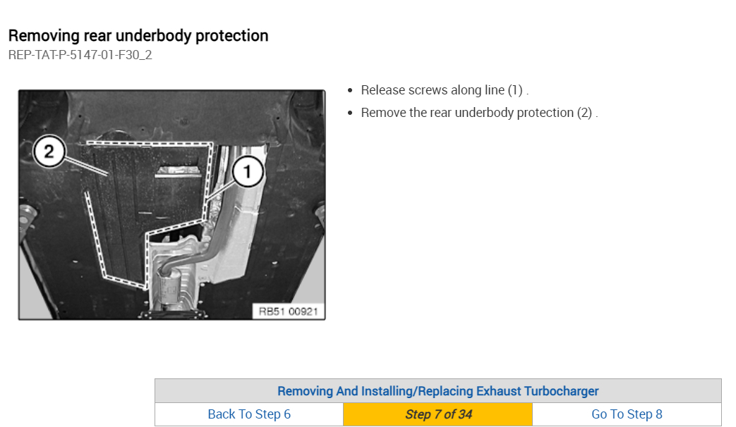

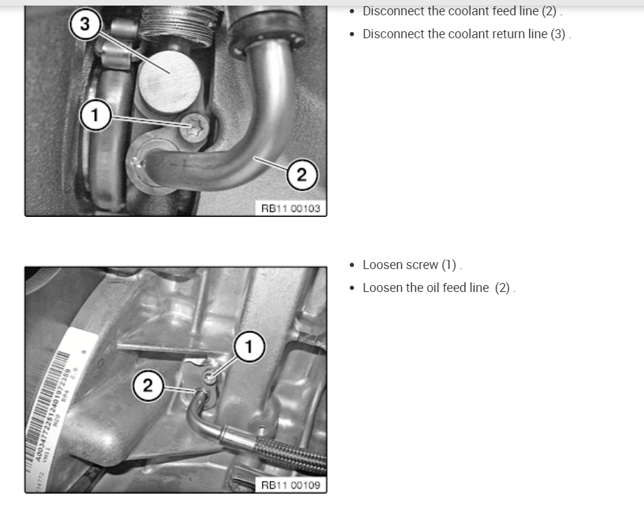

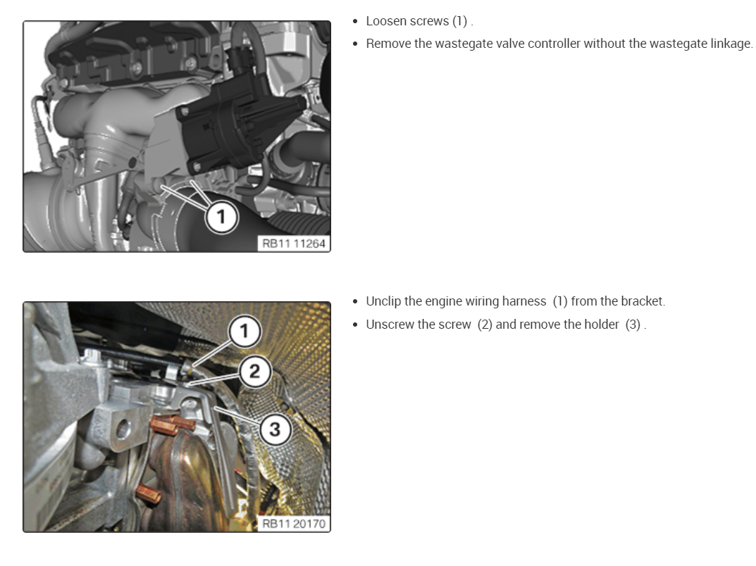

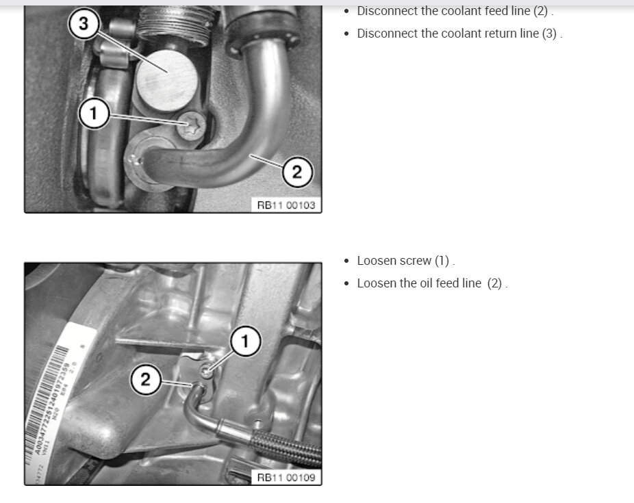

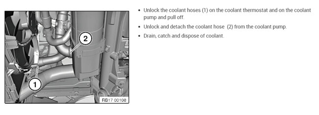

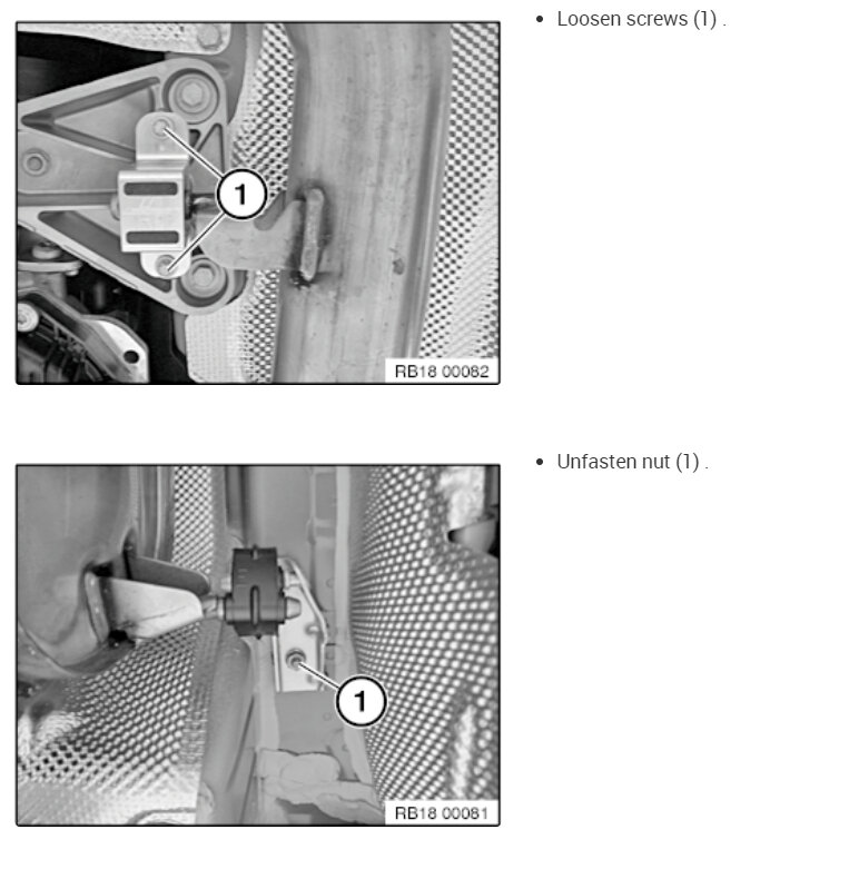

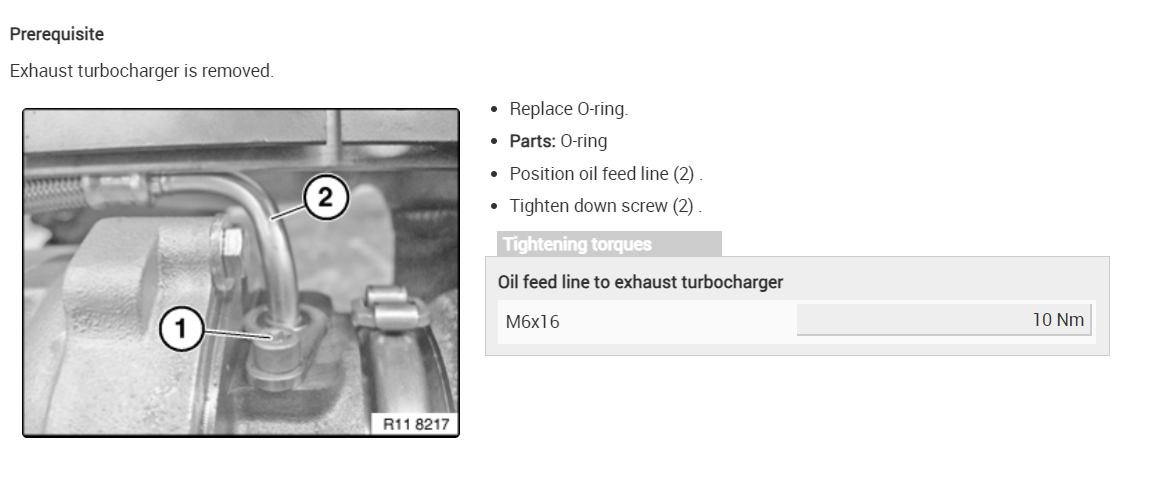

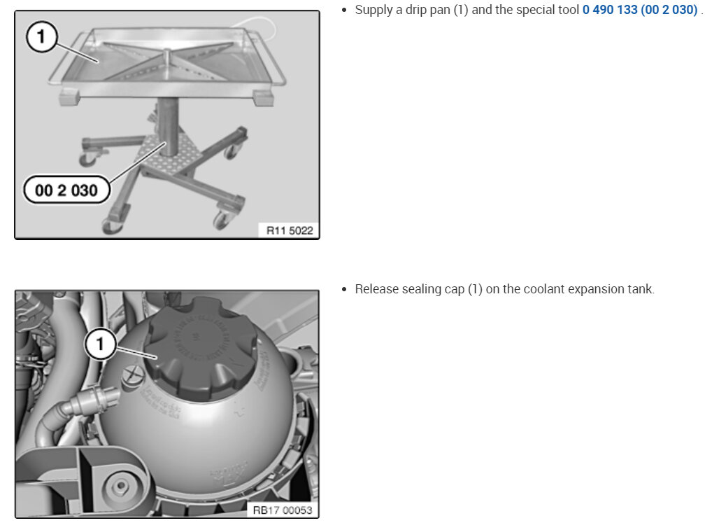

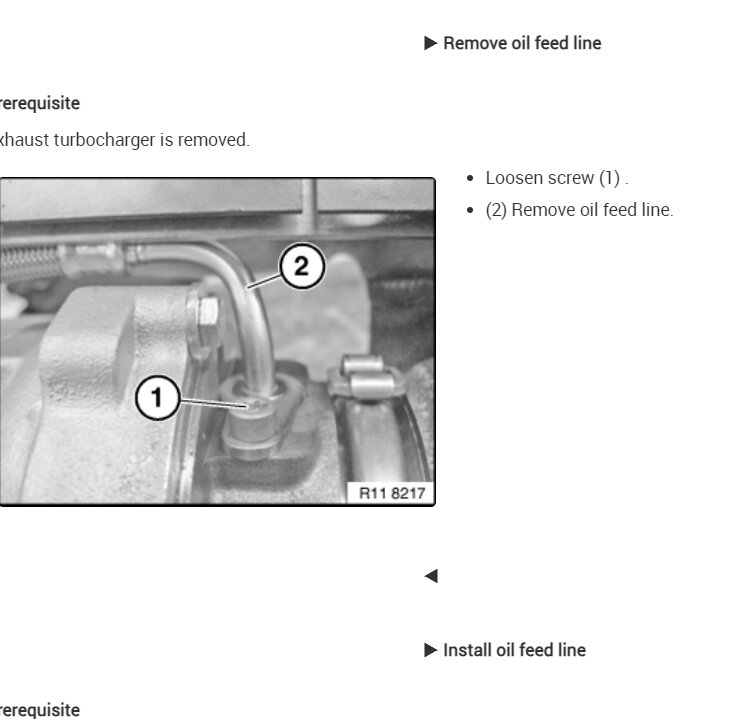

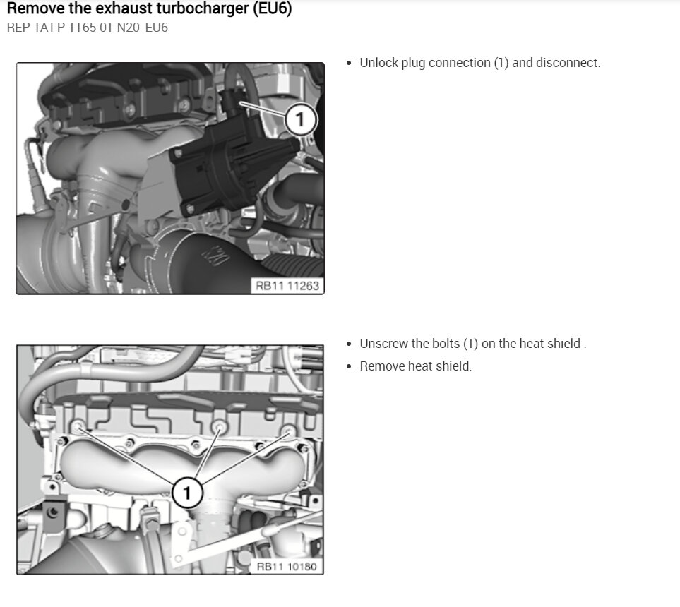

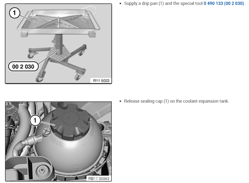

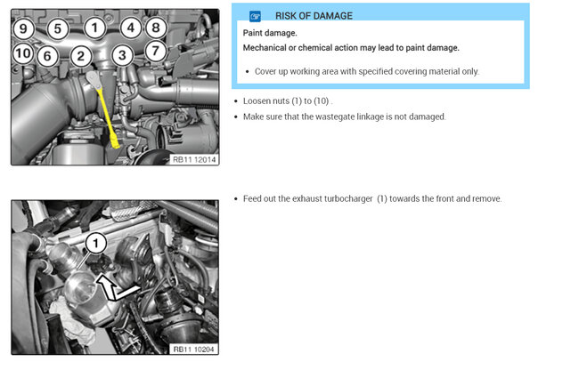

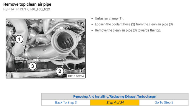

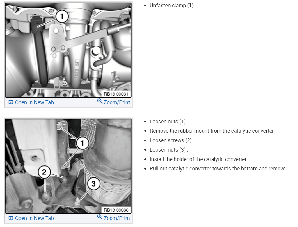

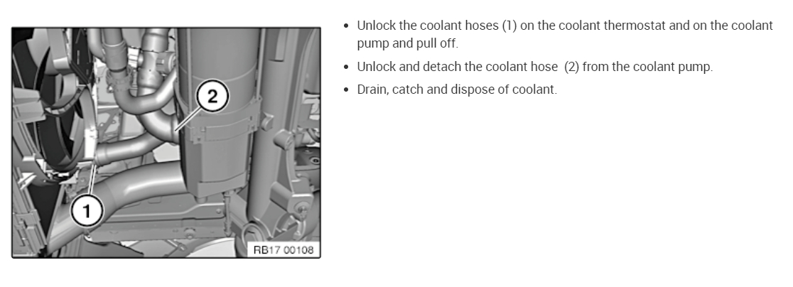

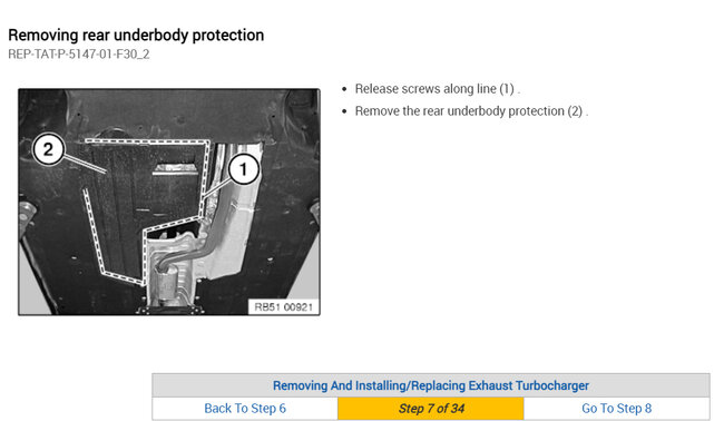

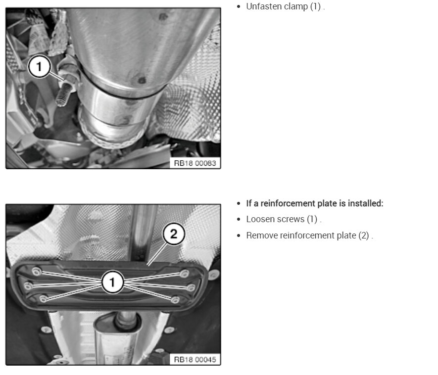

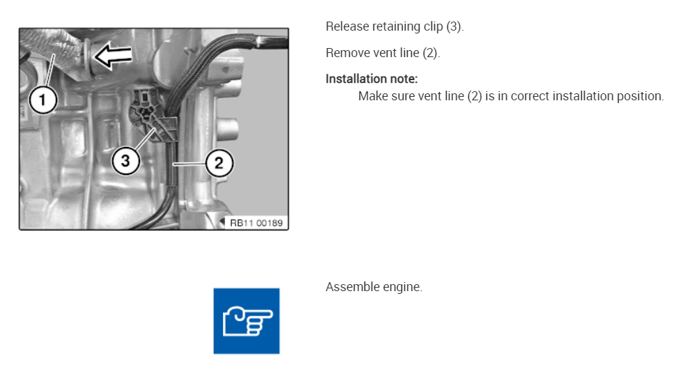

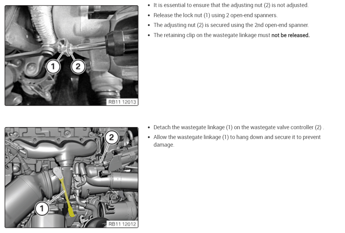

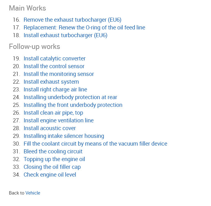

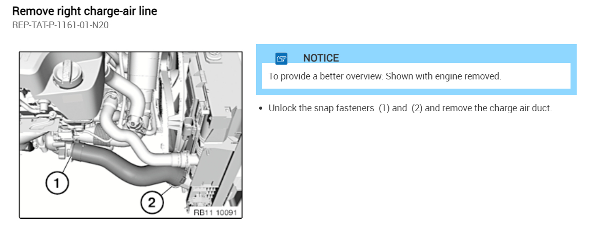

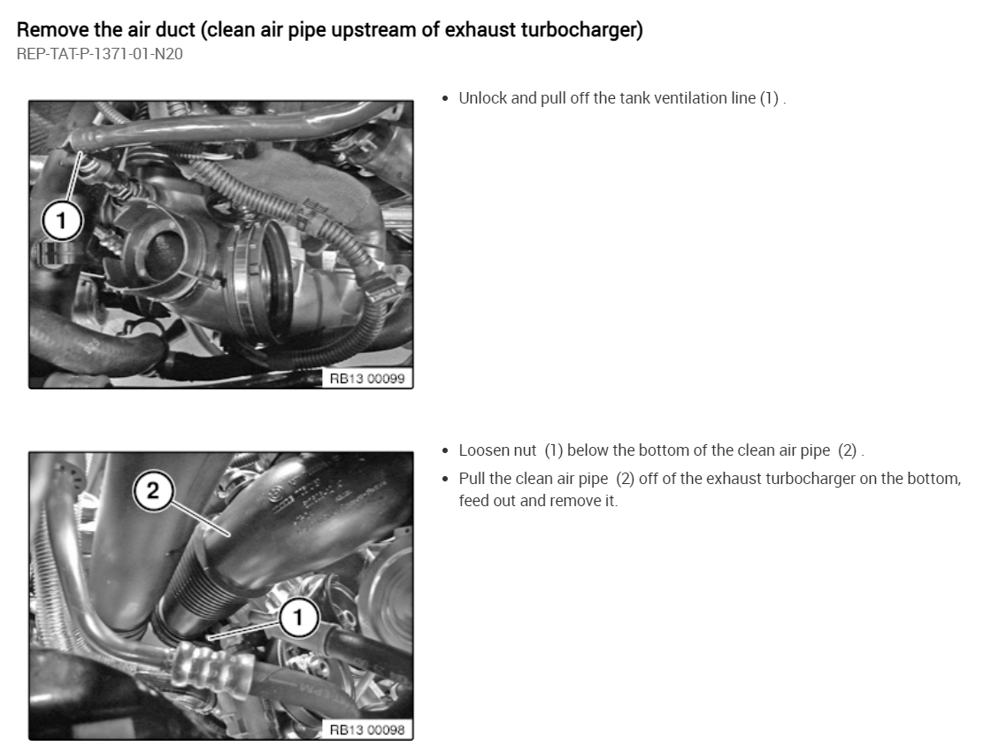

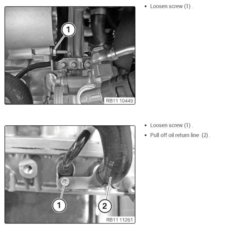

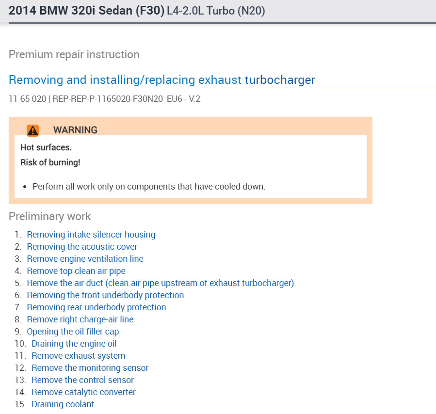

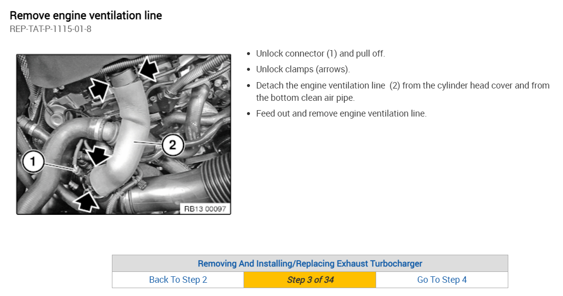

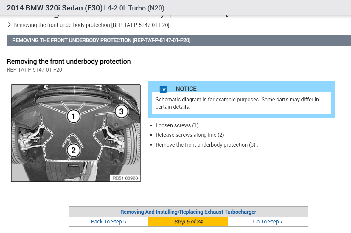

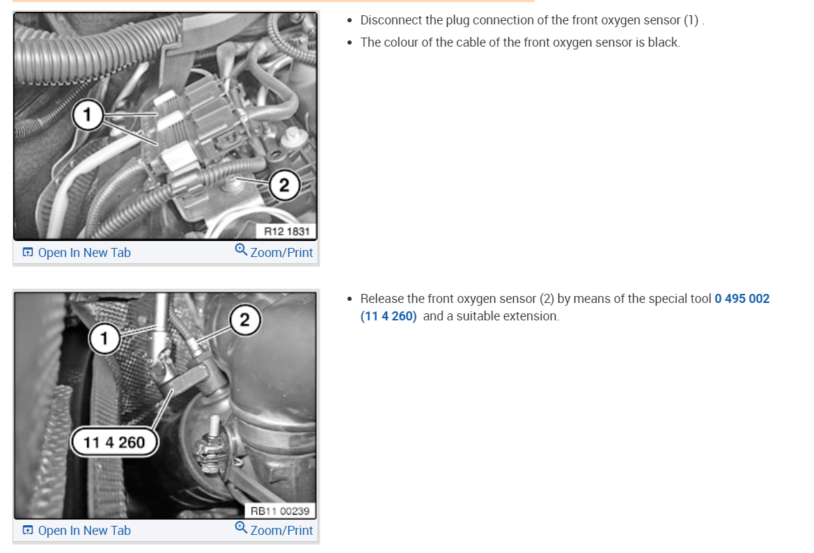

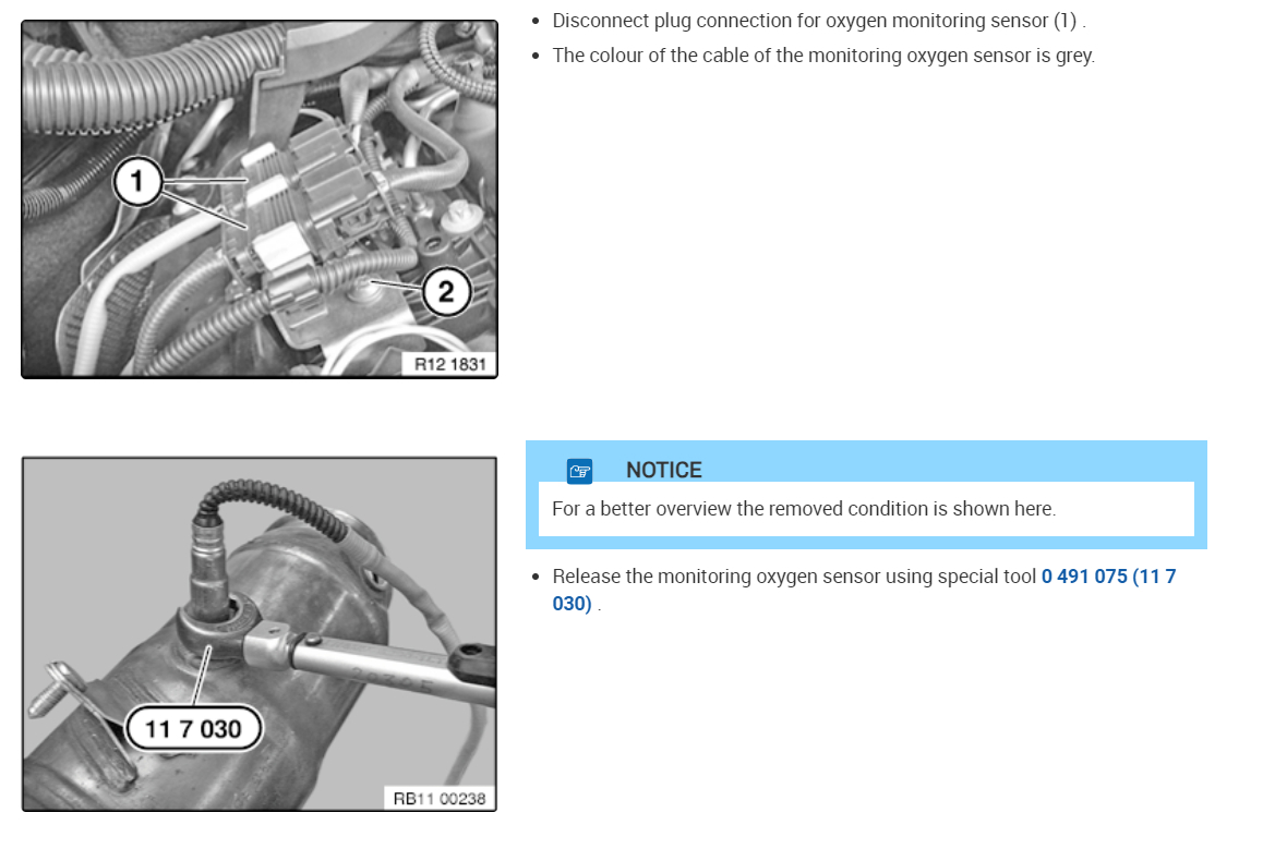

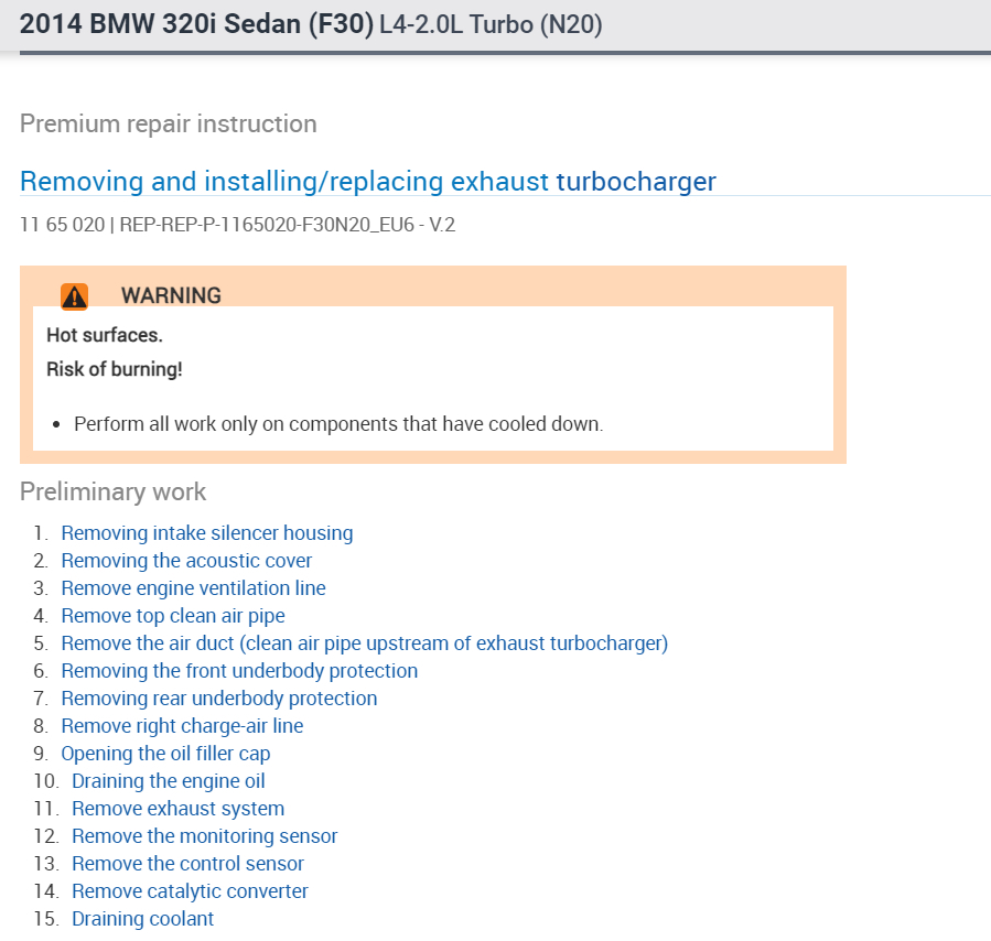

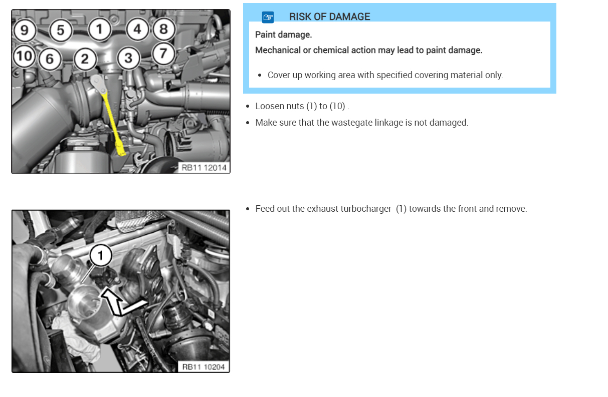

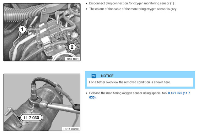

Is the noise coming from the turbos? I have seen them go bad and create a whining noise. If the turbos are bad here is how to change them out. Check out the images (below). Please let us know how it goes.
