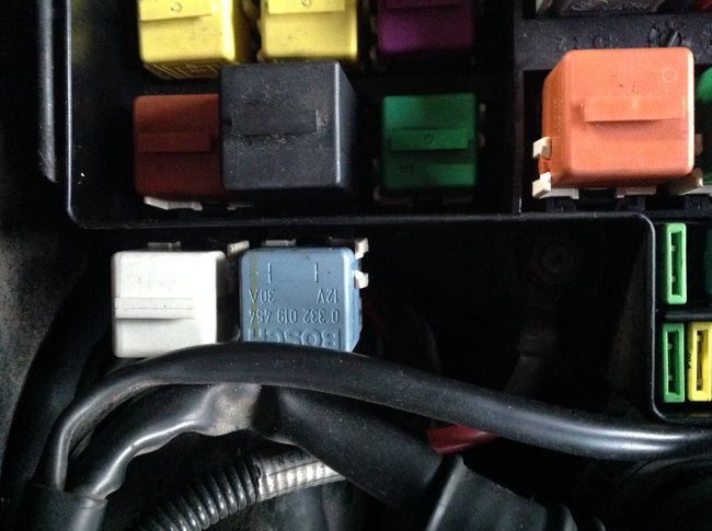

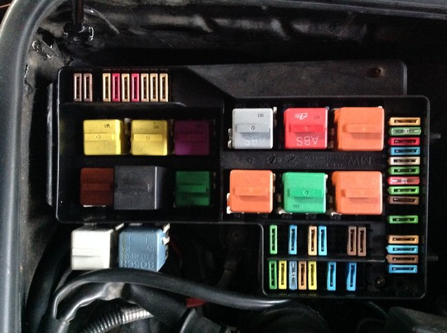

I made an error in locating the fuel pump relay. In my Bentley manual it showed the relay being one of three on the outside of the fuse box. My car only has two. Which is what confused me, so I took out one of the relays inside the fuse box - top row, third from the right. Obviously not the fuel pump. Now I have to figure out where it is. Images uploaded to show what I am dealing with.
I don't know why, but your system rotates the images 180 degrees when posting. I even tried rotating them 180 before posting to see of your system rotated them back. But for some reason they don't. So the pictures are 180 degrees turned to what they should be. And the system doesn't delete the images properly! There are two sets here.

The fuse in the wire (jumper cable) blew. And I had jumped the pins 30 and 85 in the headlight relay!
Jun 4, 2020 at 9:18 PM
Okay, I don't have the specific schematic to identify the pins you mentioned. I wish I had the schematic. Have you determined which one is the fuel pump?
