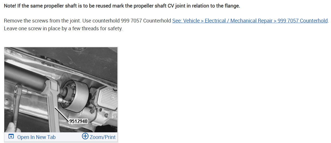

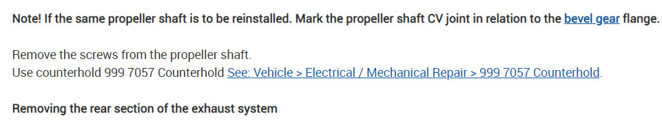

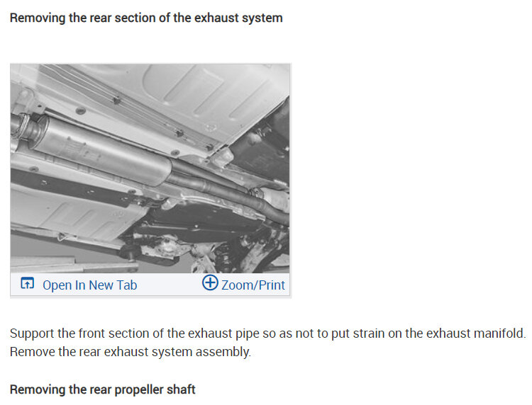

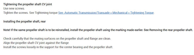

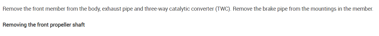

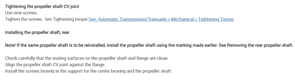

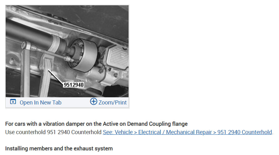

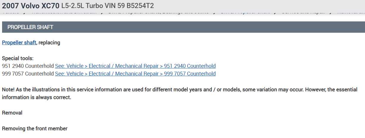

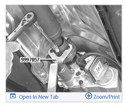

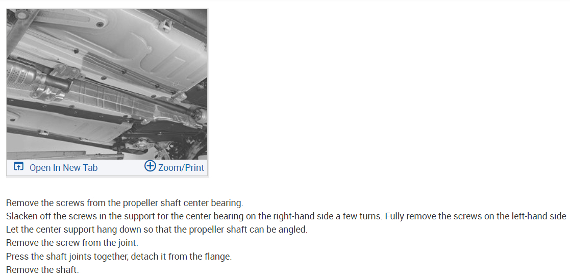

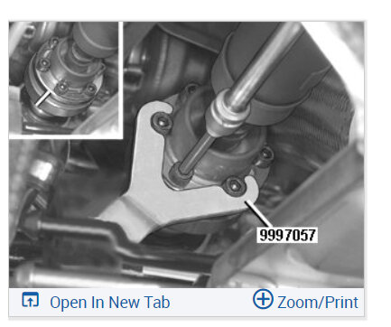

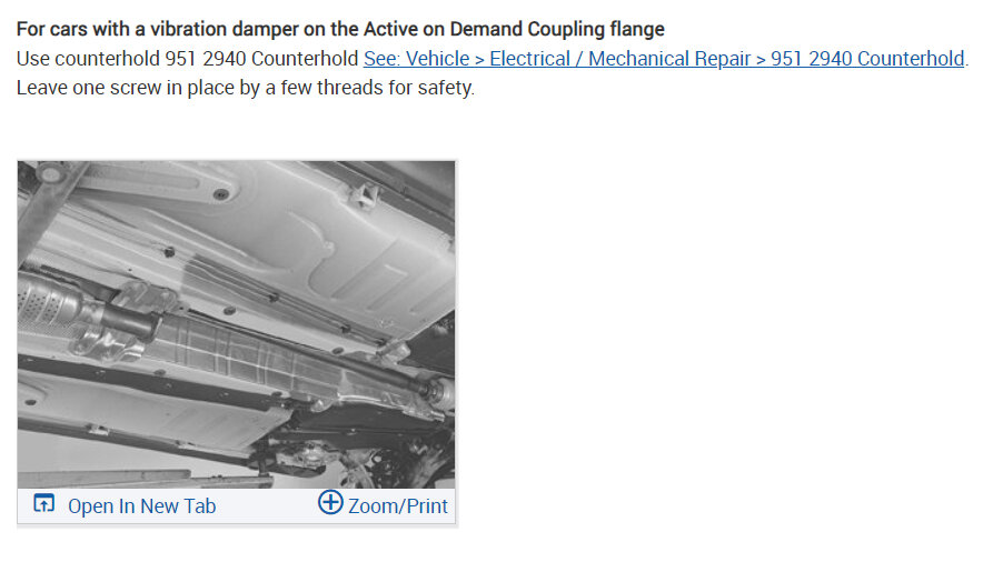

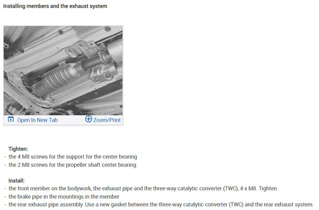

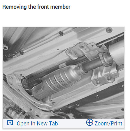

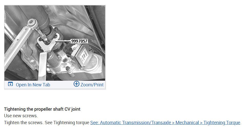

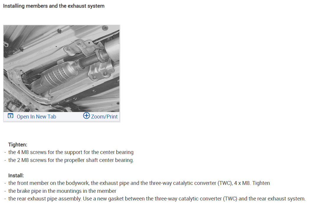

If I can help out here, to me it sounds like the drive shaft CV's and center support is worn out. I would remove the driveshaft for inspection. Here are the instructions on how to do so.
Check out the images (below). Please upload pictures or videos of the problem so we can see what's going on.

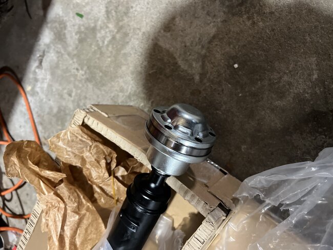

When I bought the driveshaft, it came new as a unit with brand new CV joints and a new center support bearing.

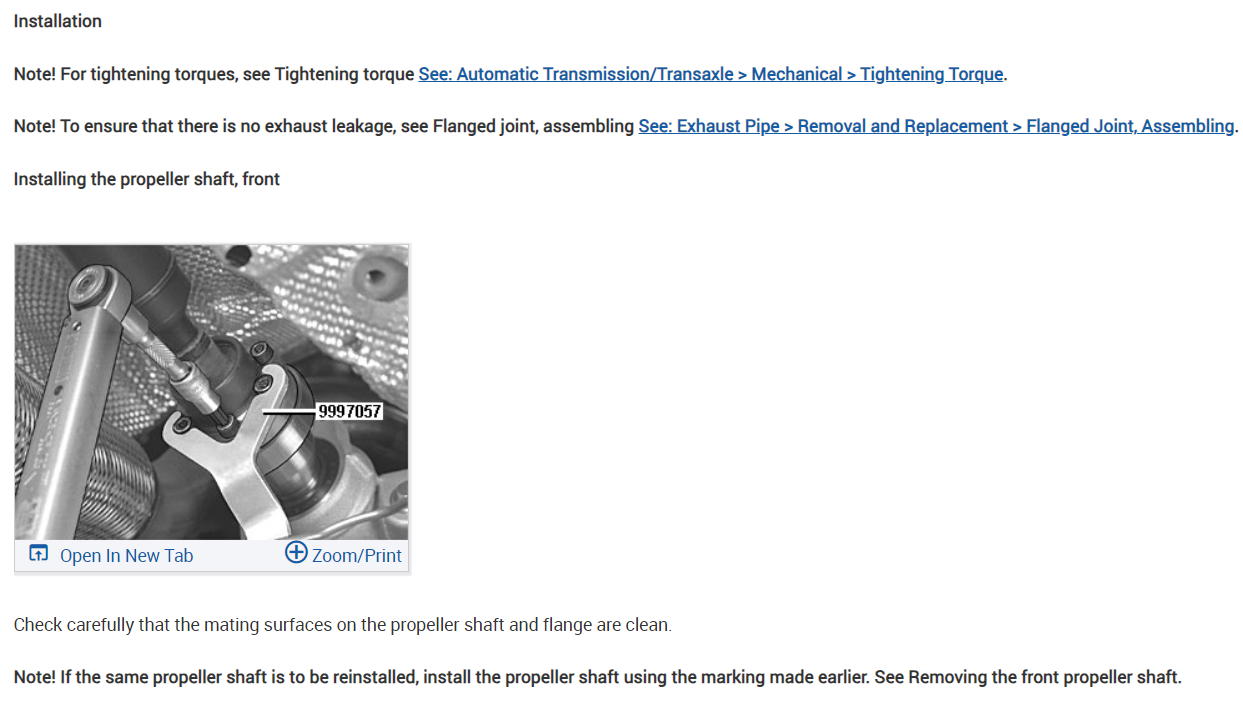

SETHR89S
  • 6 POSTS
I know this shows the other end of the driveshaft, but the new driveshaft was brand new with all new flanges and support bearing and everything. I didn’t rebuild a driveshaft.
