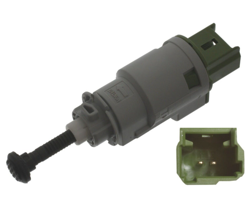

It sounds like your clutch position switch is not working. This switch tells the engine when the clutch pedal is depressed. Suggest that you check the switch at the clutch pedal, ensure that it is connected and that it is making contact with the clutch pedal. See image below.
Ensure that the switch engages the clutch pedal fully when pedal is up.

I checked out the clutch pedal switch and that is not the problem. Can it perhaps be rev hang? or a throttle position sensor? Would it work if I removed the battery terminal to reset the ECU or will that only cause more problems?
