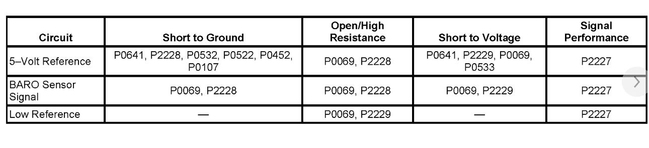

my car keeps popping up an ambient pressure sensor code. I have replaced the BAP sensor and the MAP sensor but the code P2229 hasn't gone away. Not sure what to do next or how to fix the problem.

This code is for the Baro sensor but indicates a wiring issue more than a component issue. I posted the flow chart below for you to view and follow.

Circuit/System Verification
Important: If DTC P0641 or P0651 are set, diagnose those DTCs first. Refer to Diagnostic Trouble Code (DTC) List - Vehicle. See: Vehicle > Initial Inspection and Diagnostic Overview
1. Ignition ON, observe the BARO parameter with a scan tool.
2. Compare the BARO value to the range specified in the altitude vs. barometric pressure table.
^ The BARO parameter should be within the range specified in the altitude vs. barometric pressure table. Refer to Altitude Versus Barometric Pressure.
Circuit/System Testing
1. Ignition OFF, disconnect the harness connector at the BARO sensor.
2. Ignition OFF, allow sufficient time for the control module to power down. Measure for less than 5 ohms of resistance between the low reference circuit of the connector and a good ground.
^ If greater than the specified range, test the low reference circuit for an open/high resistance. If the circuit tests normal, replace the ECM.
3. Ignition ON, test for 4.8-5.2 volts between the 5-volt reference circuit and ground.
^ If less than the specified range, test the 5-volt reference circuit for an open/high resistance or a short to ground. If the circuit tests normal, replace the ECM.
^ If greater than the specified range, test the 5-volt reference circuit for a short to voltage. If the circuit tests normal, replace the ECM.
4. Verify the scan tool BARO sensor voltage parameter is 0 kPa.
^ If greater than the specified range, tests the signal circuit for a short to voltage. If the circuit tests normal, replace the ECM.
5. Install a 3-amp fused jumper wire between the signal circuit and the 5-volt reference circuit. Verify the scan tool BARO sensor parameter is greater than 126 kPa.
^ If less than the specified range, test the sensor signal circuit for an open/high resistance or a short to ground.
6. If all circuits test normal, test or replace the faulty sensor.
